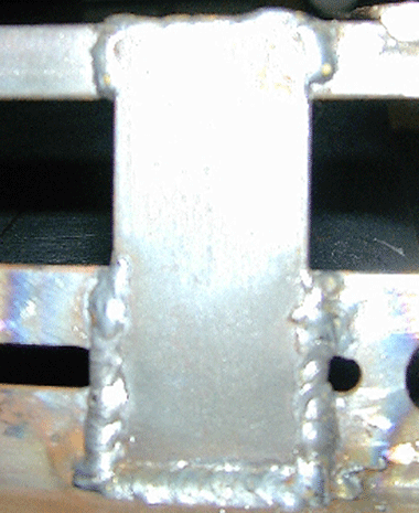

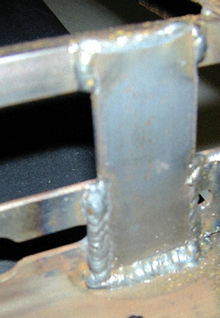

Here are a few of my welds on this gray water tank holder. This first one, is one of my first welds, not real pretty. Not so great, but Tom, here you can see the difference in the spatter using Argon mix instead of the flux core.

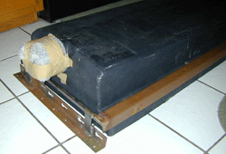

Here is the whole thing on the tank...my best welds I am trying to get resized so I can upload them, and having a bugger of a time in photoshop /forums/images/graemlins/mad.gif trying to figure out how to lower the file size...but will post my best looking weld pics when I get them resized.
   / Give me your welding experiences
#117
is that with a arc or mig?
i was told that the look of the weld dont matter much its if its penetrated through that matters /forums/images/graemlins/grin.gif
may i ask what the tank is for - looks interesting
   / Give me your welding experiences #120
Mith,
That is with my Lincoln 135 Mig, with gas.
It is a holding tank for waste water under an RV. The old one had a 1 inch lip around the edge so you could just screw through the lip into the plywood bottom of the RV to hold the tank up. As you can see, this one didn't, but it did have that 3 inch inset so I came up with this bracket/frame to allow me to mount it via screws in the end brackets.
