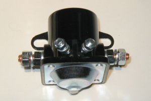

Must be a really heavy duty momentary contact switch to handle 30 amps . If going this route the Ford ones for the Thermo -start style will probably work as well as anything. or a light duty momentary and a riding mower starter relay would work well ...

Given the nature of momentary contact switches, I'd strongly recommend using a realy to switch the load so the momentary contact switch is only having to handle a couple amps at most. You can get a standard 12v, 30amp relay for about ten bucks at most car parts places - just ask for a horn relay. That's certainly the way I'd deal with the glow plugs if I needed them. which I never have.

The two relays I mentioned were the simple and age-old Ford type.
Fifteen bucks ($14.90) on eBay, delivered. If you don't need the second switch post, single post models are available as well.
