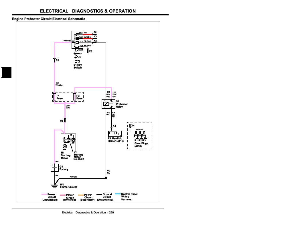

I do not have time to check mine right now...but read the attached (I hope) from the FSM:

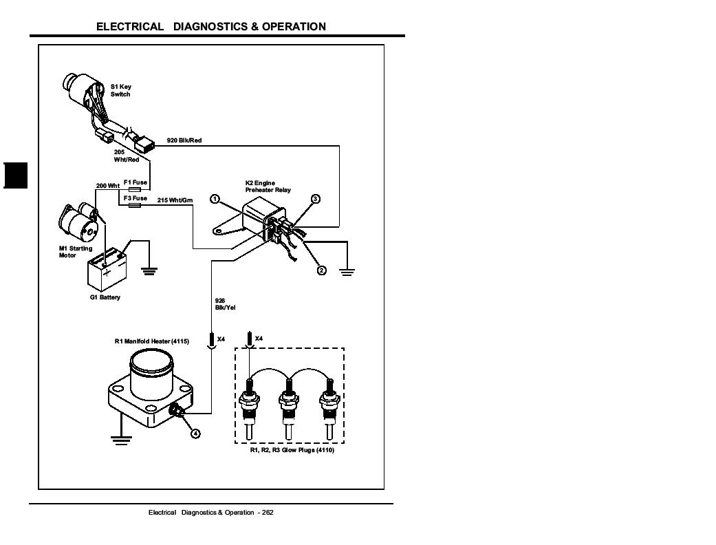

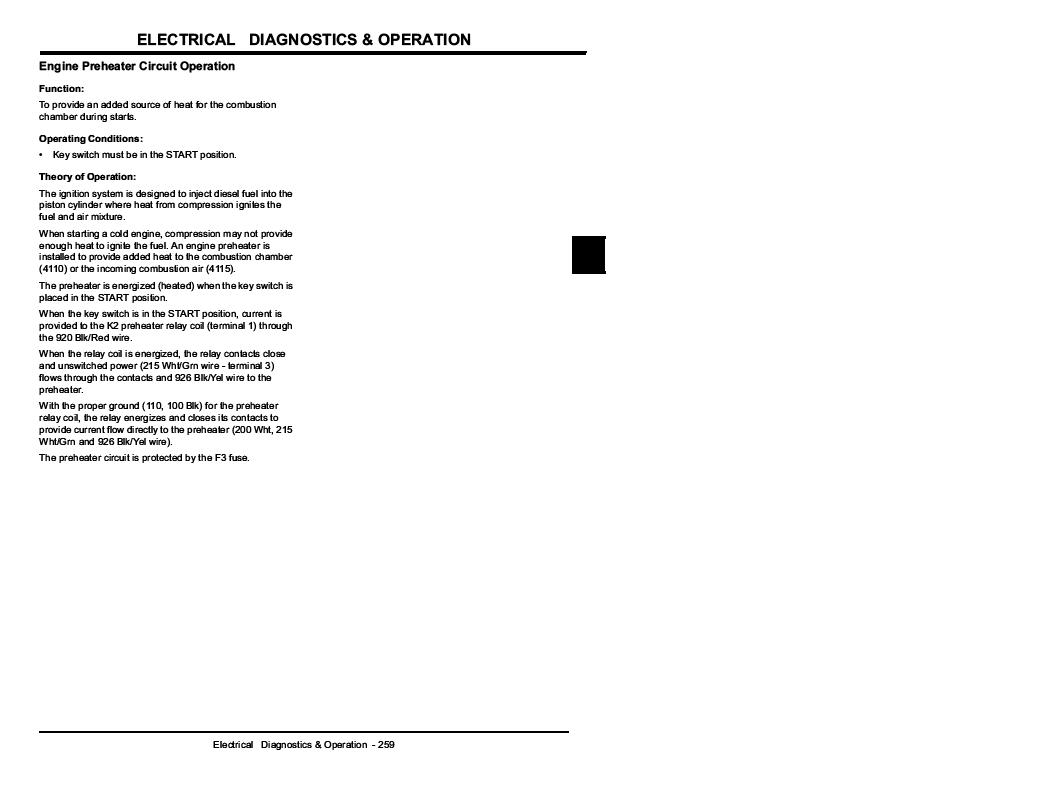

   / Glow plugs on 4110 #14
Two more pages:

The glow plugs do nothing in the on position. It has to be turned to start and held. I have listened intently and there is no relay click. This is strictly a manual operation. I'm going to check with Deere to see if they have any additional information.
By the way.... 4-6 seconds on glow will allow the engine to start smokeless in the first turn. At least I know they work. The parts cat. confirmed there are 3 glow plugs.... not a heat chamber as I was once informed.
