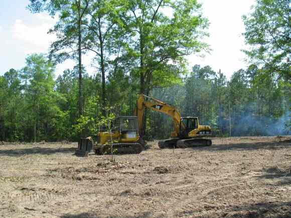

And heres one after some work with the root rake.
I still need to disc it for some of the roots and vines still need to be chopped up.

Thanks Highbeam and Stu, can you point me to an appropriate disc that I could use behind the D5? I was thinking about using the tractor to clean up behind the dozer but if the dozer would do a better job.... Thanks for your help and nice pics, both.

The reason for using the dozer to pull the disc is that you can get a macho super heavy duty chopping disc that will actually break up and chop stumps, roots, and debris into submission. A typical tractor is not capable of pulling this size of a disc. Big like 6 or 8 foot diameter discs that take mucho traction and power to pull through. These disc implements aren't very wide, just tall and heavy. Contact the rental place.
Got to agree that after a dozer with rootrake does its job, there will be very little left to chop up.

His recommendation was to;
1) root rake the entire site with dozer
2) wait a few weeks
3) burn
4) disc harrow with a HD tractor
5) then go over it with my tractor and clean up the bits
6) either harrow again, lighter disc
7) harley rake, till, or pulverizer
8) plant grass seed
We close next week and hopefully we can get started in a week or 2. I'll post pics!

So far we have cleared approx 40 acres. We hired a contractor to clear about half of this. The other half we did ourselves with a Cat D5 and a root rake. We are doing the burn and all the cleanup. Hopefully we'll be ready to plant seed in a few weeks.
The root rake, for the dozer, we had to buy ourselves but has been well worth it. It makes a quick job of clearing and leaves a clean area. It has also been very helpful in our burn.
Our Cat dealer was so very kind enough to rent is a D5 with an air conditioned cab (this was a big surprise actually!). I cannot tell you how nice this has been! The D5 is a very easy to operate machine. None of us had ever operated a dozer before and within a few hours felt very comfortable and efficient.
The WR Long Root rake has been our best investment to date. We love it. It is lightweight and really opens wide. I think our tractor dealer will be selling more of these.....
