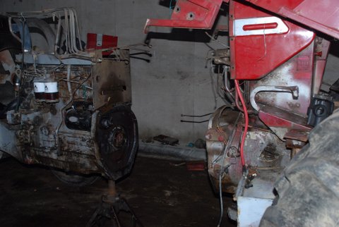

Brandi you are just to hard on equipment!!! :laughing::laughing: I know what ya mean about tackling yourself. That's what I was facing this spring with the Massey. I could have done it but it but due to my work schedule it would have taken a month or two to get it done. You are also right about not having done it before. You need to pay close attention to disassembly so you don't miss any of those little things that go flying. For me it was a no brainer. Mechanic came and split the tractor, we diagnosed the problem and ordered the parts. When they came in I gave hima a call and he came over and reassembled it. Only hard part for me was swallowing the bill. :eek::eek: But it was better than if I had it done at the dealer. Roving mechanic has lower overhead which is passed on to the customer in LOWER rates!!!:cool2::cool2:

Ed,
I was wondering if you was gonna chime in here. Can you sent that mechanic down here. I think, as I remember, your bill being around $1200. Is that about right?

Actually the parts bill was just over $1,000.00. The labor was $800.00 which was about 1/2 of what it would have been at the dealer. I think if you paid him travel to get there and back your dealer could double his rate and it would still be cheaper.
I had to split mine due to the PTO coupler failure. While we had it open I had him replace the clutch discs. Yes I have a dual disc clutch. Didn't do the pressure plate it checked out ok. That would have added another $300.00 in parts.

Ed,
What did Y'all use to support the front and rear halves as Y'all rolled it apart. Two floor jacks? Or did Y'all block up the front and roll the back away from it?

I wasn't there when he split it but ususlly you block up the rear and slide the front. Make sure you put wedges between the frame and the front axle so it can't piviot. What really works good on the front end is a roller stand. That way you don't have to transfer from jack to stand and back again.
