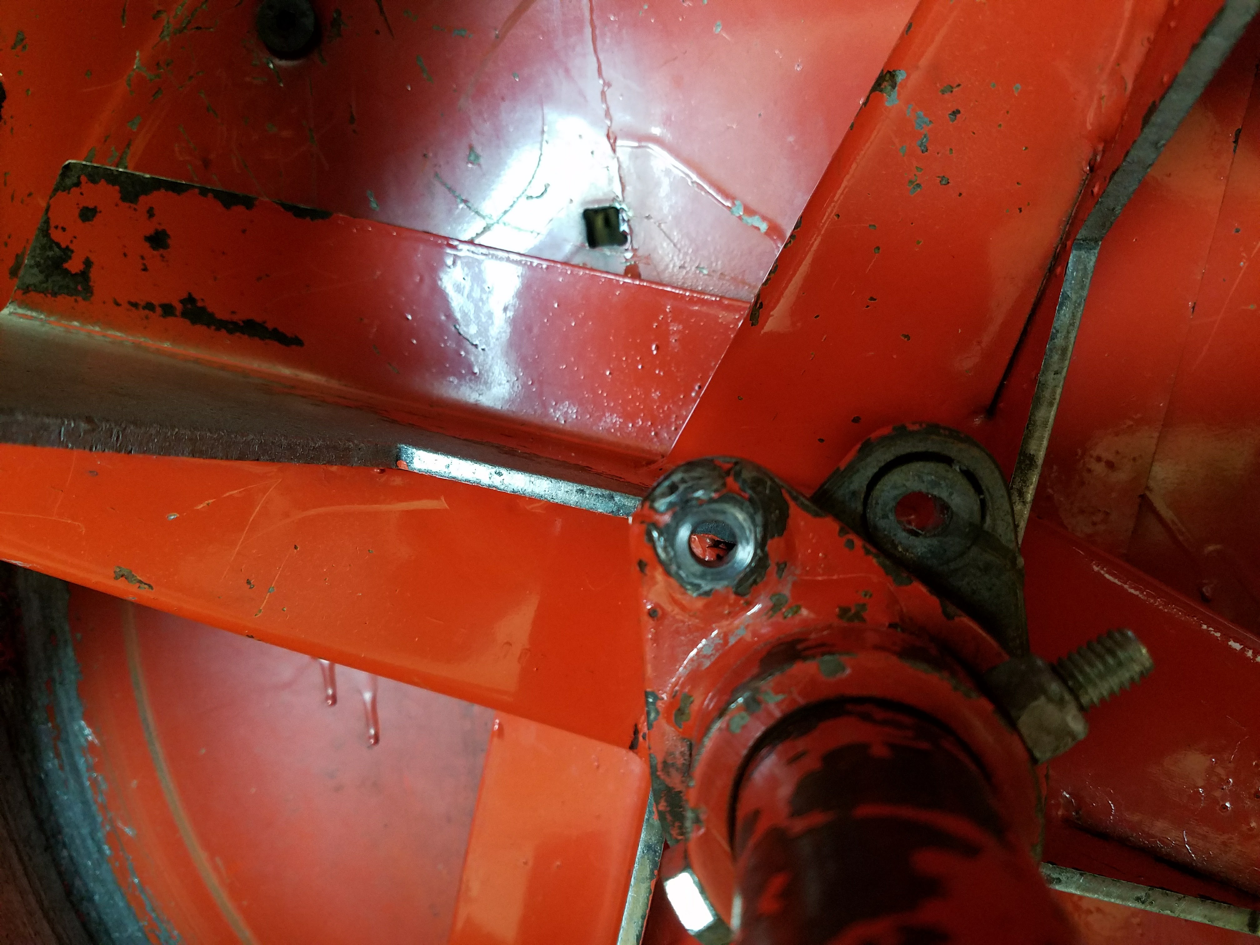

I am not having any shear bolt problems with my snowblower, but had them on the hay baler growing up on the farm. The very large pulley that drove the plunger had a shear bolt. It was to protect things if something solid got into the bale chamber and stopped the plunger (for those that had wire balers in the 60-70s, this happened when you baled the needles due to timing off on needles).
Two things sheared that bolt faster than you could imagine, one when I pushed too hard and overloaded input to bale chamber and the second when I sheared a few bolts, the hole got loose and then it was easier to shear and only got worse. If you have slop in bolt holes, you will start shearing bolts for no reason seemingly.
Looking at the fan enclosure, my guess is that gravel was the initial cause of shearing and now the sloppy hole is a contributor.
I suggest two things, first close up the clearance or open up the fan clearance. I am guessing the way it is right now is likely the exact wrong clearance and a single rock can get lodged briefly and pop the shear bolt.
The second thing is to take care of the hole, either by filling and drilling back to original size or drilling to next size.
We never had bolt threads in the shear area, find a different bolt that solves that. Another thought, if there is gravel behind the fan, it could be causing you ongoing issues and a piece or two comes loose...
Best wishes getting it resolved, I would not be happy at all if I was shearing bolts like that.. and final thought, it goes without saying that this is my opinion that I am sharing.

In resume, no threads in the sheer zone is essential. Threads are like a pre determined partial cut and therefor a weak spot sure to sheer .
You want only solid bolt body in that zone.
The higher the bolt grade the cleaner the sheer or cut will be.
The holes need to be sharp (think like scissors) to be effective.
In fact when I rebuild my sheer bolt flanges this summer I will heat treat to be sure I have clean sharp cutting action and intend to add bushings on the outer faces of the flanges which will allow me to keep alignment and use longer bolts with fewer threads exposed.
Presently the 2 flange faces are a mere 1/4" total and I have to use 1 1/4 bolts resulting in lots of thread and washers.
Worst is screwing down all the thread length bare fingered in -30 degs. Fingers get so numb that I can't feel the nut to thread it on.

Just to make sure we are talking about the same thing, are you suggesting that I weld up the hole a bit with mig or gas on each of the tabs and then redrill it to a tight fit on the 1/4" bolt? It is really starting to seem like that is the correct fix for the problem I am seeing, but I wanted to make sure I am understanding you. I just got some 1/4" bolts today that have a longer shank (before the threads start), but I still may need to tighten up the hole based on what you are saying your experience has been.
   / Going through second stage bolts #114
It looks like to me that the two plates are moving when the bolt is in place (oscillating). The damage to the bolt after short use is from the one of the two sheer plates repeatedly hitting it. If you put the bolt in and use a regular nut finger tight can you move the fan while keeping the shaft from turning? I would agree with the others to try a longer bolt so the sheering happens on the shoulder of the bolt, not the threads. I think I would use a regular nut and torque it down (I think 107 inch/pounds). Then use the stover (lock) nut to keep it from loosening up.
On my Kubota snow blower the holes are very tight. With the nut in place there is virtually no movement. My L2195 uses a 1 3/4 x 5/16" grade 5 sheer bolt on both the fan and auger. Both the fan and auger are set up identical to your fan. Without running the numbers I have to believe that a 5/16" grade 5 bolt can't have much more sheer strength than a 1/4" grade 8 bolt.
If your holes are worn out I'm not sure if you would be able to drill them out. Those plates could be hardened steel. But you could potentially step up to a 5/16" grade 5 sheer bolt. A quick look on the internet shows the 1/4" grade 8 bolt has an approx sheer strength of 4500lbs while a 5/16" sheer strength would be 5750. Ideally what would be best if you can drill the hole larger would be to get a grade 8 5/16 sheer bolt that has been necked down to sheer at a specific spot for a snow blower. But that would most likely require the use of washers to try to line up the sheer spot with the two plates.
correct, your longer shank bolts might be enough to give you some relief from shearing, but time will tell.

I looked at the holes closer, and the back one was definitely elongated.
I filled it with my mig welder and redrilled it so that it is tight now. I also rebolted it with a new 1/4" grade 8 bolt with a longer shank so that the shear area is not where threads are. It looks like more snow this weekend, so I will try it out and see how it does. I also double bolted the shear bolt. Also the bolt that goes through the center shaft was damaged and gave it some play, so I changed this as well.
   / Going through second stage bolts #119
Just what I would have done. Make it a pre-use check for a few runs to check the double nut on the sheer bolt of tightness. I think you'll have success with your solution.
