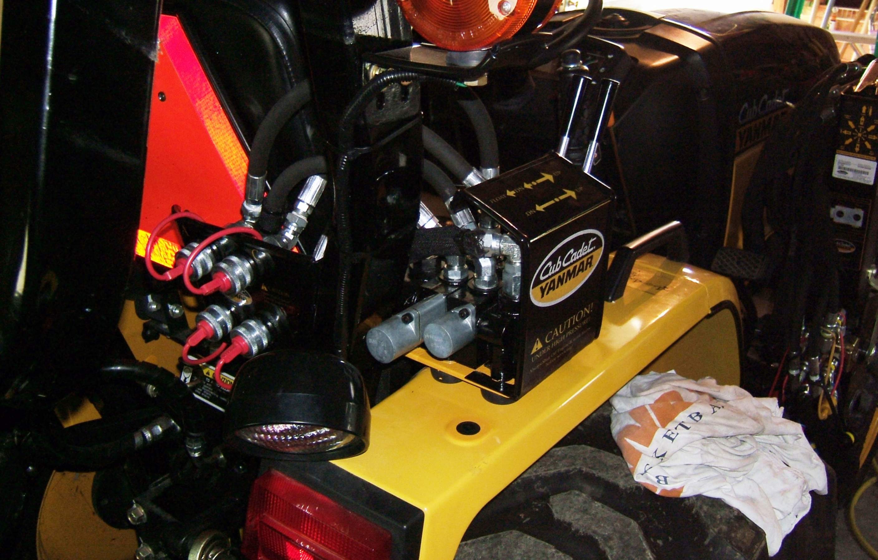

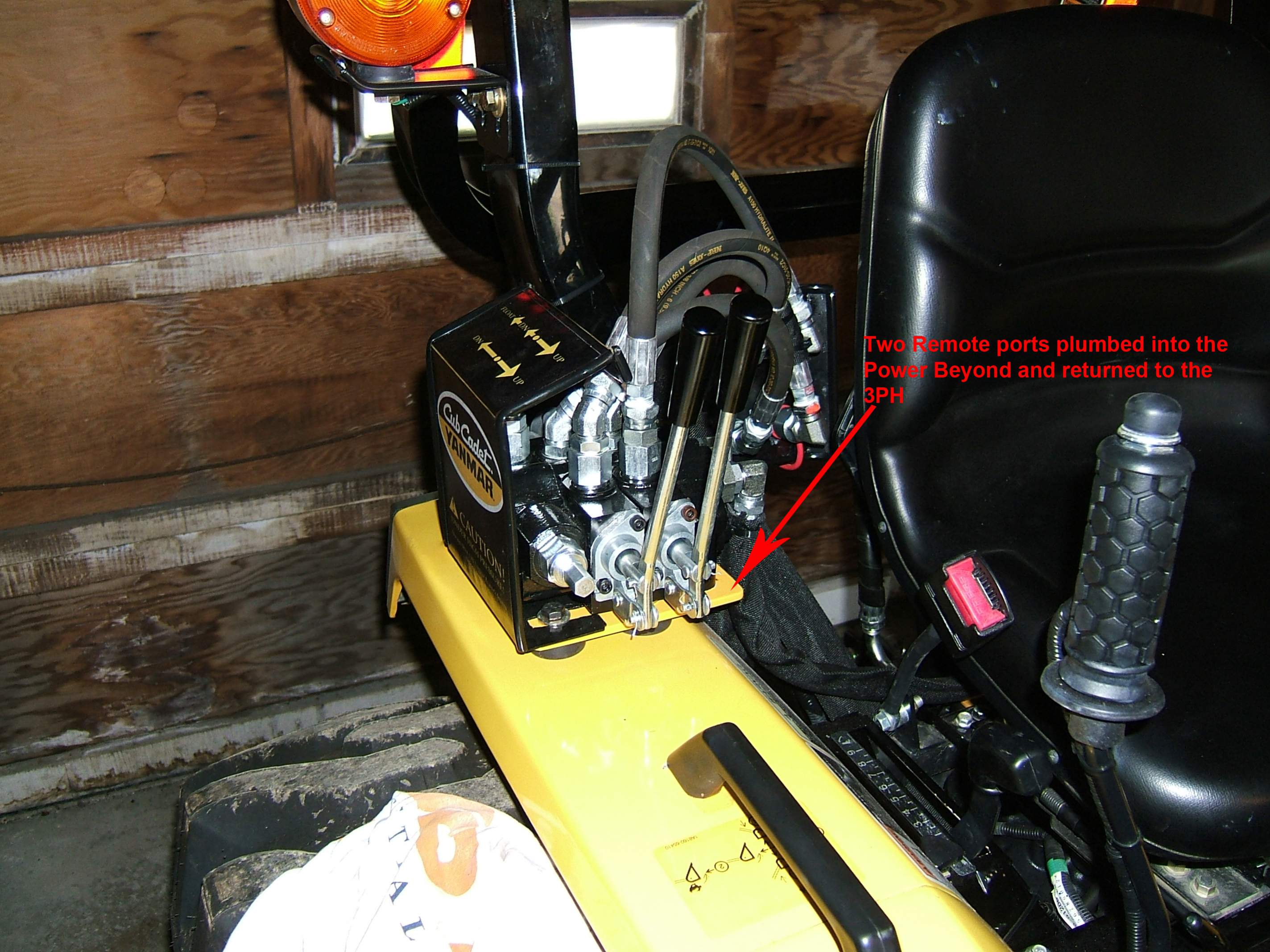

I am wondering if there is a reason you are using a diverter valve. My loader valve has a power beyond port that allowed me to add a valve to the circuit. The valve I bought from Surplus Center also has a power beyond port which runs to the 3PH.
Thanks for the input Dana! The reason I chose to use the diverter valve is mostly convenience. I had previously installed two "remote" ports on my tractor and I used the power beyond port from the loader valve to power those (checkout pics). I thought about just using one of my remotes to power a grapple, but when I thought about it, trying to reach from FEL joystick and grabbing the Remote joystick, I thought could become cumbersome for me. So I just decided to put the diverter valve on and plumbed it through my Dump & Curl circuit with a momentary switch on the FEL joystick.

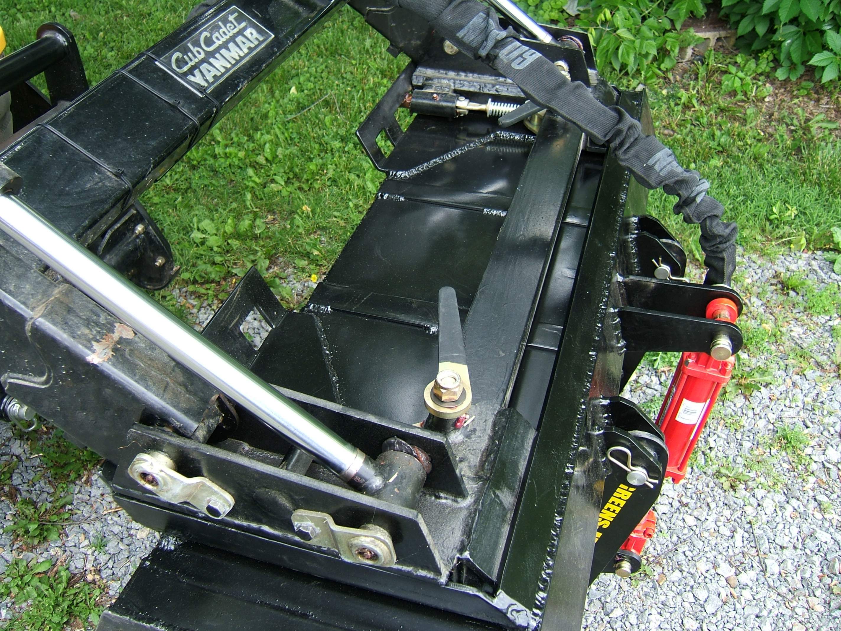

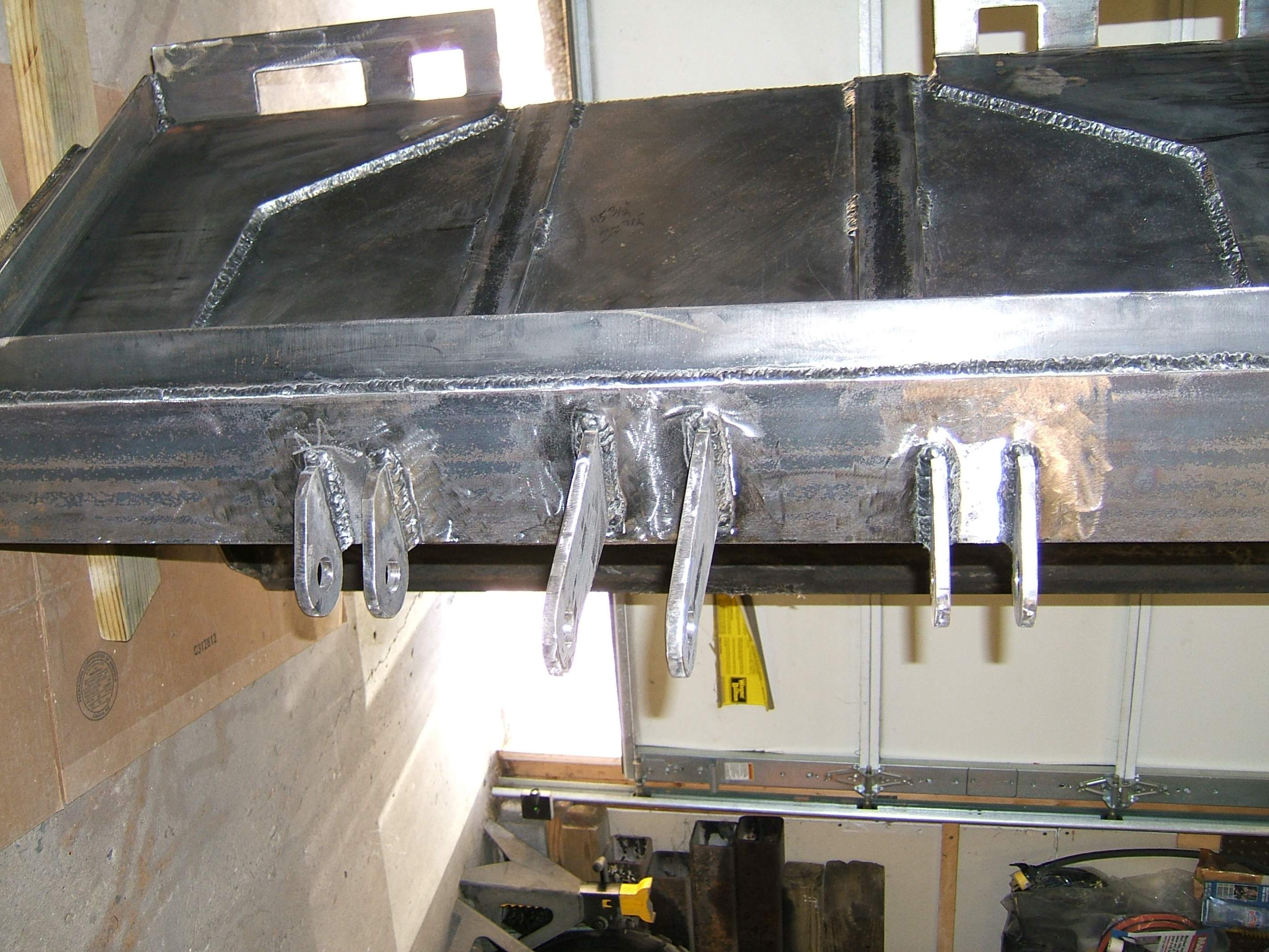

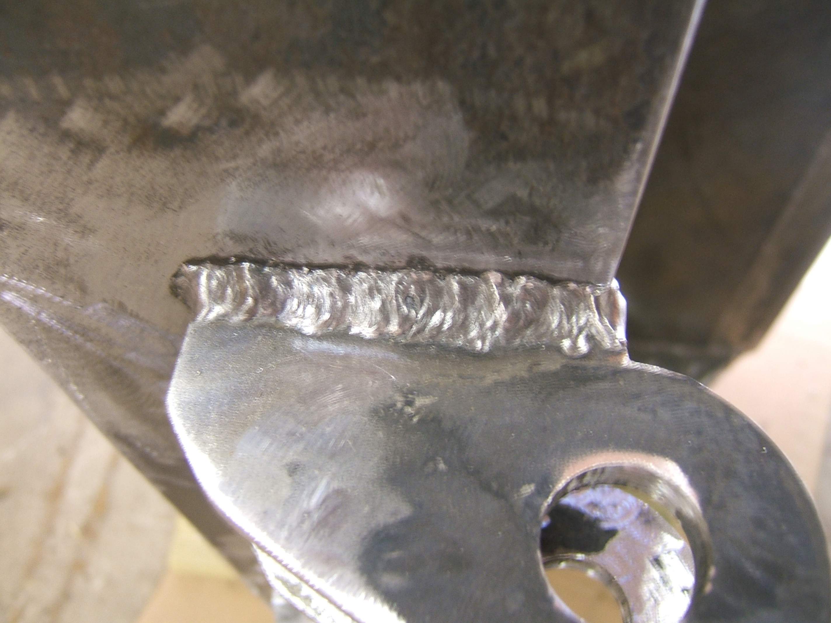

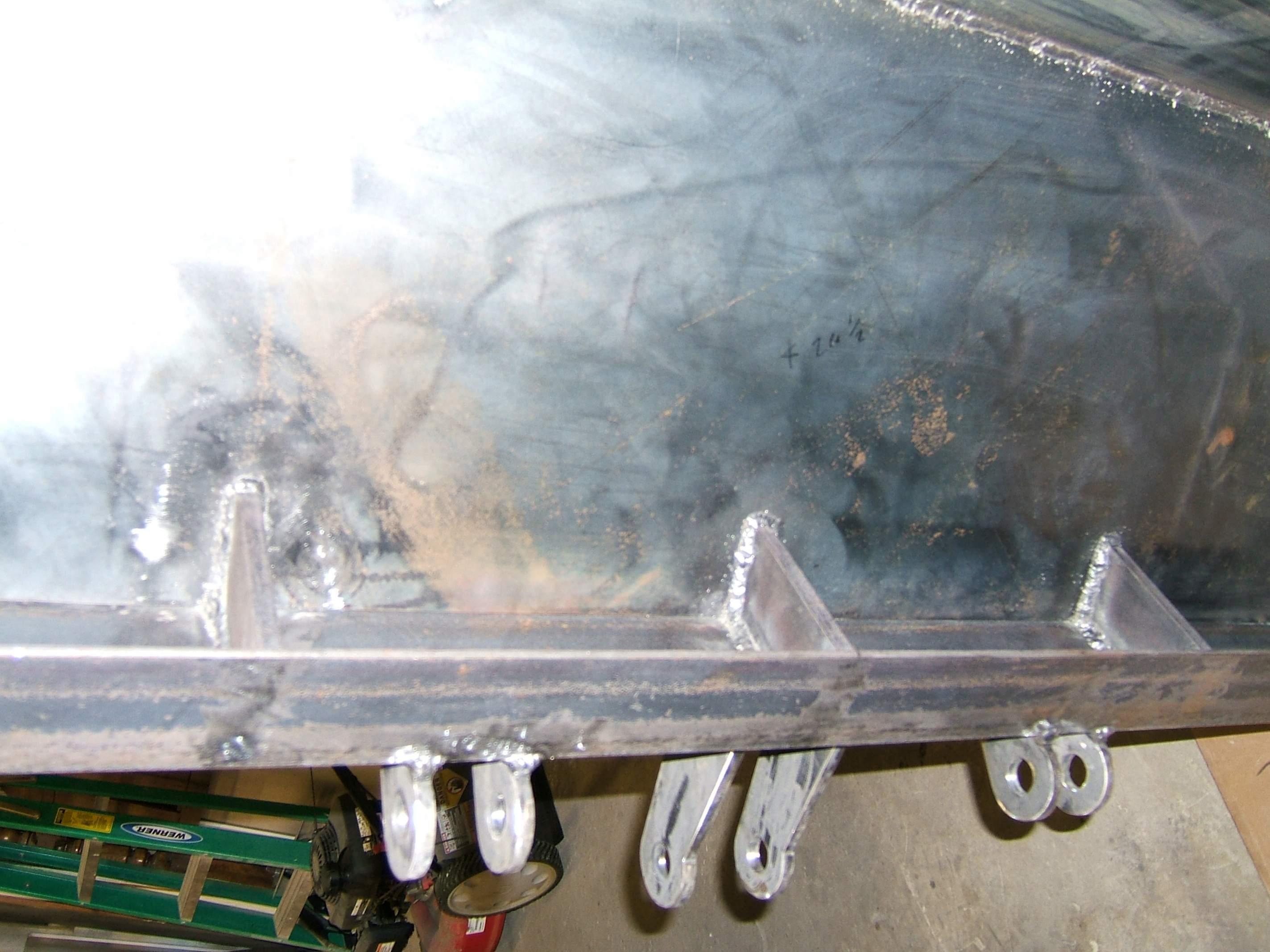

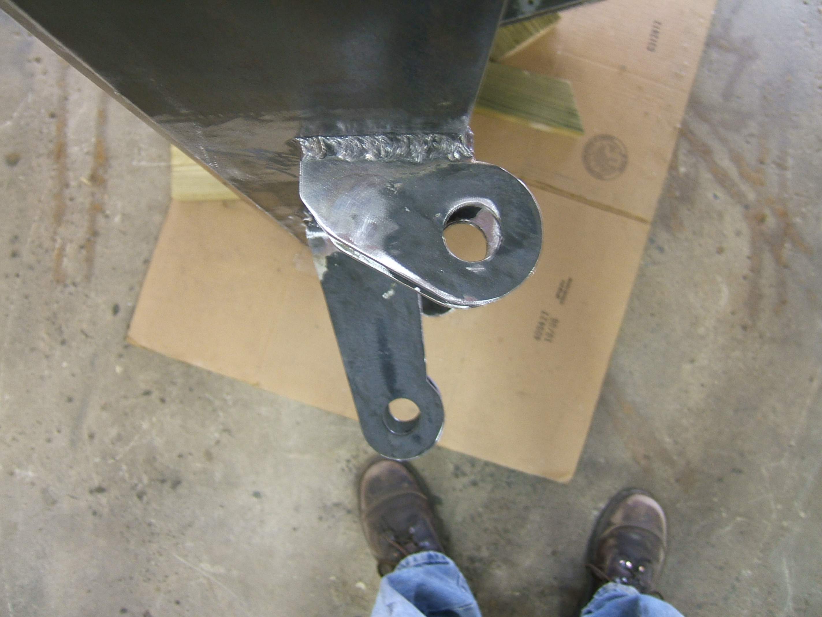

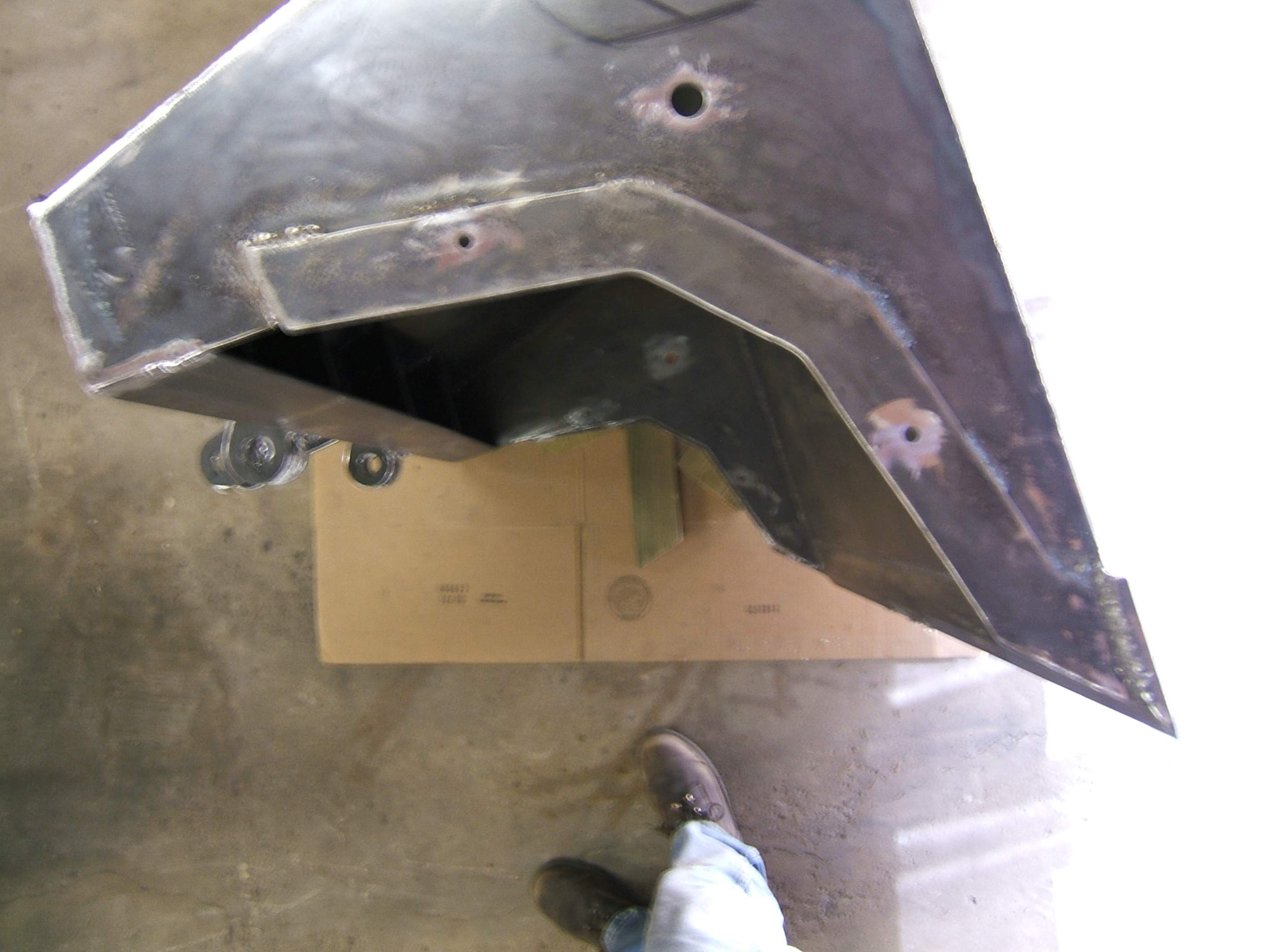

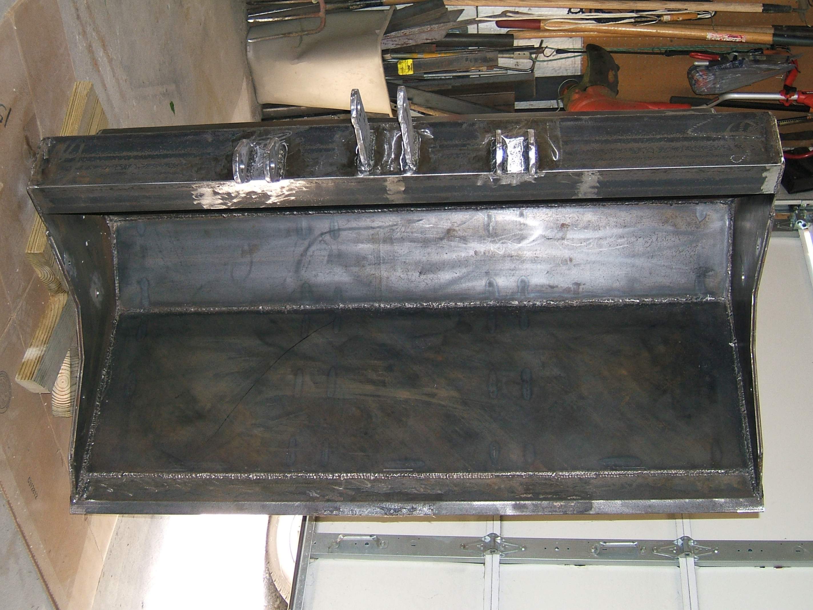

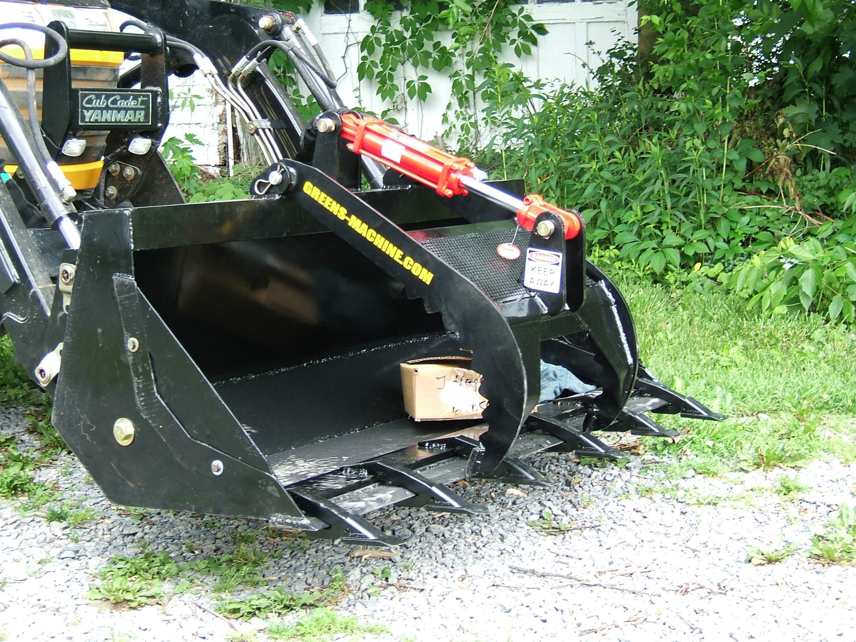

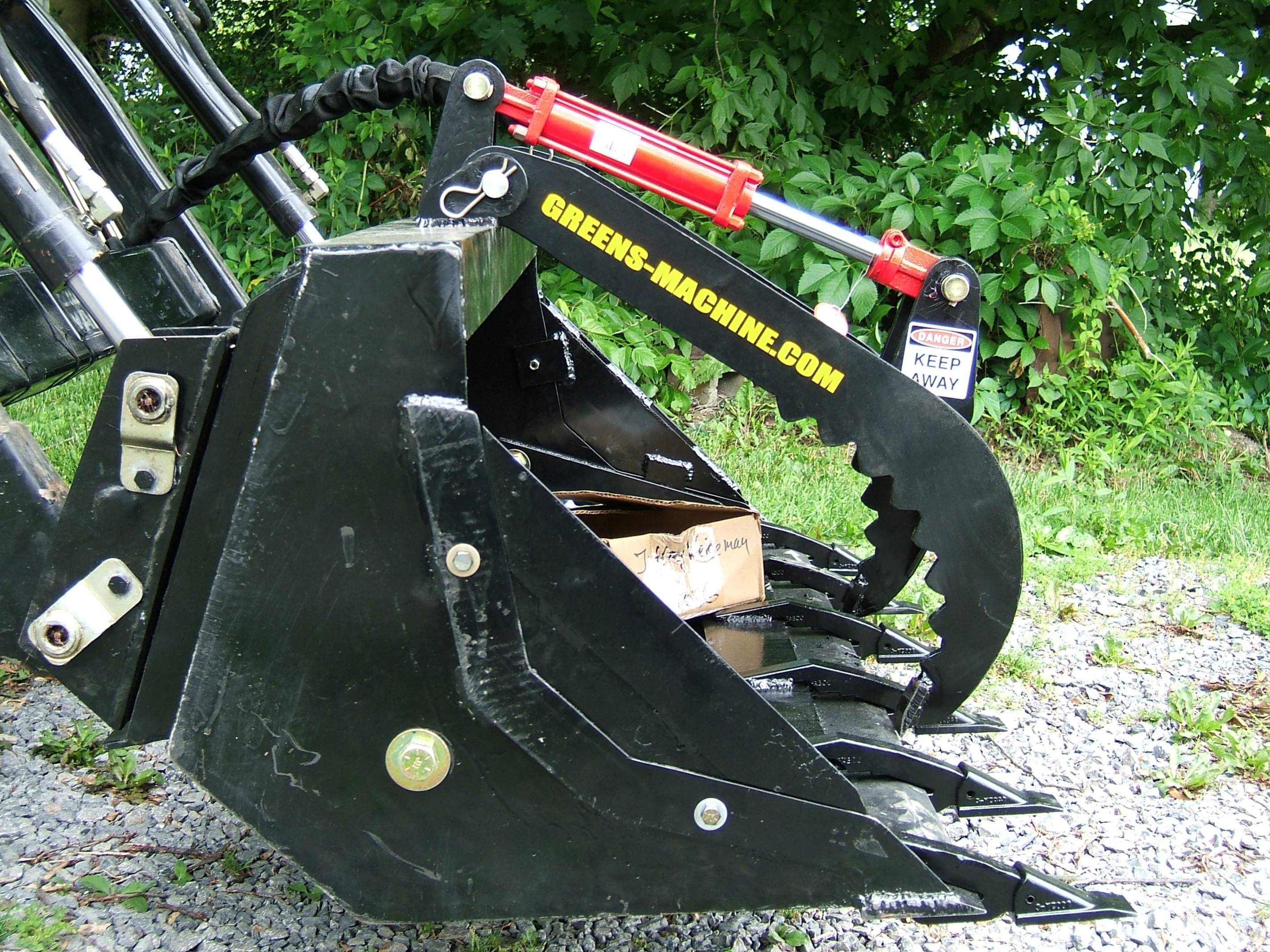

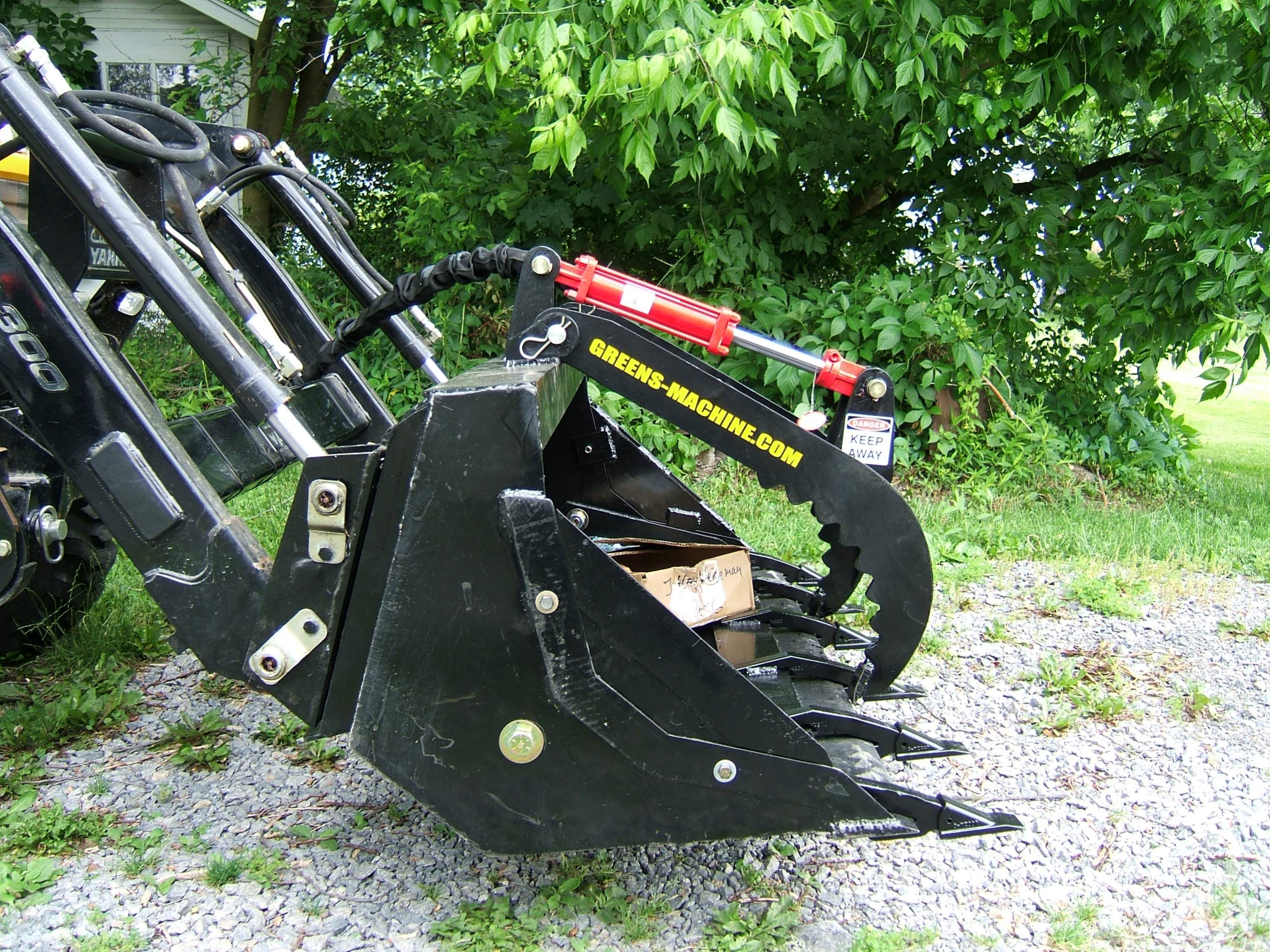

Sorry I haven't been able to post anything on here in awhile. I suffered a Brain Injury (TBI), that I'm still recovering from and I had to outsource some of my grapple bucket project to some friends, but here it is in all it's metallic glory! Very pleased with it!
Anti-Rotation Support Gussets.jpgBracket Weld Close-up.jpgBucket Interior.jpgGrapple Brackets.jpgSide Profile.jpgTop & Back Overview.jpg

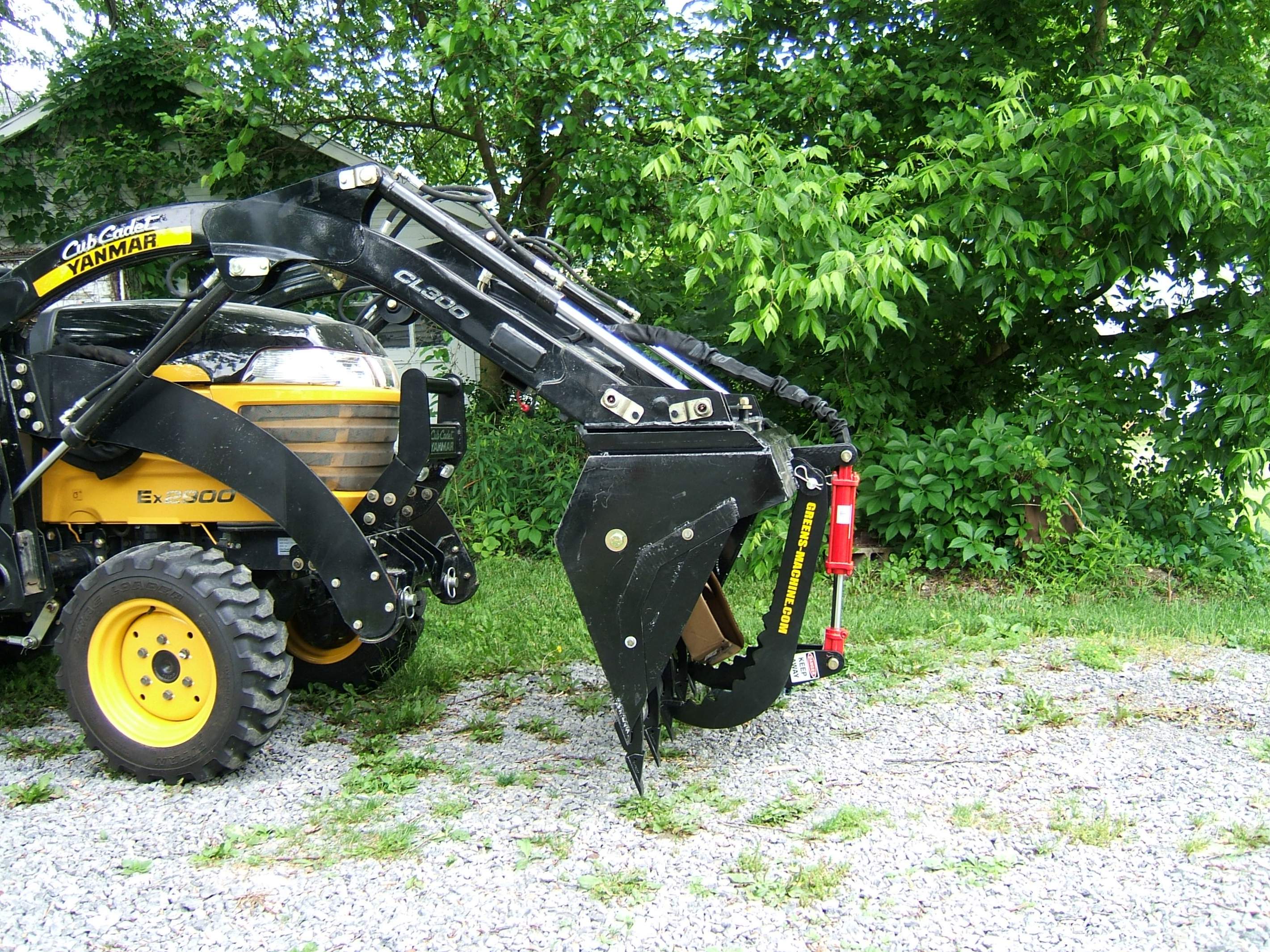

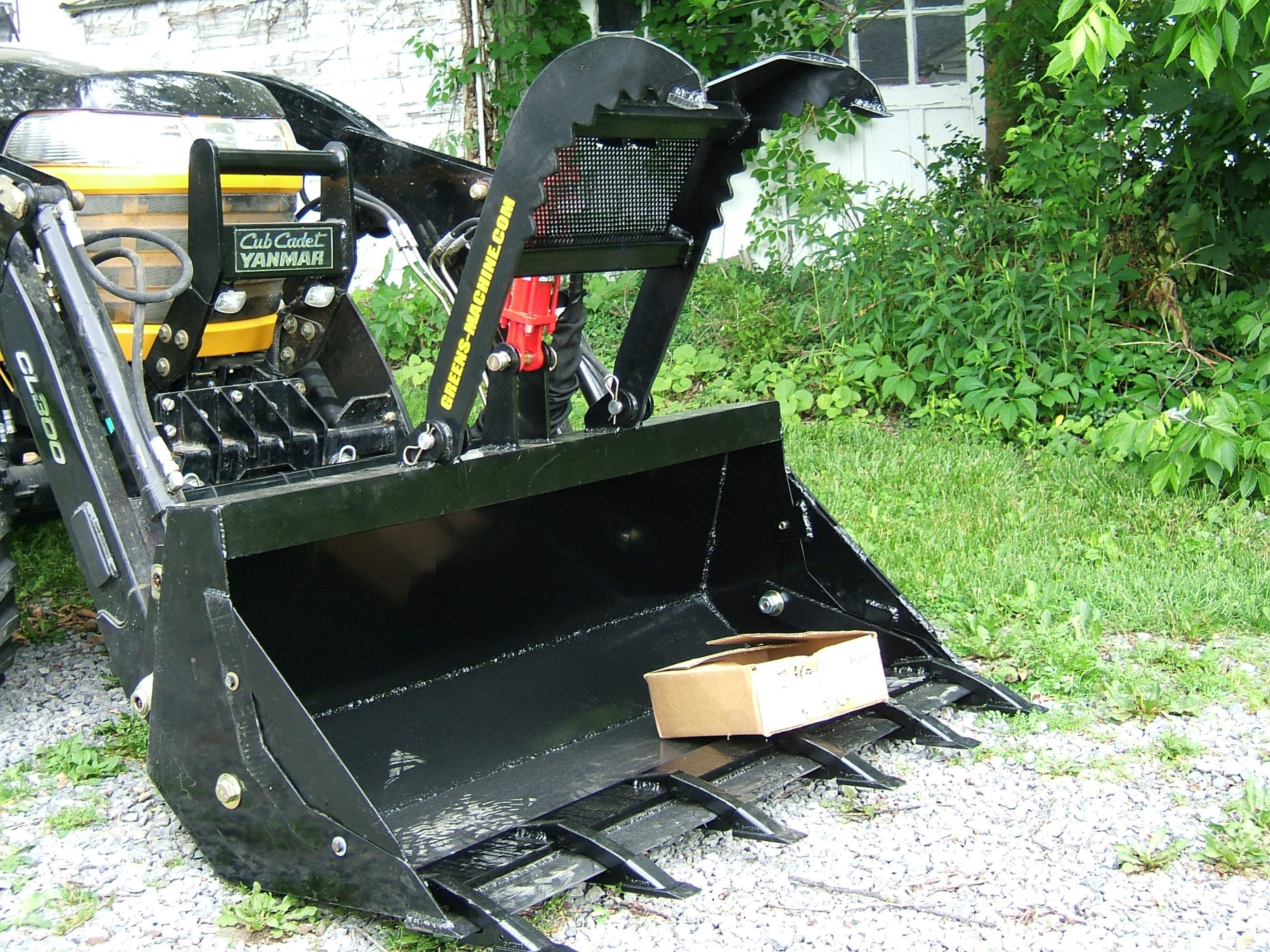

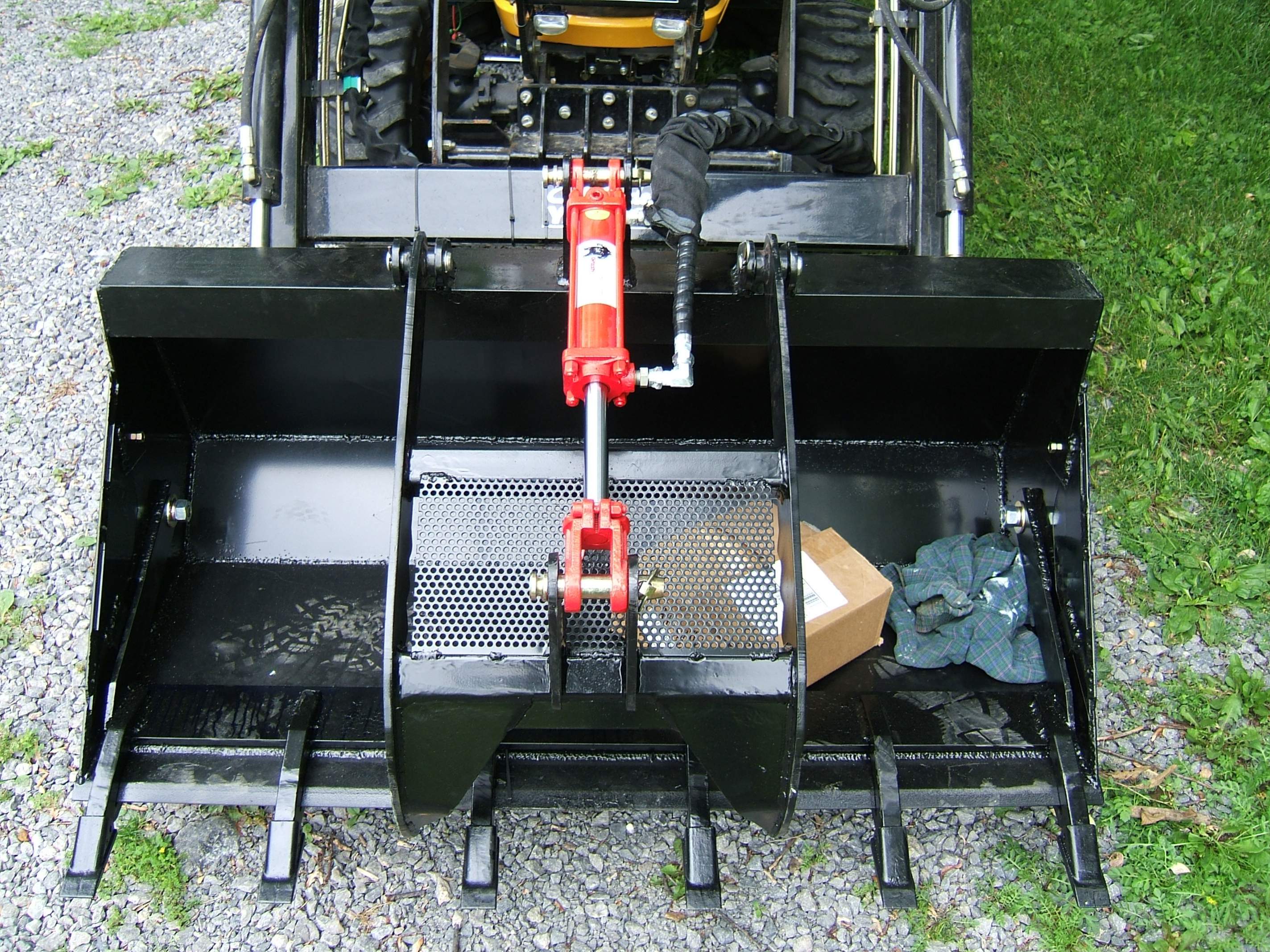

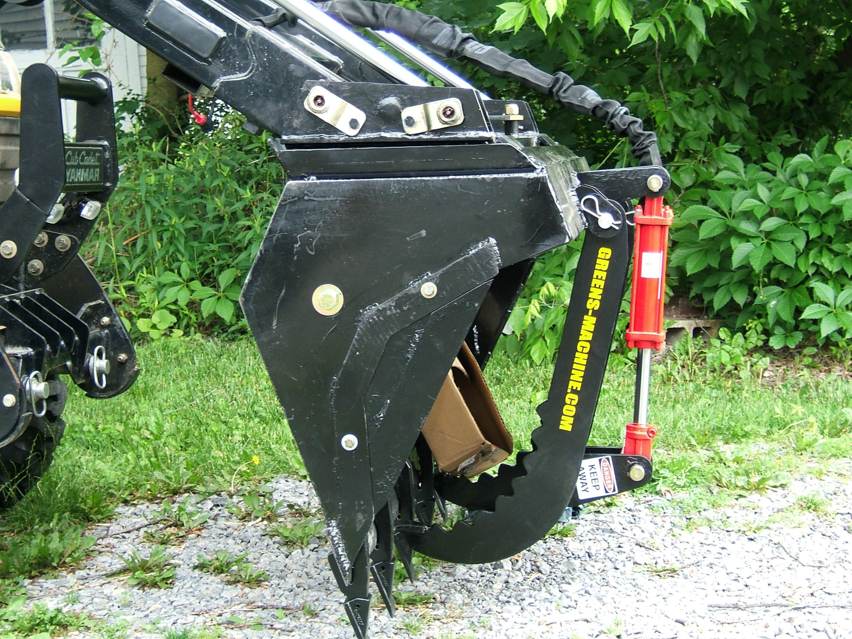

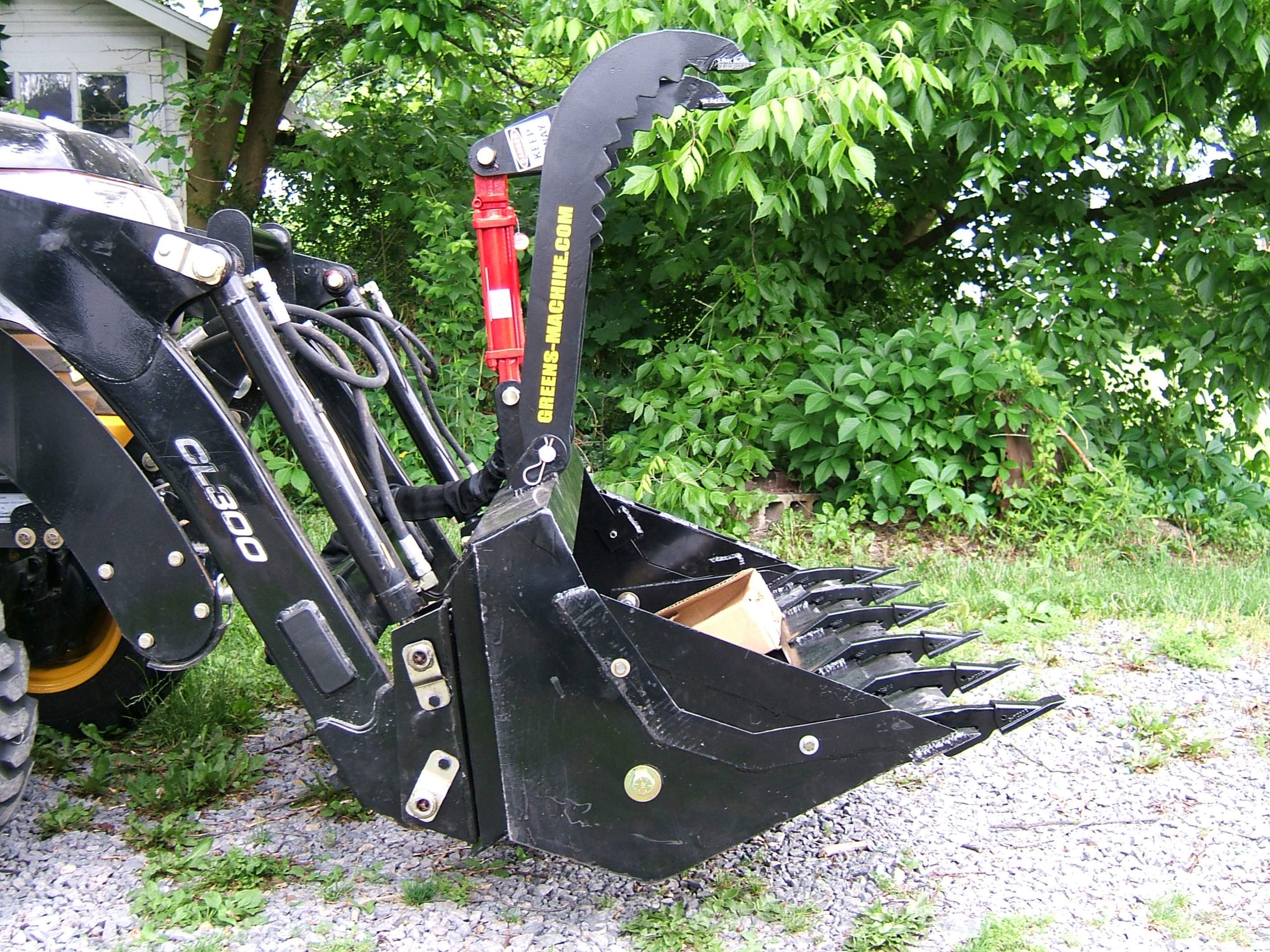

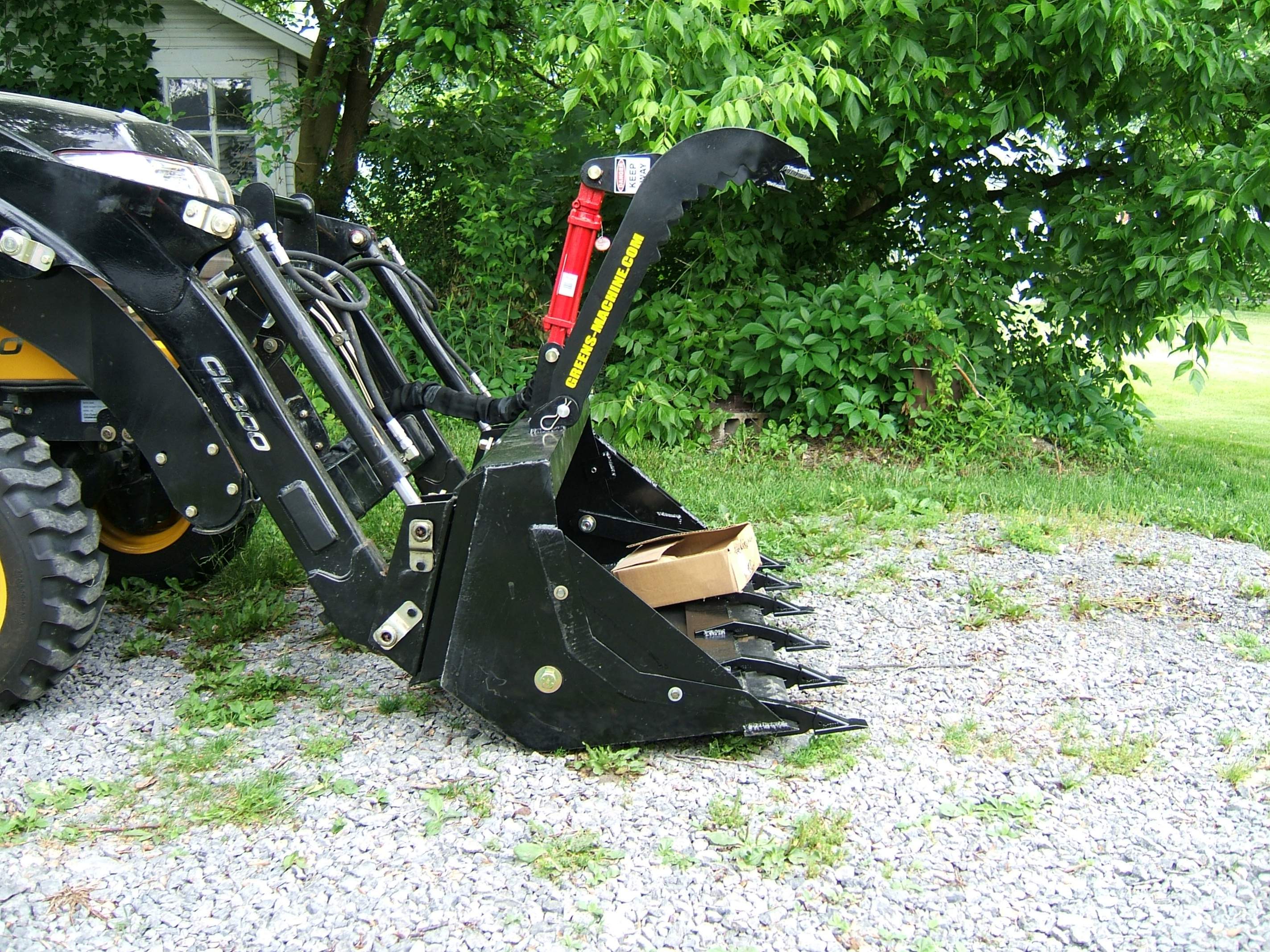

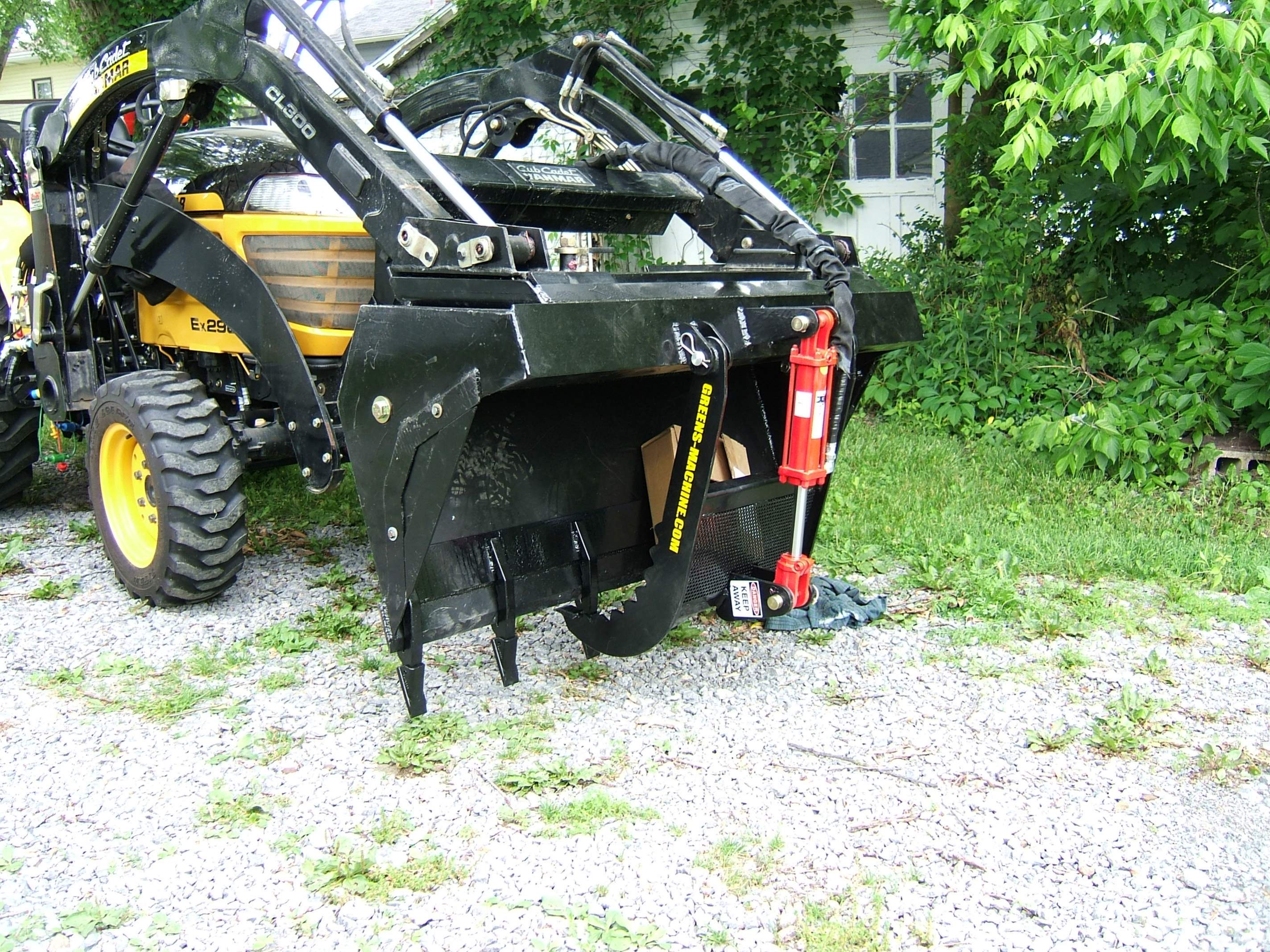

Here's some pretty pic's on tractor with tooth bar, side plates and grapple installed!
Angle View.jpgAngle View Open.jpgCurled View Open.jpgFinished Side.jpgFinished Side Closeup.jpgFron View.jpgQuick Attach View.jpgSide View Open.jpgTilt Angle.jpgTilt Angle 2.jpgTilt Angle Closeup.jpg
