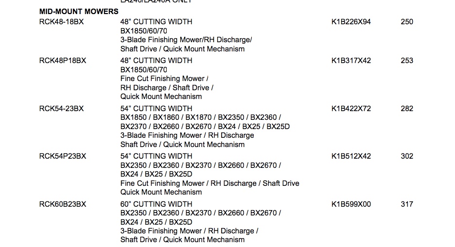

Does anyone know about these different decks and their fitment to the various BX's by series? Had Jerry, a fellow TBNer, offer me his new 60" off a BX25. Any insight on whether the mounting for the BX2360 is compatible to the BX25, that'd be great information.

No problem
This would appear to agree that the compatibility with a BX25 and the BX2360 is fine. My only concern was/is the absurd number of BX25 variants that exist.
   / Gonna put a mid mower deck on my older BX #9
The deck is a RCKB23BX 59768 60"side discharge. BP.
