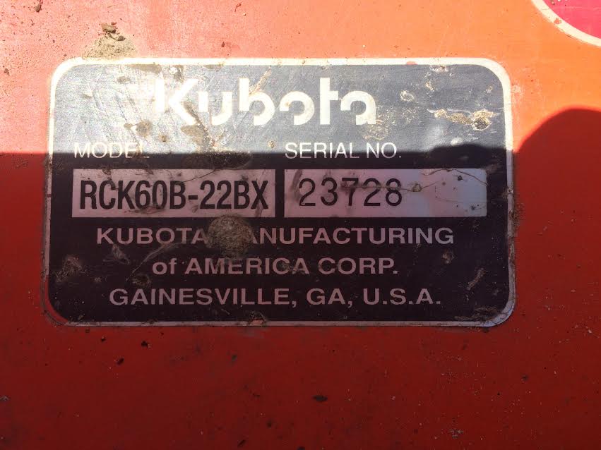

I think anybody like Old Red, myself, or anyone else mulling over whether to buy or sell attachments that posting the model number would be helpful, of course. Appreciate the post greatly and thanks 2ndhalf. :thumbsup:
   / Gonna put a mid mower deck on my older BX #15

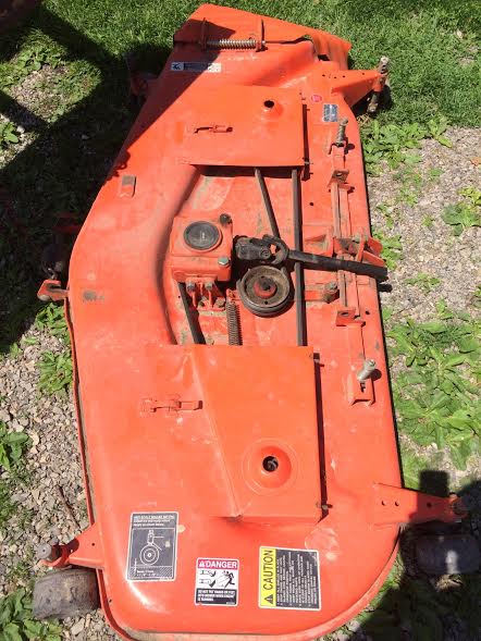

I think I listed it on CL for $900 a few months back and it didn't sell. I told him to be patient because it would take the right buyer. I also told him I wouldn't sell it if he thinks he may ever want to sell his mower because it would break up a nice package if he did. He justs texted me back and said he still has it if you want to PM your number. I can get your numbers to him.

Does anyone know about these different decks and their fitment to the various BX's by series? Had Jerry, a fellow TBNer, offer me his new 60" off a BX25. Any insight on whether the mounting for the BX2360 is compatible to the BX25, that'd be great information.
BP, that deck swap should be no problem. I kept my original 54" deck from my BX1850 when I traded up to my BX25 back in 2011. Completely compatible. My BX25 is of the 60 series line, so it should fit.
It also worked with my old 1860. Don't think they changed deck mounts, etc., until the 80 series came out.
Chris, first, good to hear from you again old friend. Second, my research agrees with you. When I started this thread a few days ago, I didn't know what I didn't know. :) Since, my research using Kubota Whole Goods publications, which is a great way to sniff out stuff like this, agrees with you as well. Take care.
