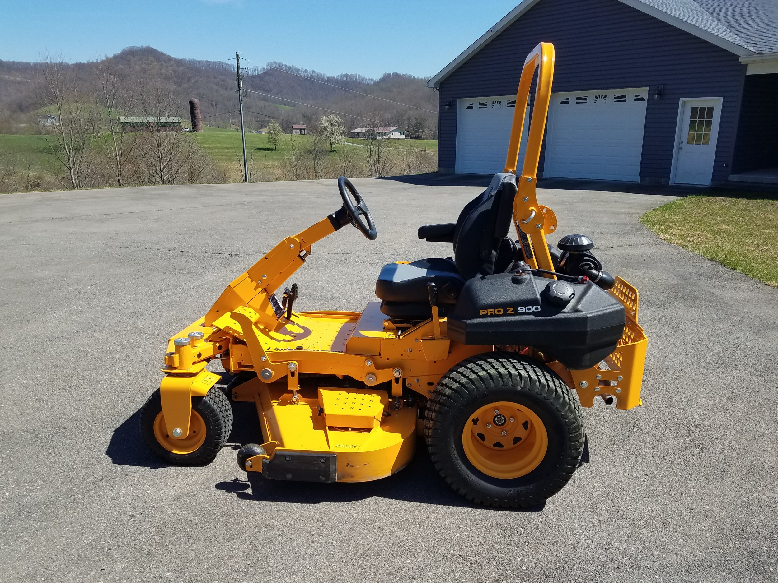

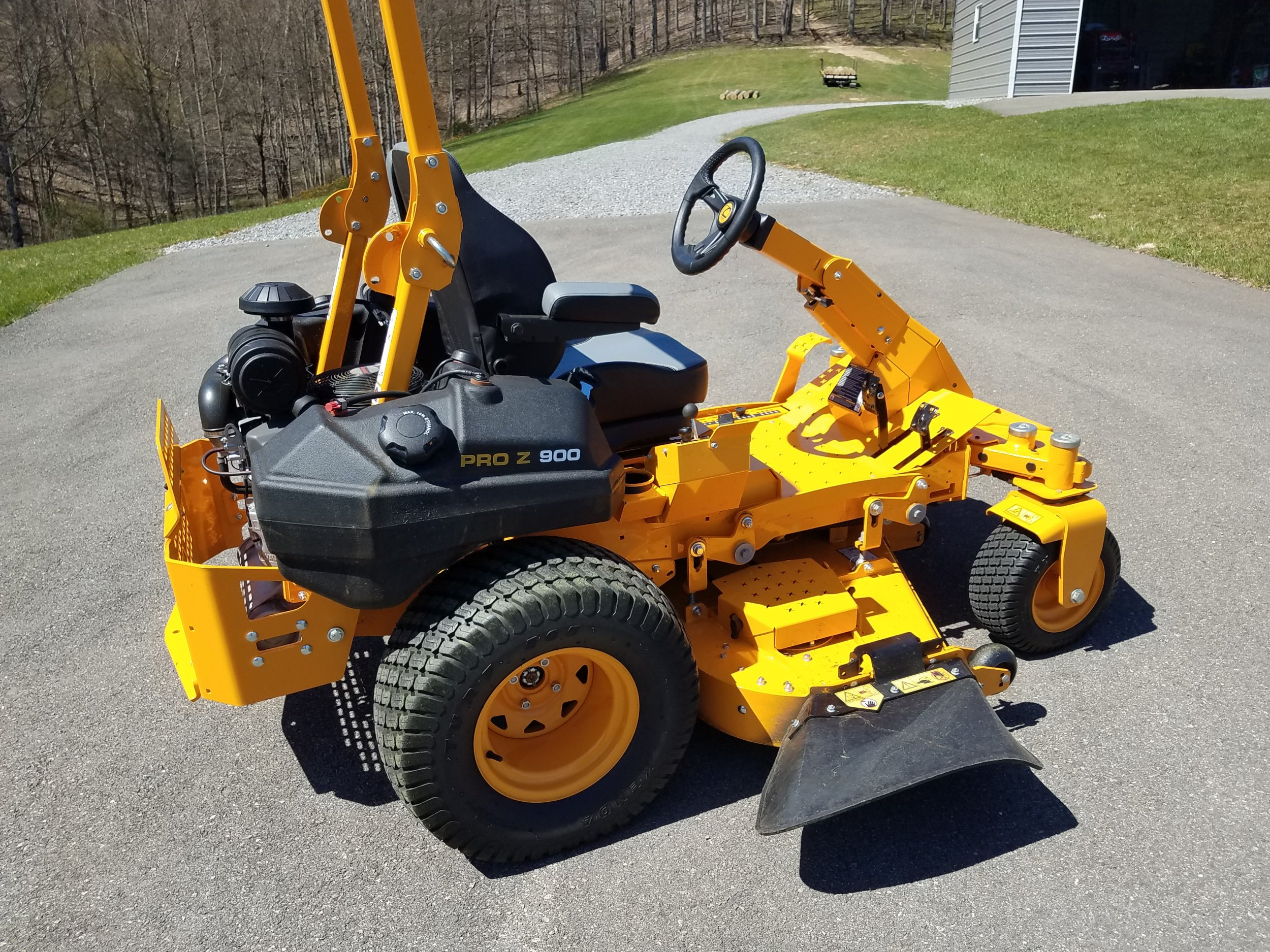

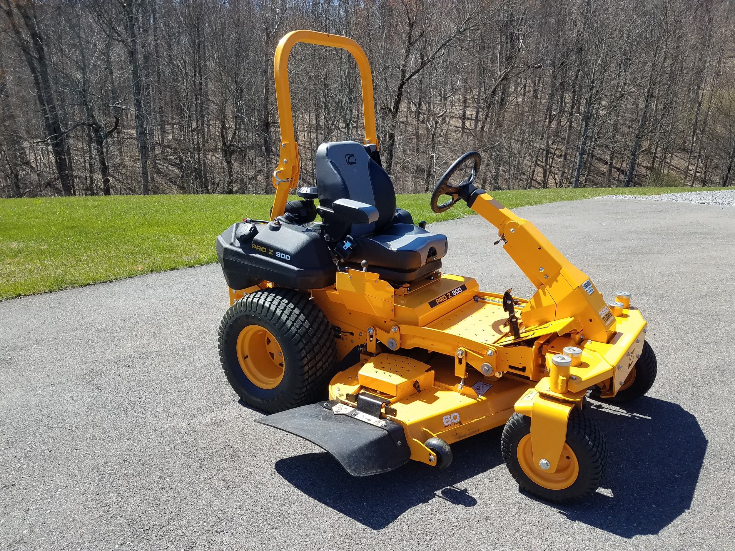

I have a 2022 Cub Cadet Pro Z 960s KW not a year old yet with 58 hrs on it. Always garage kept. After sitting for a week or so between mows it acts like the battery is low or bad and is hard to turn over. Once it stars everything runs just fine. I can then turn it off for a bit, a few hours or so and it starts just great. It's after it sits for a few days is when it starts acting like it's got a dying battery. I've checked for a parasitic drain and found none and checked the battery voltage after a week of sitting and it is at 12.8V not running. What else am I missing or what should I check next.

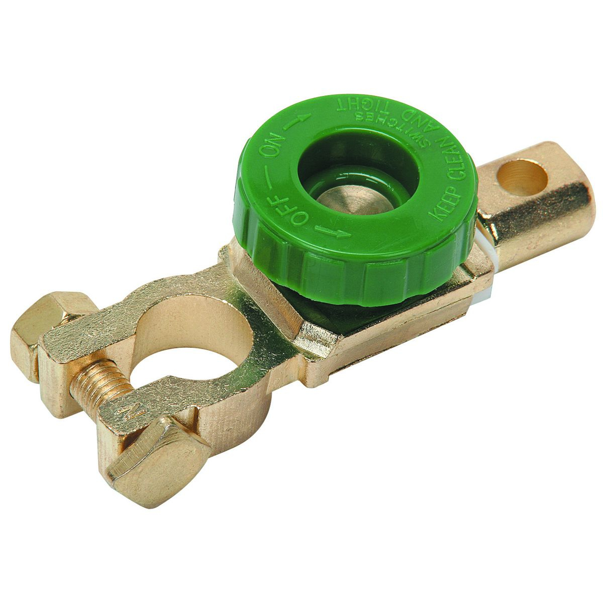

If it passes an actual load test, add a battery disconnect switch on battery.
