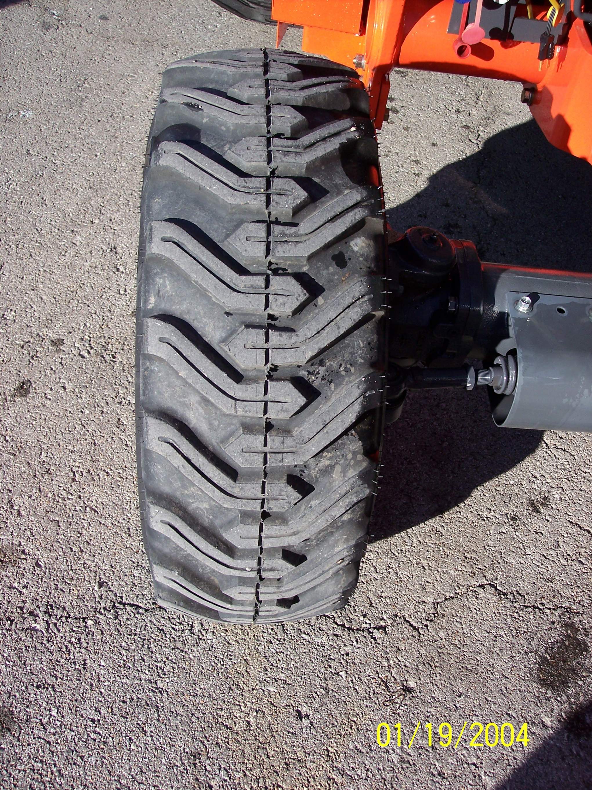

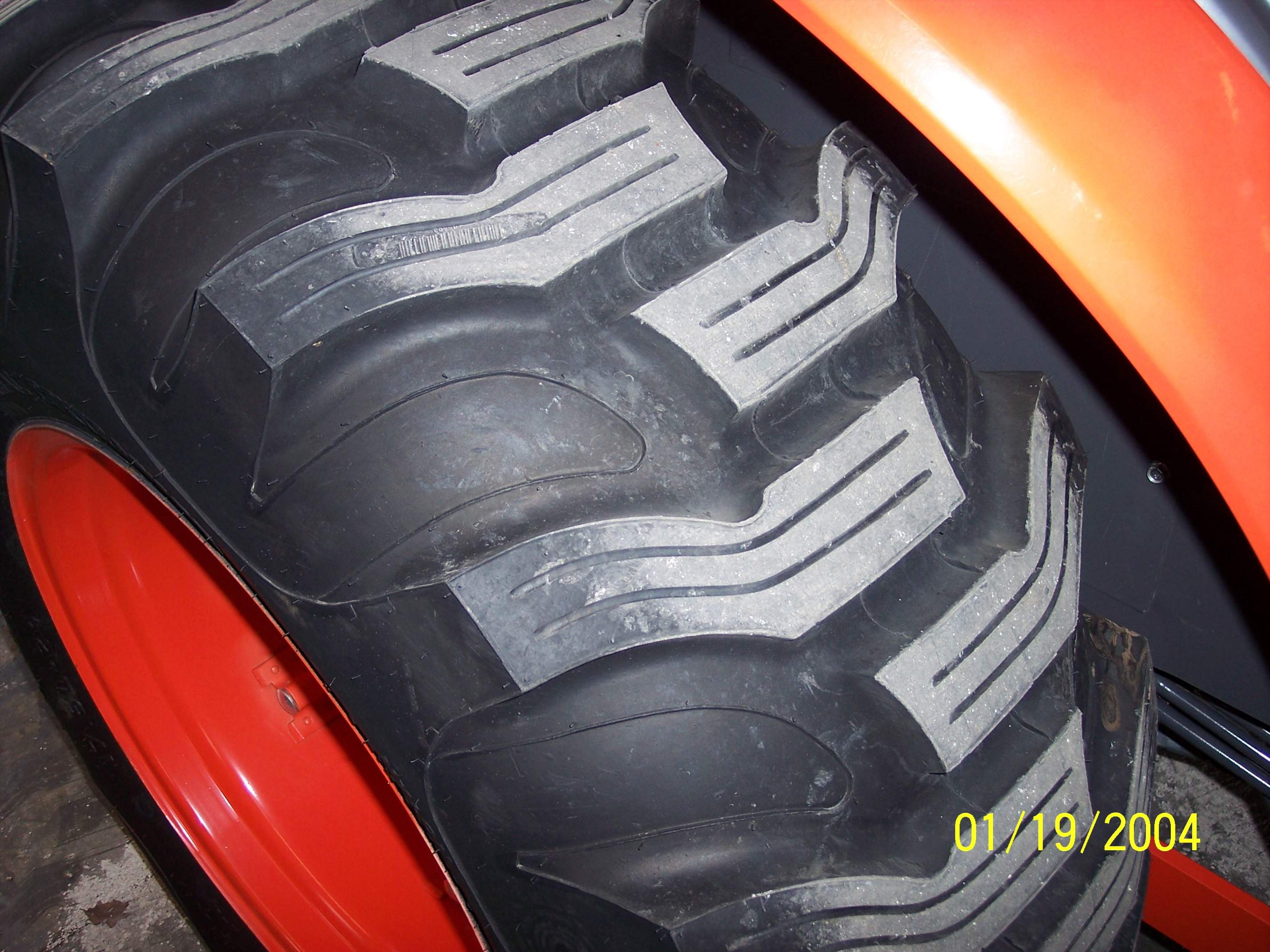

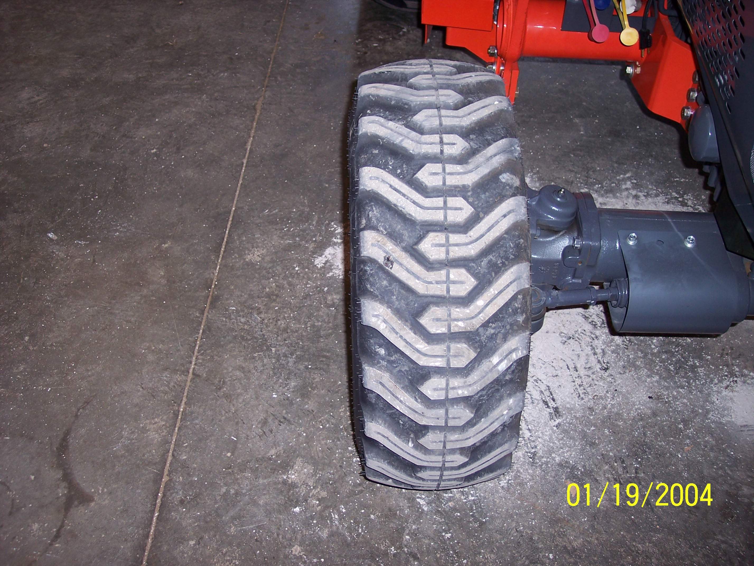

I would try grooving your tires. A tire grooving tool is only $60-$70 on ebay new. Also I would ballast your rear tires. I recommend RimGuard. It's beet juice good for -40 deg F or less and it won't corrode your wheels and is environmentally friendly. It added 1300 lbs to the back of my tractor.:thumbsup:
