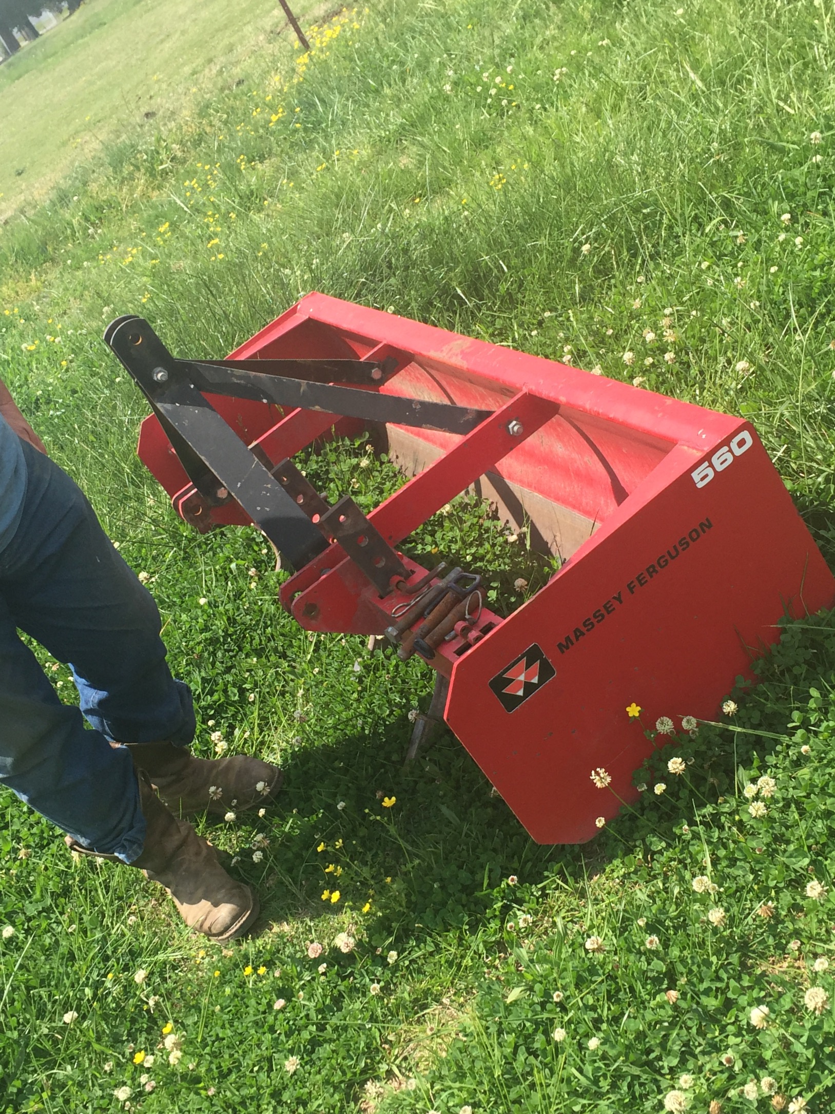

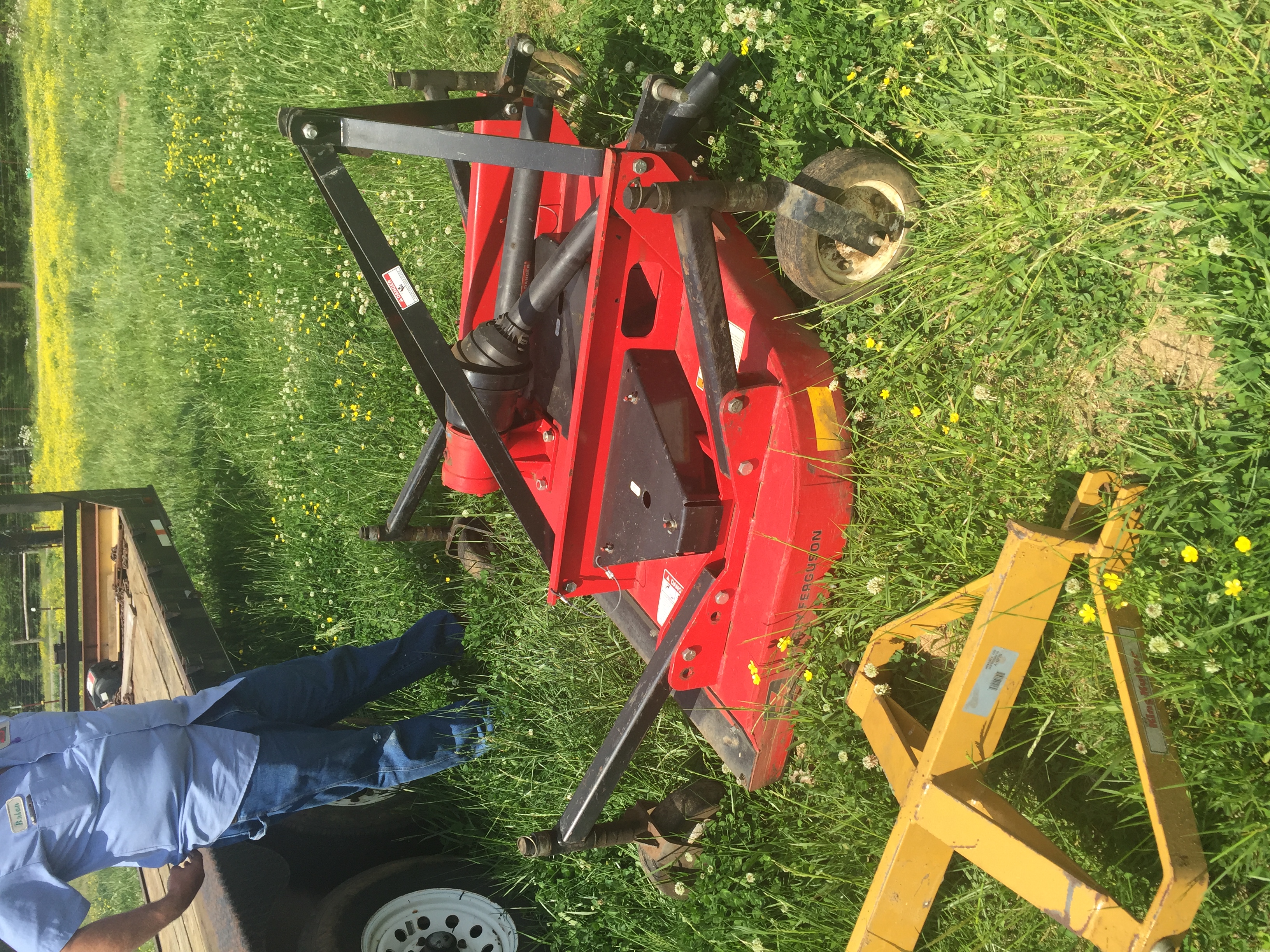

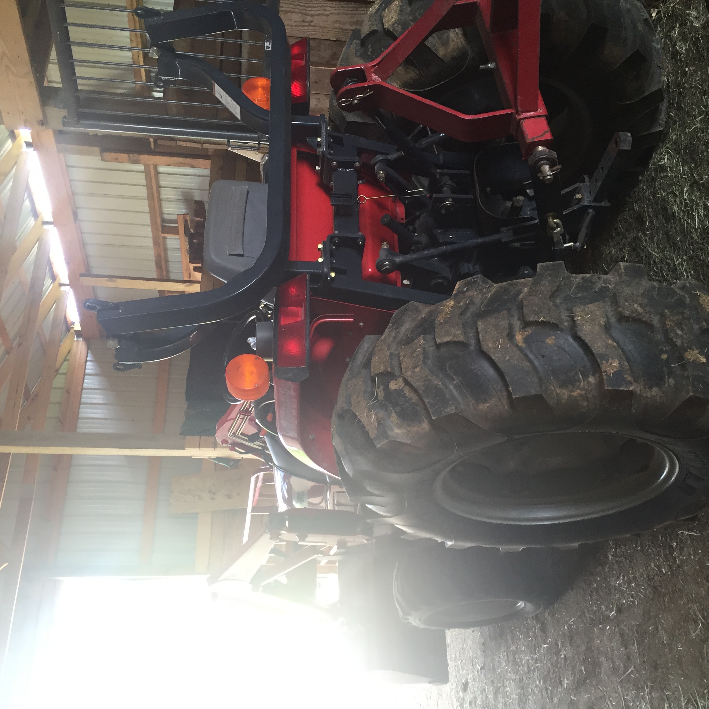

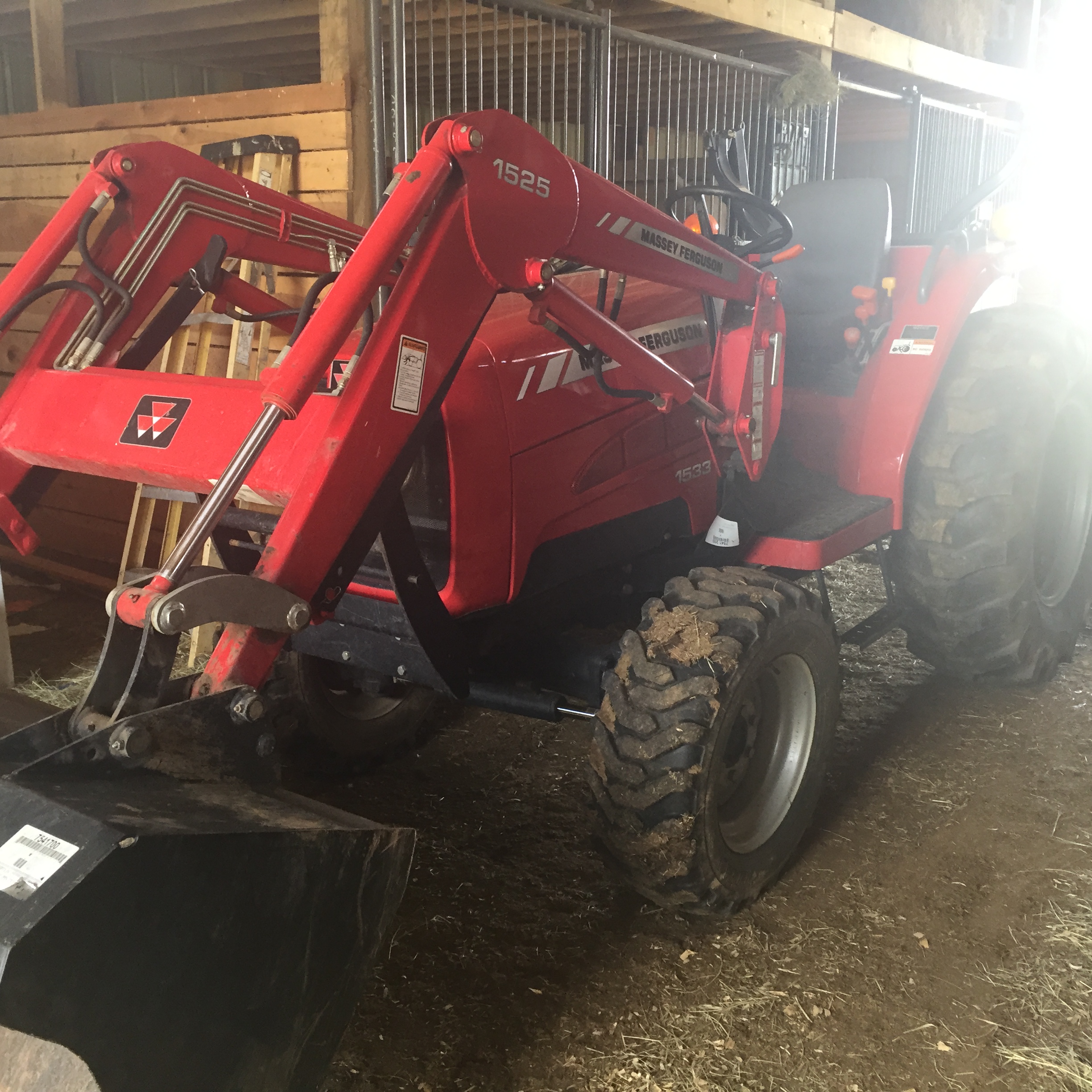

I have the opportunity to pick a used tractor and I'm pretty excited about the deal. Tractor runs well and looks really good, always kept indoors and looks it. Several included implements. Seems like a good deal to me but given I'm a greenhorn wanted to get some impartial opinions before diving in.
Specs and included implements:
2005 Massey Ferguson 1533
480 hours
Synchroshift trans
Loader
Rear finish mower
Rear box blade
Plow
$12,500
See attached pics
I don't need some of these attachments so figure I can sell to make some money back. The seller wants to sell it all together.
Thoughts?

It looks good in the pics:) and the price to me sounds fair.
The big question is, what do you need the tractor to do?
Is this the right sized tractor for your needs?

For gear drive and pin-on bucket.... :thumbdown:

What would this package cost new? Not retail price -- Negotiated bottom line price?
Establish the above and then adjust to a fair used value from there.
New compact tractors have increased in price significantly over the past 3 - 5 years in my opinion. Therefore clean used units, of the better regarded brands, have held their value pretty well.

I'm not far from you in SC so I feel that prices are comparable in our area. The finish mower and box blade are MF brand and are good quality. Not sure who makes the MF mower, but it may be Woods. Mower would be worth 1000 and blade worth 450 or so. Plow is a cheapie tractor supply brand or something like that. Worth 50 bucks. So, that's 1500 for implements. That puts you at 11 grand for the tractor. I think that's a good deal, but not a steal. If everything is as nice as it looks, has been kept inside, and will do what you want - I'd buy it and never look back. I don't agree with the poster that downed the package based upon lack of SSQA and gear drive. Going from NO tractor to THIS tractor is a huge step forward. You can always add SSQA later on. I prefer gear to HST, but I don't want to get an argument started on that.
Keep in mind that the resale value of MF in our area is not quite as high as Kubota, JD or NH. That doesn't mean it isn't a good tractor, just a point of information. Parts are somewhat harder to come by as they can only be obtained from a dealership. JD, NH, and Kub are all available online from several sources. Never found a good online source for MF. Again - just a bit of info.
I'd buy this machine any day over a SCUT. Much more capability for the same money. For your mowing, you'll like the 6' mower.
Good luck.
