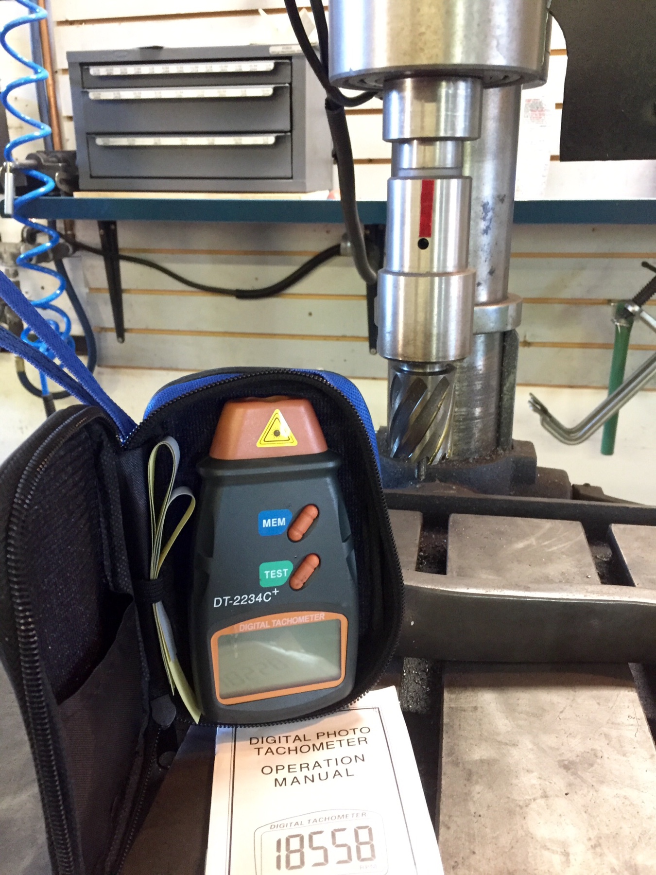

Well ..... slow depends on what you are using to drill the hole, but in general the slower you can go the better. With my drill press I can get speeds down below 50 rpm, with a hand drill it is probably more like 150 rpm.
   / Good drill bits #17
And what is slow speed in your guys books?
With 1/4" -- 3-500rpm. With 1/2" -- 1 - 200. The point made that you be sure you are making steady progress is paramount. Never allow the bit to "rub" on the bottom of the hole. This not only dulls the bit but hardens the metal youre trying to cut.

I picked up this digital tachometer from ebay. Works surprisingly alright.
