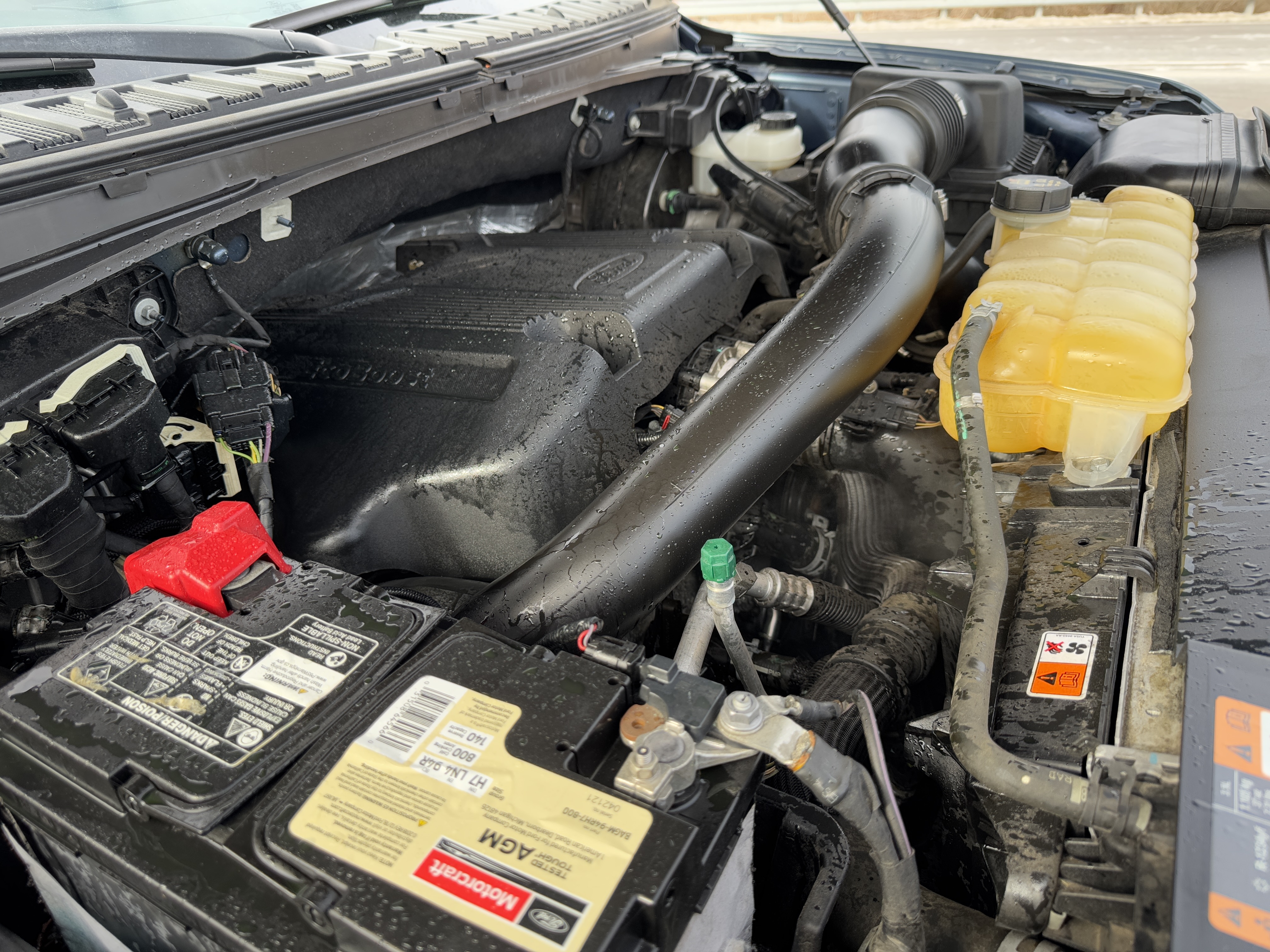

But on the way back, lights start flashing on dash and I peer at the dash
and it says 258 degrees. Oh boy, she's about to fizz.
And fizz she did.
lot of my brand new antifreeze all over the place.
thankfully I was off the road and engine off in 15 seconds.
it took two hours alongside route 263 this morning before tow truck finally came.
thankfully my brother came after an hour and I could get warm.
I sure would like to see the condition of the radiator drain plug. Have to wonder if they
didn't get it tight, and it leaked out. So cold out you don't see it for a while.
They brought it to me last night and left it in my driveway. Makes me wonder if that light was on then...
might be something simple like a thermostat or radiator cap. But annoying to get one half hour of use of this car before
it left me stranded on a cold day.
spent almost half an hour dickering with two different towing companies, everyone says they have jobs ahead of me, two hours, yada yada.
ok, that's when I called my brother, who called his friend Rob of Rob's Towing and that truck was here in 45 minutes. Only charged me 125, which
will get reimbursed at some point. I had gotten pretty cold sitting there, watching temp gauge as it got to 235 and I'd turn it off.
but that didn't produce much heat and it's in high 20's out. So by time my brother got there, my legs were pretty cold
excellent reason why us Northerners need blankets in cars.
thank goodness I have other car at home.
too much drama with this car, hope not bad omen.
Drew, I believe I'd be taking that back and finding something else. Those temps wouldn't set well with my confidence to be towing a camper as you plan to do.
In my eyes it's toast.

I would have to wonder if that engine got air locked when they refilled it. Some of these newer vehicles can be a complete pain to get all the air out of the system.
Many have a somewhat elaborate procedure to bleed the air out.
/ Good morning!!!! #202,385
Almost certainly the case. The lack of heat confirms that.

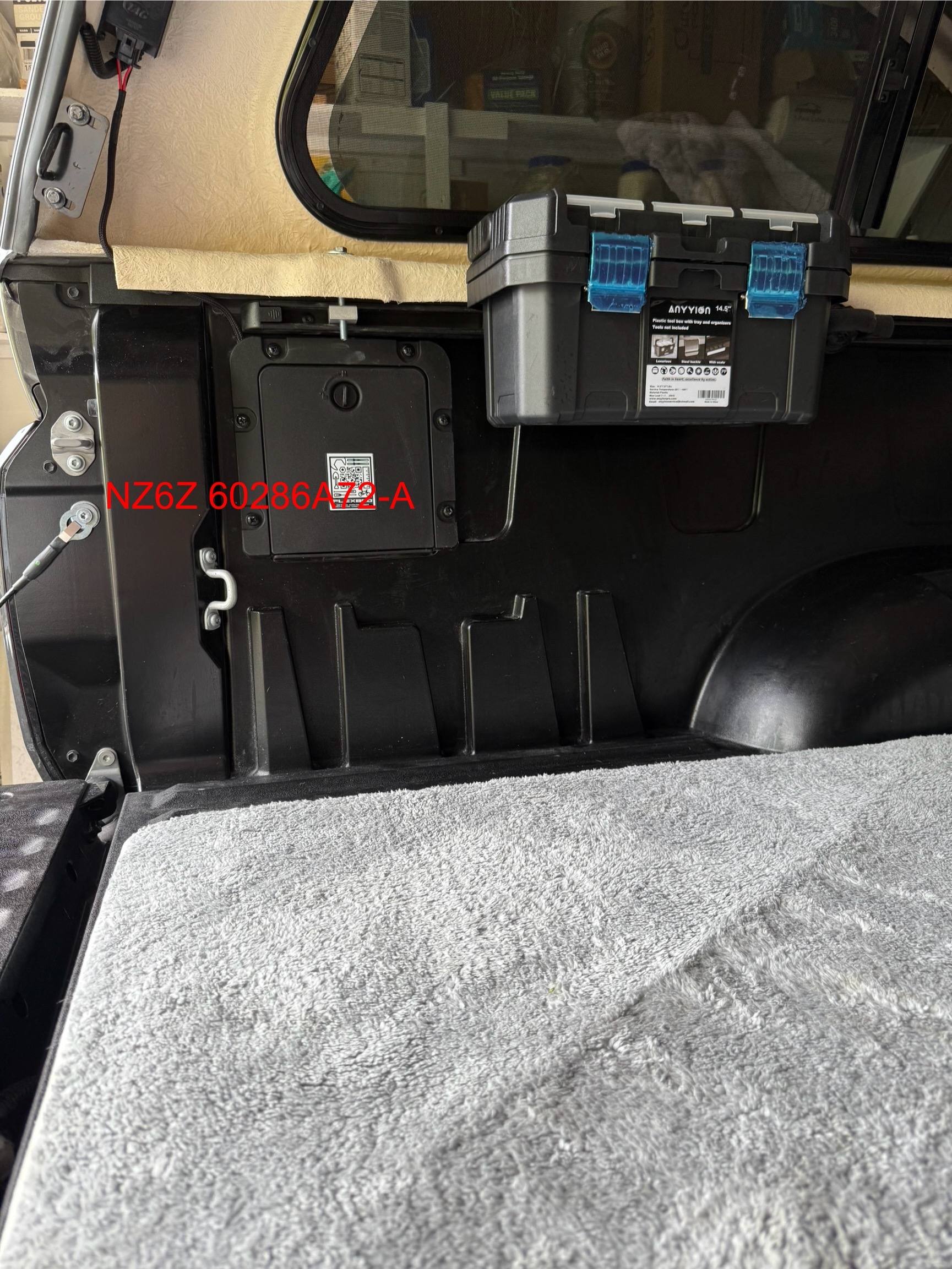

Wet morning, so no mow
But opportunity to get my inbed storage
Toolbox to right is removable.
I will change out the sheet metal screws to button head bolts to look more factory.
