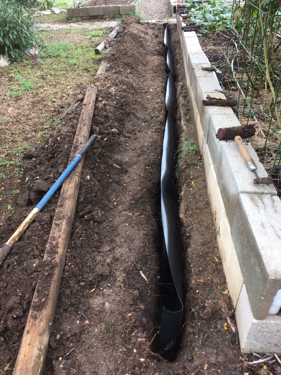

Got my fingers in the mud today and finished the root trench and barrier. I will be so sore tomorrow.

Glad you got your trenching done in the cool.

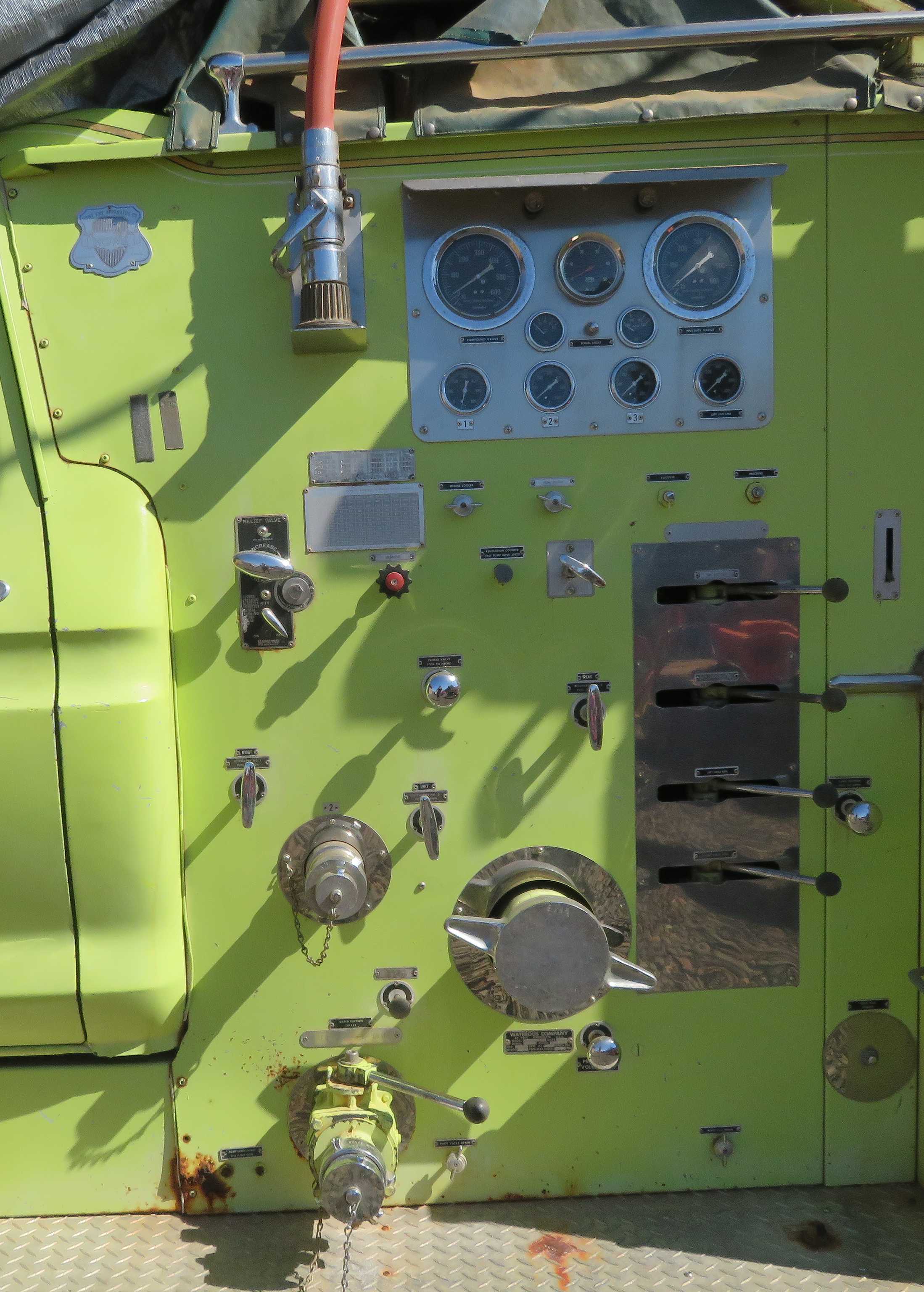

There is a Pressure Relief Valve (top row of controls, left end), but it doesn't seem to have any effect, Rick. At most I've seen 45 PSI on the gauge. It's set up to draft water from the 2500 drinking water tank, and the fill valve to the onboard tank is closed. Water is making it out the end of the hose, so the lines are primed, there's just no pressure...

RNG, I sent pic and your description to my ex neighbor, a long time engineer in paid local fire company, will see if he has any suggestions.
Question is did you ever see more than that pressure? Could seals to Waterous pump be shot? Some line plugged with junk?
