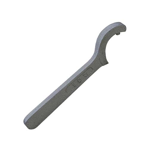

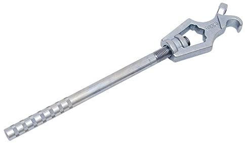

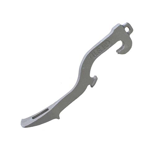

I also need some kind of spanner wrench to work the collars on the hand line and on the suction line. What do the pros use, and where would I get them?
Thanks again!
   / Good morning!!!! #118,695
Man I wish you were closer. The attached pics show a spanner for the booster hose, and a standard spanner. 5C9CCB60-7220-459E-96D4-40DBD585BA6C.jpeg. This one is a hydrant wrench with spanners. Id open the lowest discharge and flush the pump, with it in gear. But I'd also shoot a bottle of ivory soap in the pump first, and let it circulate. This should help pull the rust flakes out. Take the nozzle off your hose and flush the hose too.
Amazon has them, or The Fire Store, Grainger, etc.
