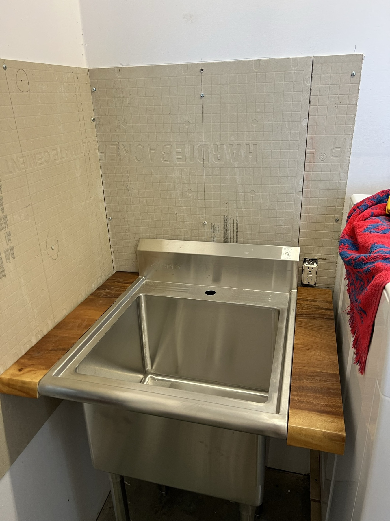

She did opt out of Cherry Blossom Festival due to the rain. That means I should get laundry tiled today.
Will be starting after another coffee

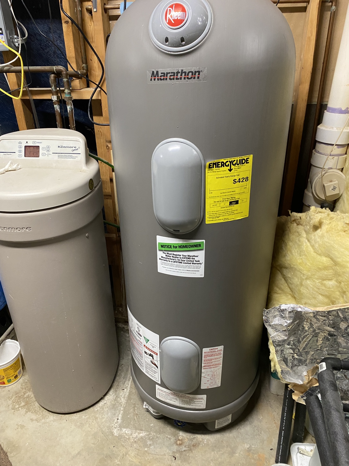

Plans sure changed in a hurry this morning when we had no hot water.
Washed hair in freezing water, went and got hair cut.

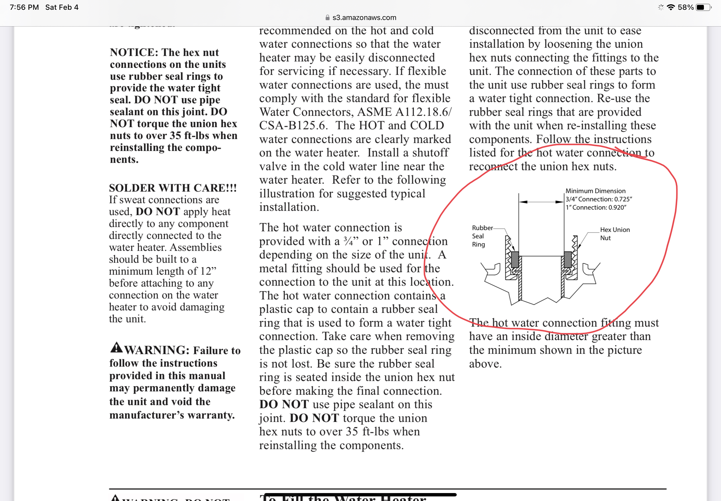

Home Depot carries my brand of water heater, but the marathon elements are apparently larger than the normal size. My socket doesn’t fit, so ordered a dual size socket. Ordered top element on Amazon, comes tomorrow but socket comes Monday.
Ended up going to a HD in PA that had a marathon water heater in stock and just bought a new one. I’ll fix up the old as a spare.
After getting it home, realized I needed nipples to connect to, so back to Lowe’s. Looked long time, only saw black iron and galvanized nipples. On my way thru appliances a guy asked if I needed help, and he was able to steer me to a mini section of brass fittings and I picked a bunch to try. A handful costs over $100. Used 2, rest will get returned.
It’s in and warming the water.
Tried taking a nipple off the old one, but something loosen up below the pipe I was trying to get off, even though I held the piece it was screwed into with a wrench and turned the nipple with pipe wrench. Now the whole piece wobbles at top of tank, so might not be able to fix it up.
   / Good morning!!!! #164,197
BEF, If I remember correctly the fittings on the marathon I installed are like a union nut with an o-ring inside so when you tighten the nipple it seals. Conversely when you loosen the nipple the fitting flops around and can spin, it may not be broke! Hope this makes some sense.
   / Good morning!!!! #164,198
Yes, there is an o ring under the nipple. But it shouldn’t be loose where it is loose, the nipple should have come out, but it didn’t

Plumbing is not my favorite thing. I bought some new ball valve shut offs to replace the gate valve type, but with all the running around today, decided not to go cutting pipes and soldering.
