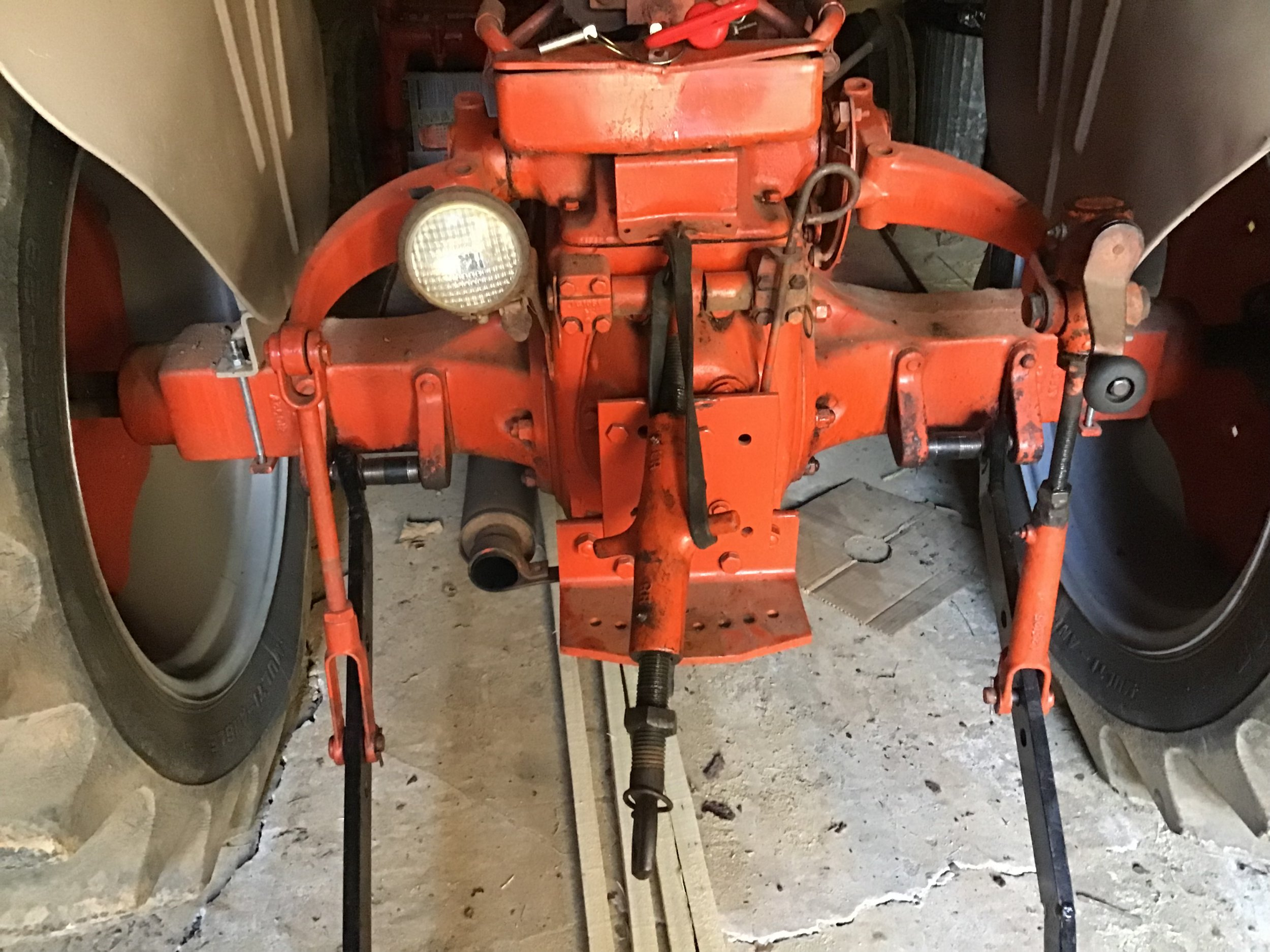

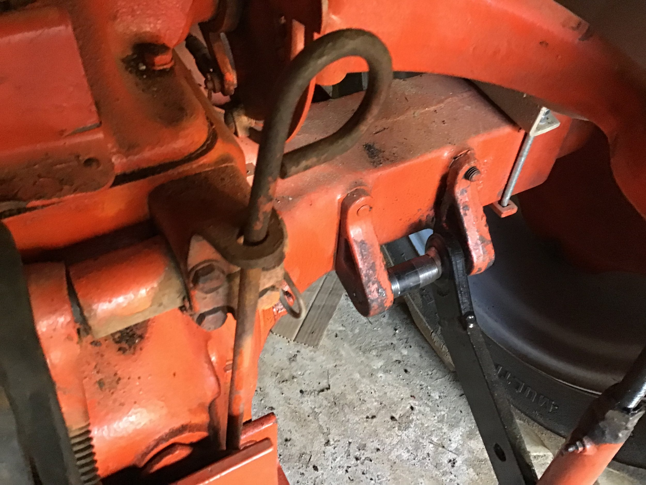

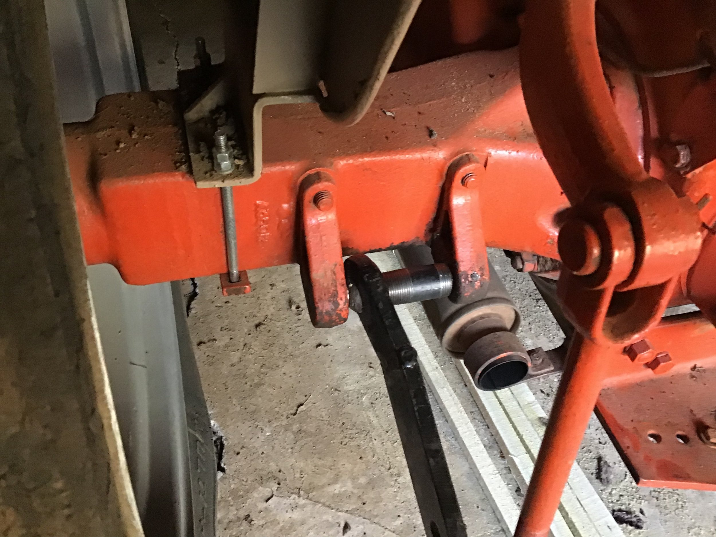

I got some photos of my lower arm modifications from a couple weeks back for your critiques (Planck iron pipe nipples as spacers on the Case Eagle arm shafts to keep the Fergie-style arms outboard for triangulation/stability):
View attachment 788442View attachment 788443View attachment 788444
I am sure there is some sorta superior solution, but this was under $10 and about 20 minutes. And now I just need to go and try it out one of these days real soon.

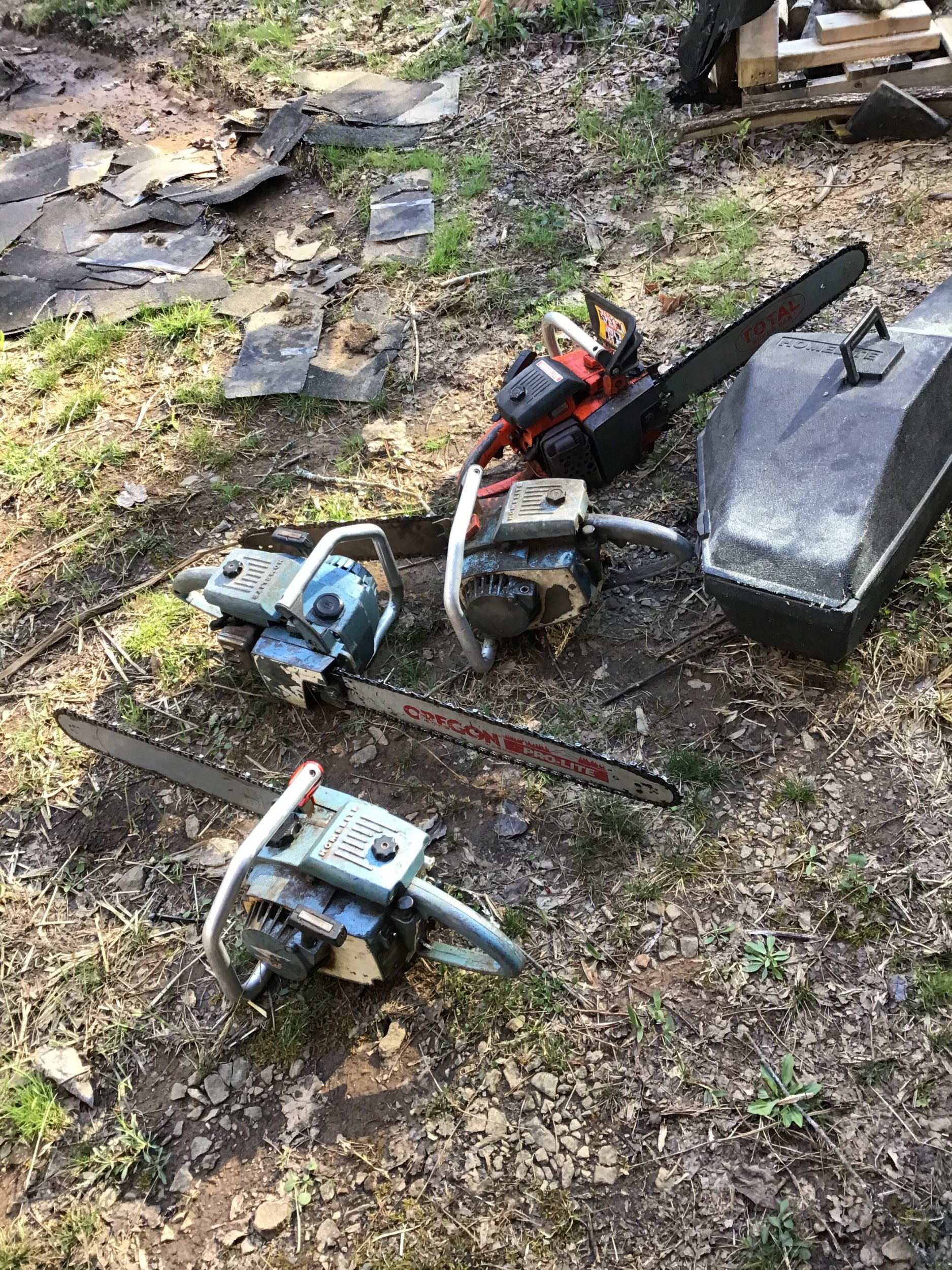

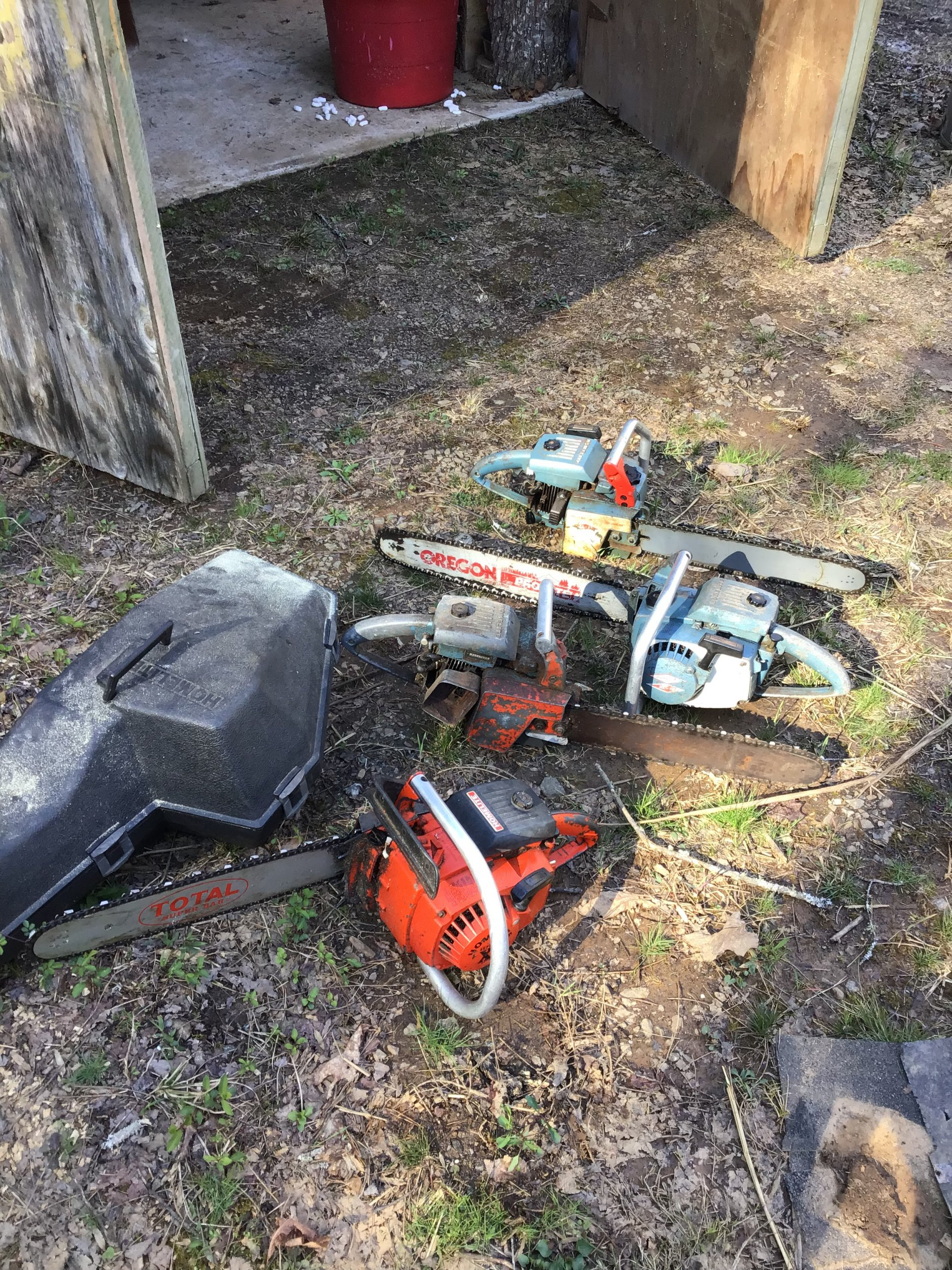

Finally, here are the “new” chainsaws, pictured with my former “PROPERTY OF UHAUL” saw next to a Jen-U-Wine Homelite saw case:
The one with the Oregon r is the best-running of the three, the one with the shorter bar needs the fuel line to the carb replaced (it is cracked), and the two-tone is a parts saw. All three for a C-Note. View attachment 788447
Movie Trivia:
The saw used by the character Leatherface in Texas Chainsaw Massacre is a Homelite SuperXL12.
I would flip those lift arms over to get the angles working better for you.
Would it make that much difference? The width of the implements pins are pretty much standard, no?
(I really dont want to have to pound out those pins again 🤪)
   / Good morning!!!! #166,305
Look at the angle the pin eyes are at, both ends are angled and not getting the ball ends squared up in the arms.

Kilroy, without seeing what the stock OEM parts look like, I can't judge. But I'm worried if you tug on those pipe nipples much, they may fail. Lower Arms are predominately in tension, but if backing up a blade, they are in compression which gives a different force.
