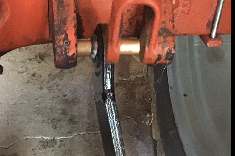

Look at the angle the pin eyes are at, both ends are angled and not getting the ball ends squared up in the arms.
I guess I am beating out pins again. . . 🫤

Kilroy, without seeing what the stock OEM parts look like, I can't judge. But I'm worried if you tug on those pipe nipples much, they may fail. Lower Arms are predominately in tension, but if backing up a blade, they are in compression which gives a different force.
Short version: the nipples are spacers, the arms are on 3/4” pins.
TL;DR: (with edits )
The factory Eagle Arms pivoted vertically on 5/8” pins (that I bushes up with copper pipe to fit the 3/4 ball ends) that are between the mounts.
I have the replacement arms mounted with them, and the pipe nipples are merely acting as shims to keep the balls from sliding along the pins, since it is about a 3” span between the mounts, and the starboard side arm kept wanting to slide inboard, and that made it a square and very unstable. By keeping the ends outboard, it is trapezoidal and *should* keep the implements centered. My biggest concern is with the rear scoop, which kept shifting the frame into the starboard tire and I really don’t want chunks taken out of the tire!
