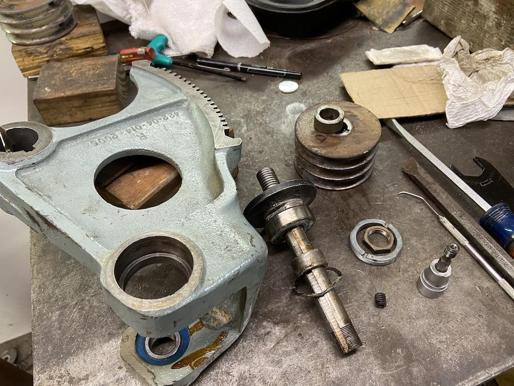

Tore down arbor for close inspection and deep cleaning, including more removal of contact cement (of course ... :rolleyes: ):
Pulley set screws were seriously over-torqued, couldn't break them loose with a T-handle wrench even after penetrating oil overnight and heating.
HF hex bit didn't have enough reach to engage the set screws so I took a punch and beat out the bit portion a little from the drive end which gave me enough reach to to engage the screws. B & D electric impact made short work of removal after that.

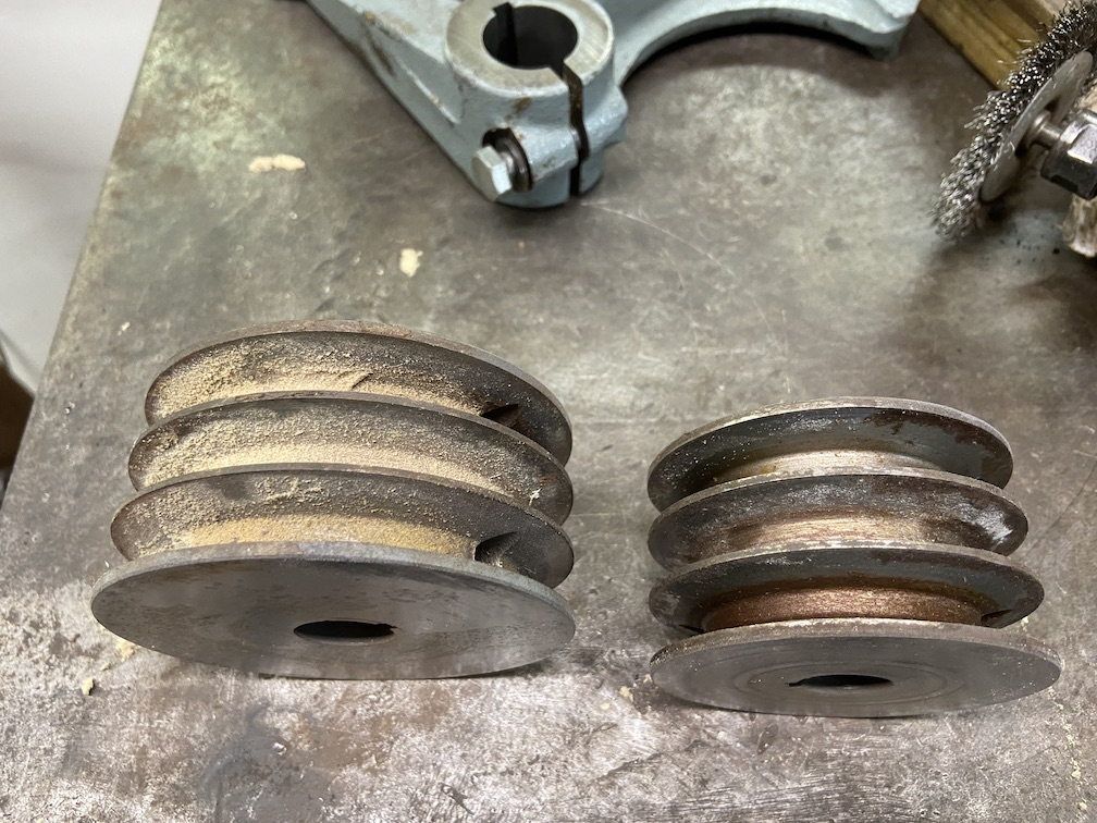

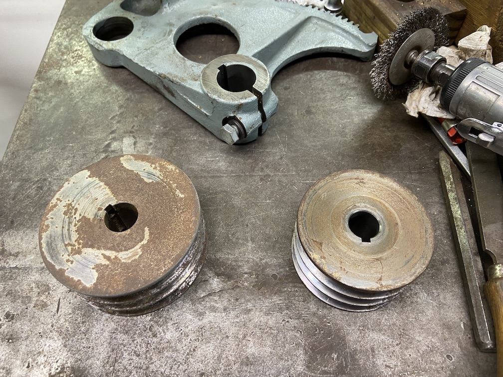

Both the pulley for the arbor shaft and the one for electric motor were a little scruffy:

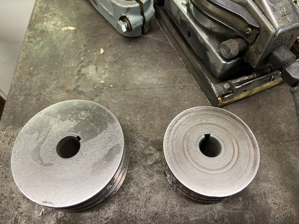

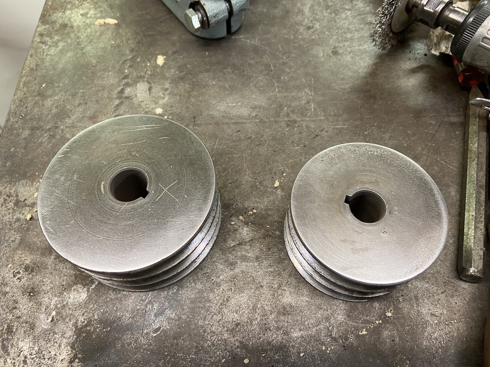

... so they got the clean up treatment with the jitterbug sander and a couple of wire wheels in a die grinder, after scraping the heavy crud off them with a razor blade:

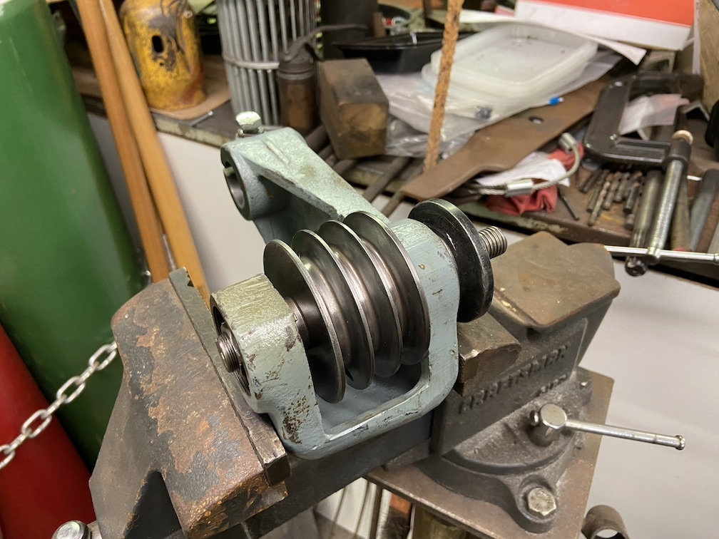

Both bearings seemed good so I reassembled after that:
There may be an issue with some wear on the shaft where the blade rides. If that turns out to the case, I do have a "spare" used arbor I got with the parts I picked up the other day that is in better shape on that portion of the shaft. It needs new bearings ... but those came with the arbor ... ;)

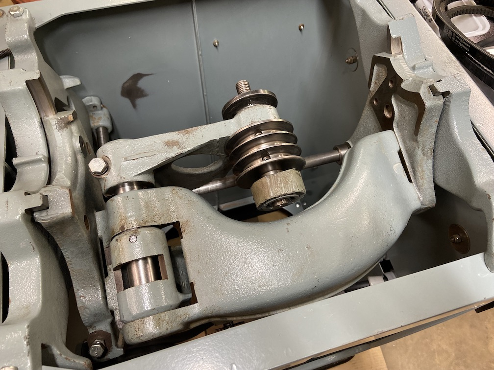

After that I got the arbor assembly reinstalled on the saw:
Also got almost all the parts for the tilt shaft assembly installed but was missing a 3/16 x 1 1/8 roll pin that apparently got lost in the process. So will have to run down to the corner hardware store and pick one up so I can finish that up ... after I get a fire going up in the shop to warm things up.

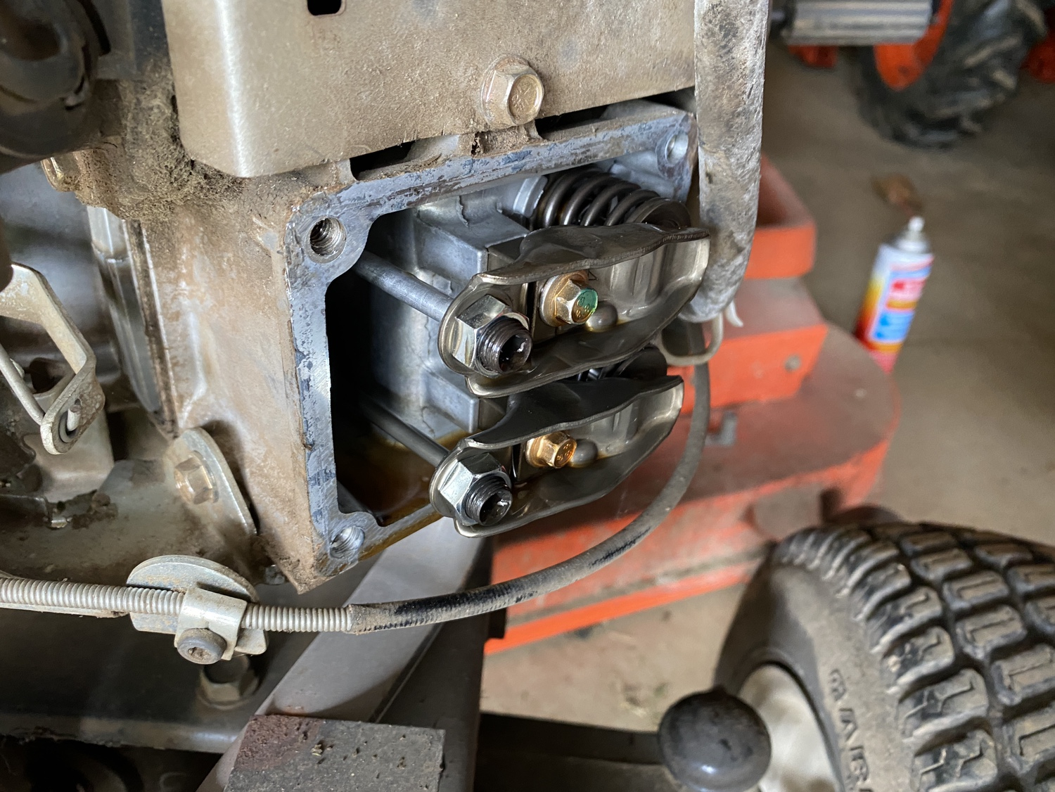

Took valve covers off the mower
Everything looks ok.
Removed deck belt and turned with a wrench, and valves all went in and out like they should. At least cam gears still intact. Pretty sure I saw the bump from compression release, but not 100% sure.
Hooked everything back up and the engine started. Had to give it a shot of carb cleaner like I have for years. Wonder if broken compression release could be cause? So not sure what was stopping it from turning, maybe there is a compression release broken, or maybe hung on starter motor gear.

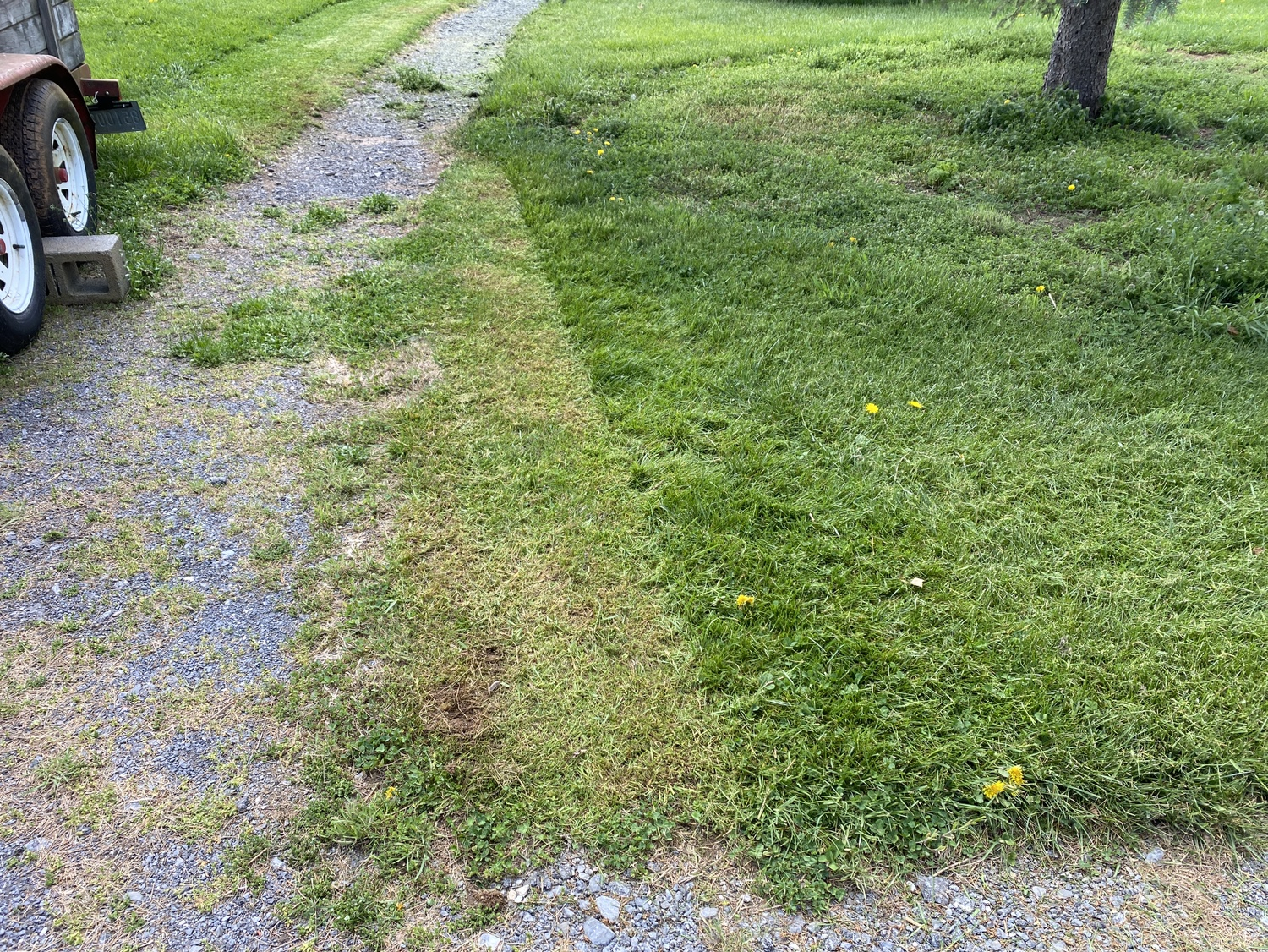

Mower deck is messed up. Left side lifts much higher than right. I adjusted right side way up but still too low.
But I mowed a little bit to try it. With deck all way up, it’s scalped the ground. I think the lift arm from left to right got twisted, will have to check that out more.
But it ran and mowed.
Need new sealant on valve cover lid.
