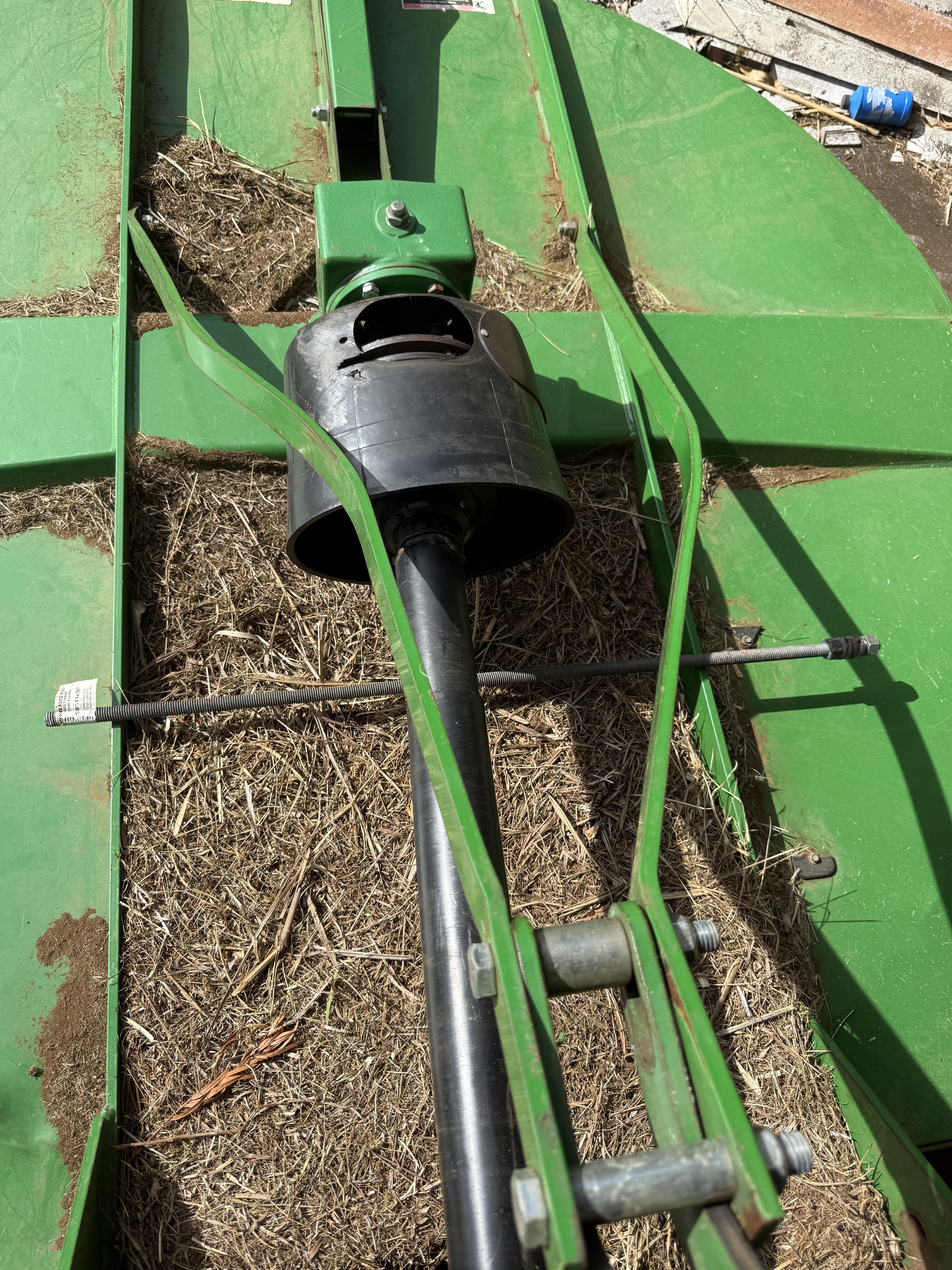

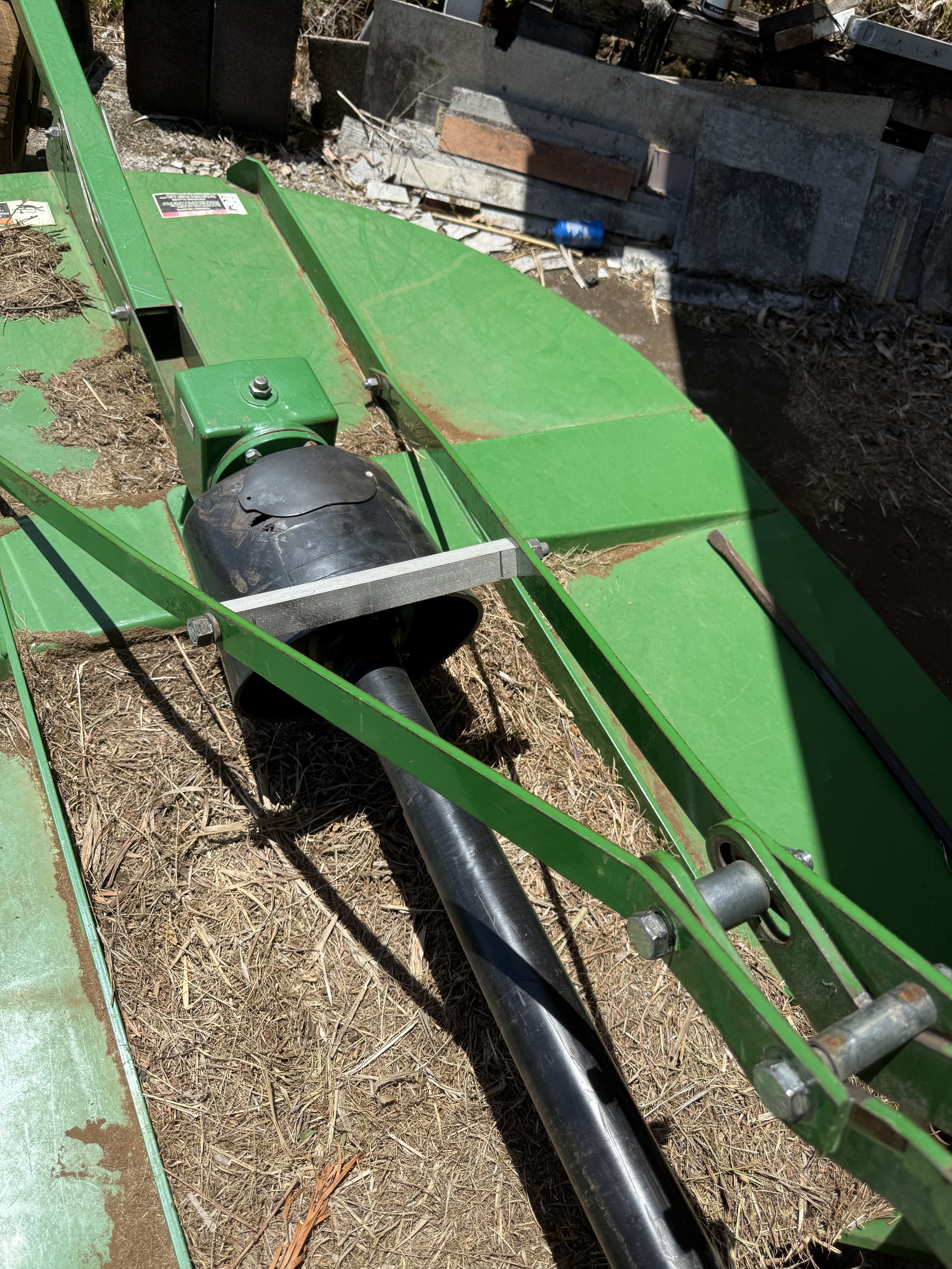

Guess I try to mow too much in reverse
Never had this with my Rhino rotary.
The back braces get bent
i have straightened several times
Today I decided to mod, added a brace, 1x1 square tube with 5/8 all thread.
Maybe paint eventually 😁
I couldn't see all of the top link linkage, doses it have a floating section that folds when the tail lifts?
   / Good morning!!!! #205,766
I think that you are at the root of the problem. A 3PT hitch and attached implements are designed to be pulled not pushed.
Unfortunately have some slopes I can’t drive up (definitely not across) and reluctant to drive down.
Will have be be more gentle.
