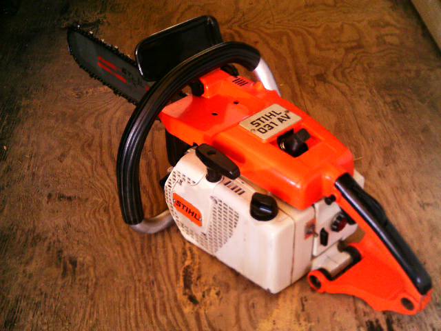

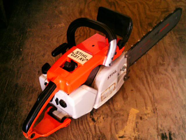

I might be going up north tomorrow to have a look at a pretty nice looking 031AV ... has been gone thru, had the base gasket delete done, condenser replaced - it's not an Electronic like my old one - but seems to be in pretty good condition ... at least in the pics:
Only has a 16" bar on it but supposedly a near new chain.
I'd be careful to check parts availability on any older Stihl saw. I had an 032AV and it was getting to the point that maintenance items like air filters were no longer available from Stihl. Sold it and purchased an MS271, big mistake, sold that at a loss and got a used MS261, an ebay nightmare that worked out. I don't like the new breed of computer controlled saws for the same reasons I don't like the new breed of computer controlled cars and motorcycles, and I'm a retired IT professional!
