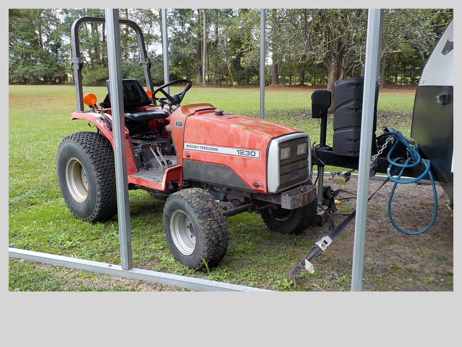

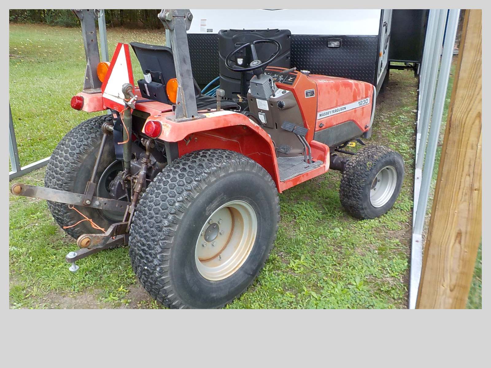

Home and happy. Chased in by a rainstorm, about to go back out and work on Carryall.
I washed the "big" Massey thoroughly and air blasted it, now need to relube the normal spots.
It will be a fine day screwing around in the barn.
