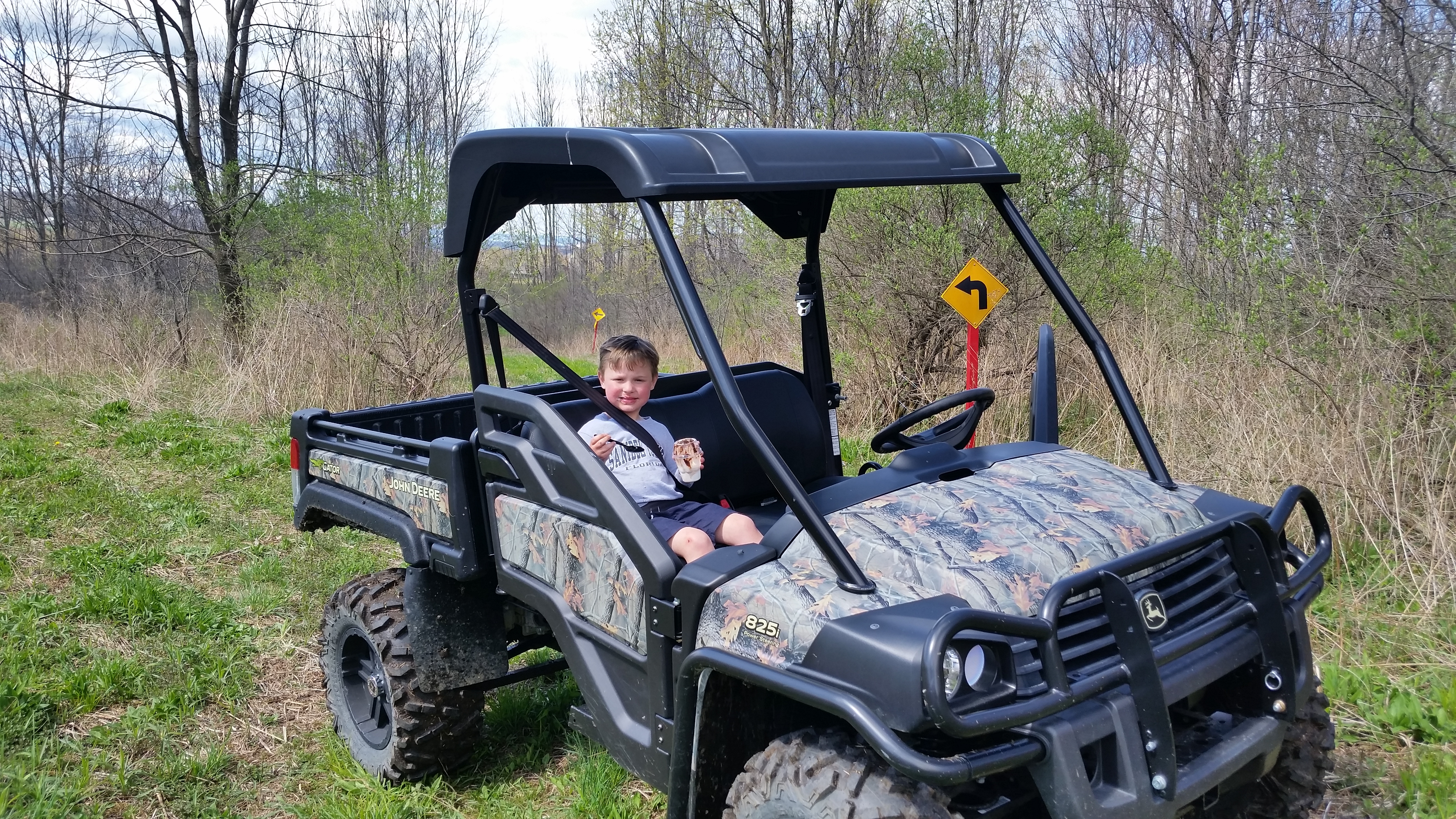

Looks like I need that speed.....looked at my odometer today....I've got 289 miles and 88.9 hours....all that speed is being put to use.:laughing: 99% of the use it gets is either driving a fence line in crazy terrain or plowing snow, when I go on the trails I do take advantage of the 44mph speed but it seems like it doesn't happen much these days.:ashamed:

took my 5 yr old grandson for a ride in a new 825i yesterday after work. we found some trails and he had a blast, kept
asking why i didn't buy one. i told him because we have a good machine already (an older HPX) but he thinks our
gator is too slow and bumpy so i should just get a new one!
