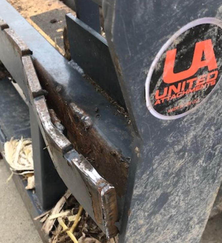

Being that the weld in question is where most of the force is applied, I would weld it different. It is on the rounded corner of the tubing and it is tough to get deep there. I would be burning some 6010/6011 down there for a root pass.

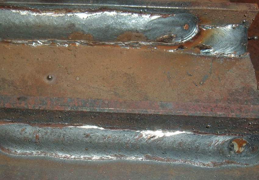

Hot and toasty. Even though this is short circuit its well melted from the root out to the toes. Hot enuf that it really doesnt ripple. Pic 1 Hobart 210, pic 2 my 255 red pos, was chasing the spatter. Can see the stop and 1v change to try to get rid of it.

Looking at the op pic, there's squat for weld on the sq tube on the right hand side. Hurry hurry, time is money. This one slipped by QC. Having seen some pics of their work, that example is not the norm.
Dem little nubbins you calling spatter is really anchor points for putting nice piping on top. Set hotglue machine to fluff & fill and pile.

sometimes when welding dissimilar thickness metals - like the thick top rail of a fork frame to a thin wall tube, it may seem like you are fusing the metal well, but in reality, if you are too low on the heat it may only be melting in to the thinner metal, and just laying in against the thicker one. I'm not a pro - just a low-brow fab hack so i always try to double check to the best of my ability - I find the easiest telltale signs that i got decent fusion are good heat discoloration on both metals joined, and even a little undercut, while not desirable, will tell you that you are probably burning in ok. Since I'm one of those guys who knows nothing and use to sit behind a desk and punch numbers all day (now i sit behind a desk and tell others to punch numbers all day) I might decide that i only need 7.3829673103 inches of weld, and since you have 4 feet of weld, a few questionable spots probably won't hurt - that's how I operate on my home projects.
as it was so elegantly put, it's hard to tell after you decorate the cake, but i'd probably trust in the quality of a known manufacturer and their quality control catching anything that might be a real concern. That may appall the safety police here, but also remember that safety is not only in the build of the item, but also in its use. most large and smart companies try their best to make sure that nobody is in harms way when an item like this is being used. accidents will always happen, but if you make sure that people are out of the way in the event of a failure, hopefully everyone gets to walk home. nobody wants the cost of material loss, but it's better than losing a person.

No, this is a pic from everything attachment. I致e been in the market for a grapple for my track loader. They are very expensive compared to other grapples by 2.5 times. They post pics of welds and I could only imagine theyæ±*e good. But this just looks very uneven to me as you look down the seam.
I find myself just looking at welds on things anymore.
Typical manufacturer squirt gun job. I would not buy that implement. Had one like that on a Kubota attachment, broke first time I used it. No evidence of fusion or penetration on either side. Made them replace.

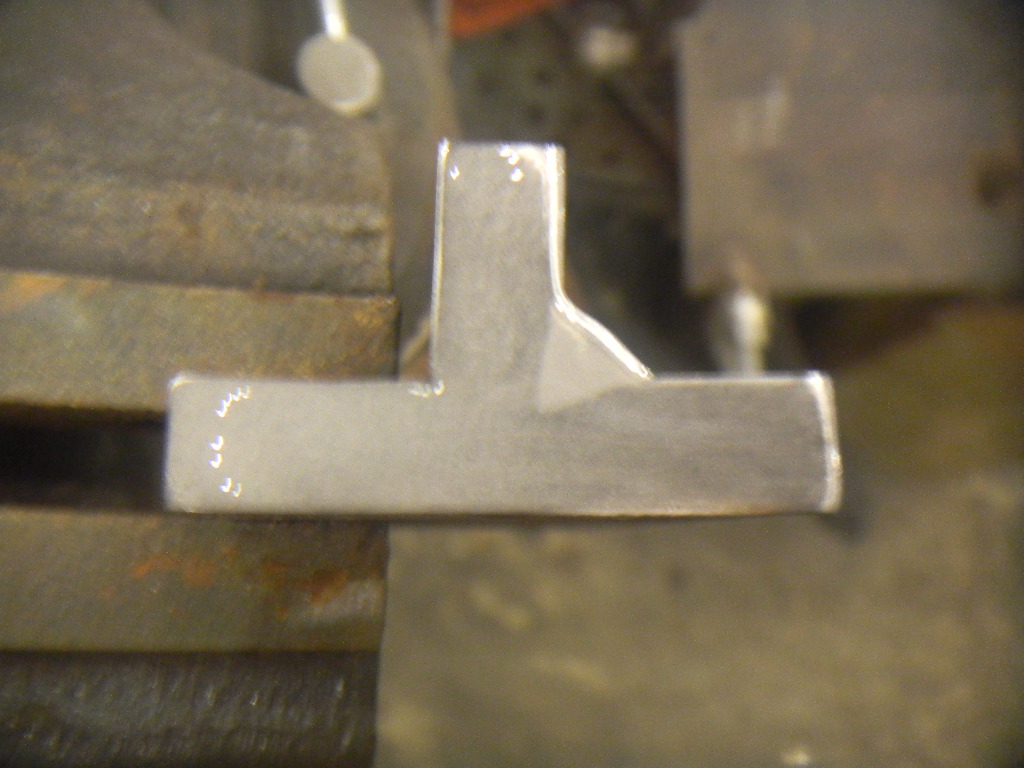

Here is what a Mig weld can do on 3/8-inch thick steel.:cool:
