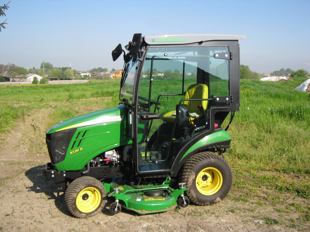

about 1026R I've found out this nice picture with cab :drink:
Tractor cab for John Deere
#cab
