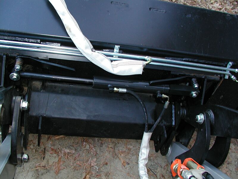

Ok Kevin, Mike, MossRoad & Charlie, here's the pictures of the hydraulic FEL quick-attach.
First, a pic of the hydraulic cylinder portion of the quick-attach system. The cylinder is installed horizontally between the two locking pin actuating levers. The cylinder extends to lengthen the pins and lock the attachment in place. The levers you see are just like the levers that operate the pins on the manual system, so it can still be used if there is a failure in the system. The hoses you see inside the protective sleeve laying on top of the bucket are the 4-in-1 cylinder hoses, removed from the quick-connect fittings at the bottom right so you can see the QA mechanism better.

Oops, let's try that again...

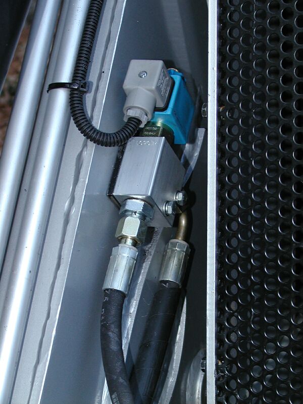

Here's the other end of the hydraulic portion of the hydraulic QA system.
The hoses that control the QA cylinder are inside the protective sleeve that goes between the two quick-connect fittings for the front auxiliary circuit (this circuit powers the 4-in-1 bucket and other front mounted attachments, like rotary cutters, etc.)
The hydraulic quick attach system is powered by the front auxiliary circuit, using an electric solenoid, so the original front auxiliary circuit tubes had to be replaced with ones that have fittings for QA system, which you can see near the center of the picture.
The solenoid is mounted to the loader arm near the top of the picture.
Coming out of the top of the solenoid is the wiring harness that supplies power and ground to it.

Here's a close-up of the solenoid valve.
