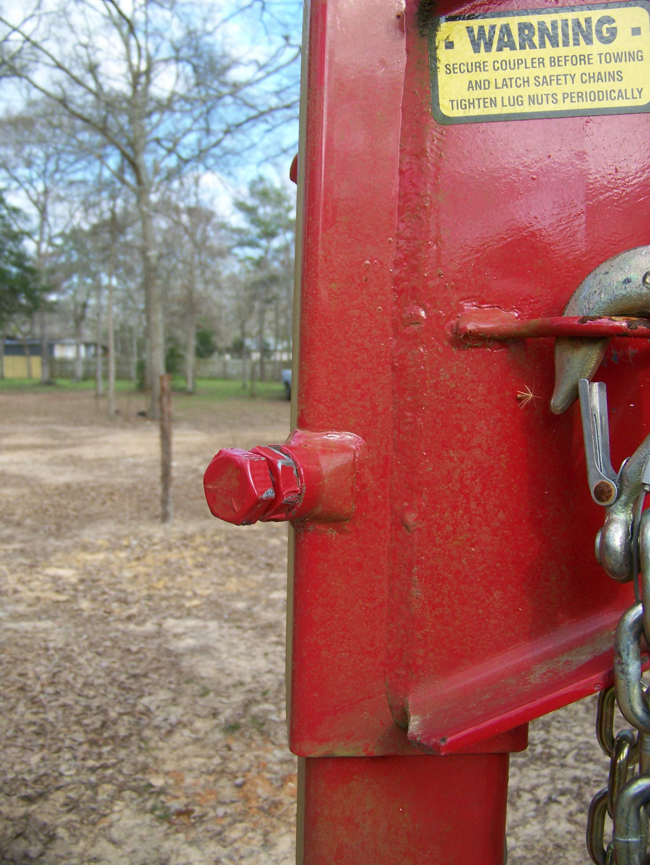

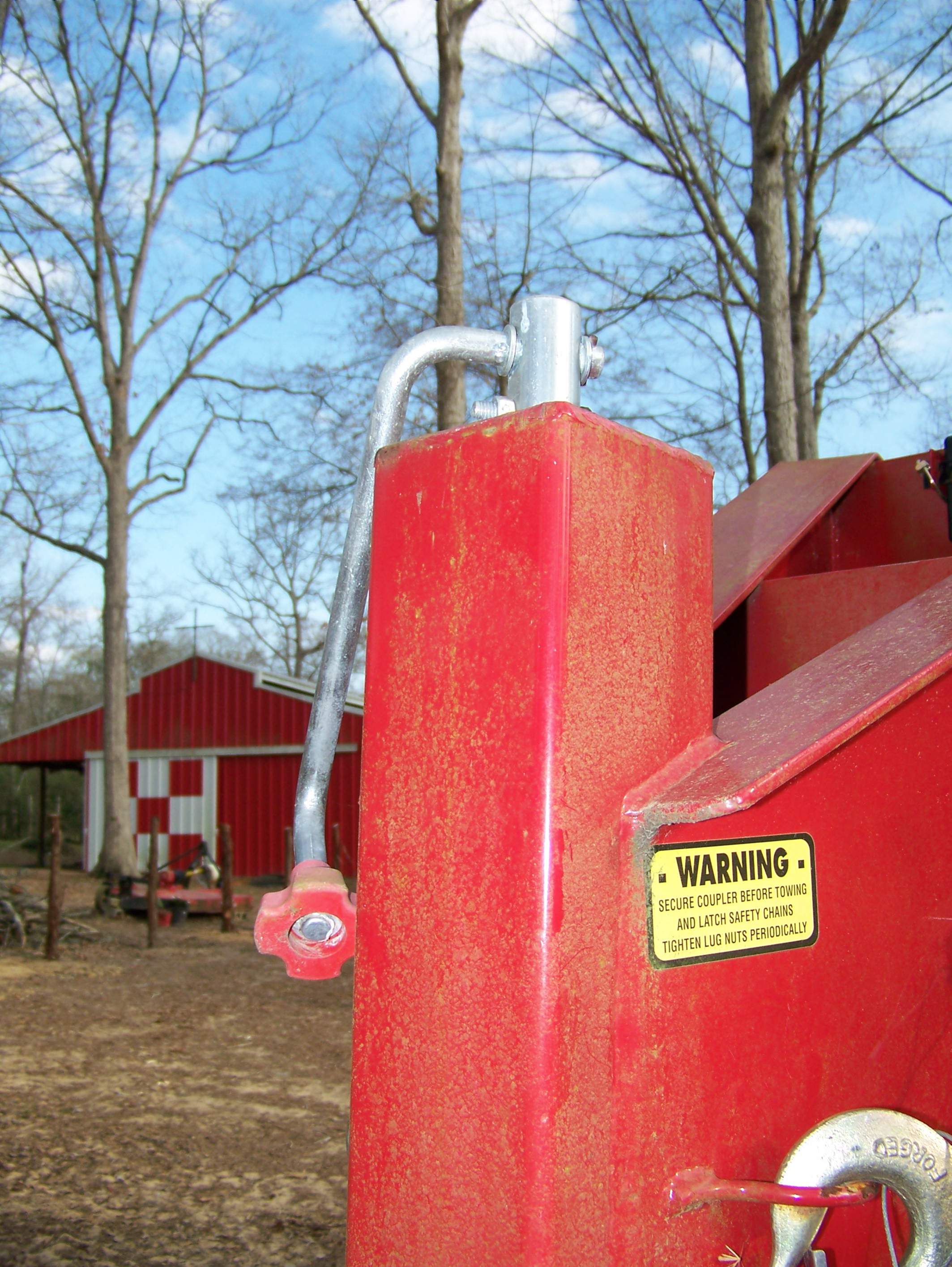

If your worried about a GN hitch hitting your truck bed, you can extend the adjustable coupler. My old GN lowboy had a lockbolt and just a pin and clip to extend or retract the coupler up into the GN hitch. The coupler on my Top Hat dual tandem GN has a lock bolt and a jackscrew crank to adjust GN height above the truck bed or to level your deck better. Top Hat GN Coupler Adjust Crank.jpgTop Hat Coupler Adjust Locknut.jpg
I like my coupler adjusted high enough so I can walk behind the truck with out ducking while the GN is hitched up.
