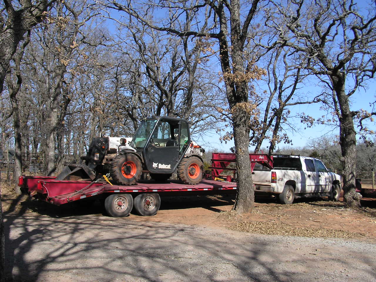

I'm up in Willis. I will never buy another bumper pull for anything again. Love the gooseneck sit up too much to change. Smoother ride and more stable.
Come up to Willis and try my rig. 4-6-13 Trailer, Disc, and Big RED Beast.jpg3-1-13 Truck, Trailer, Tractor & Grapple.jpg

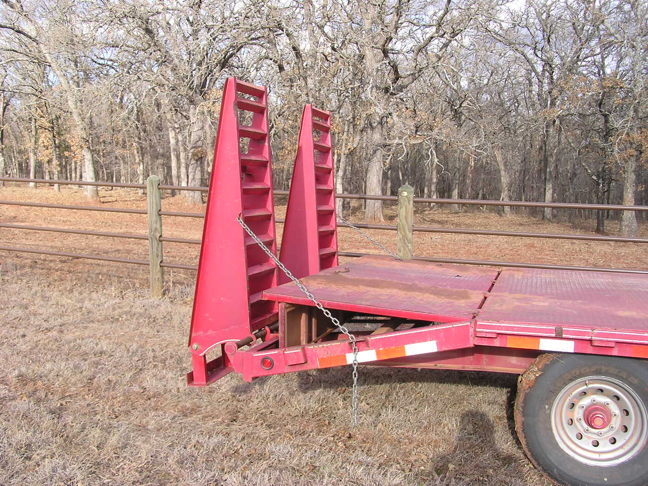

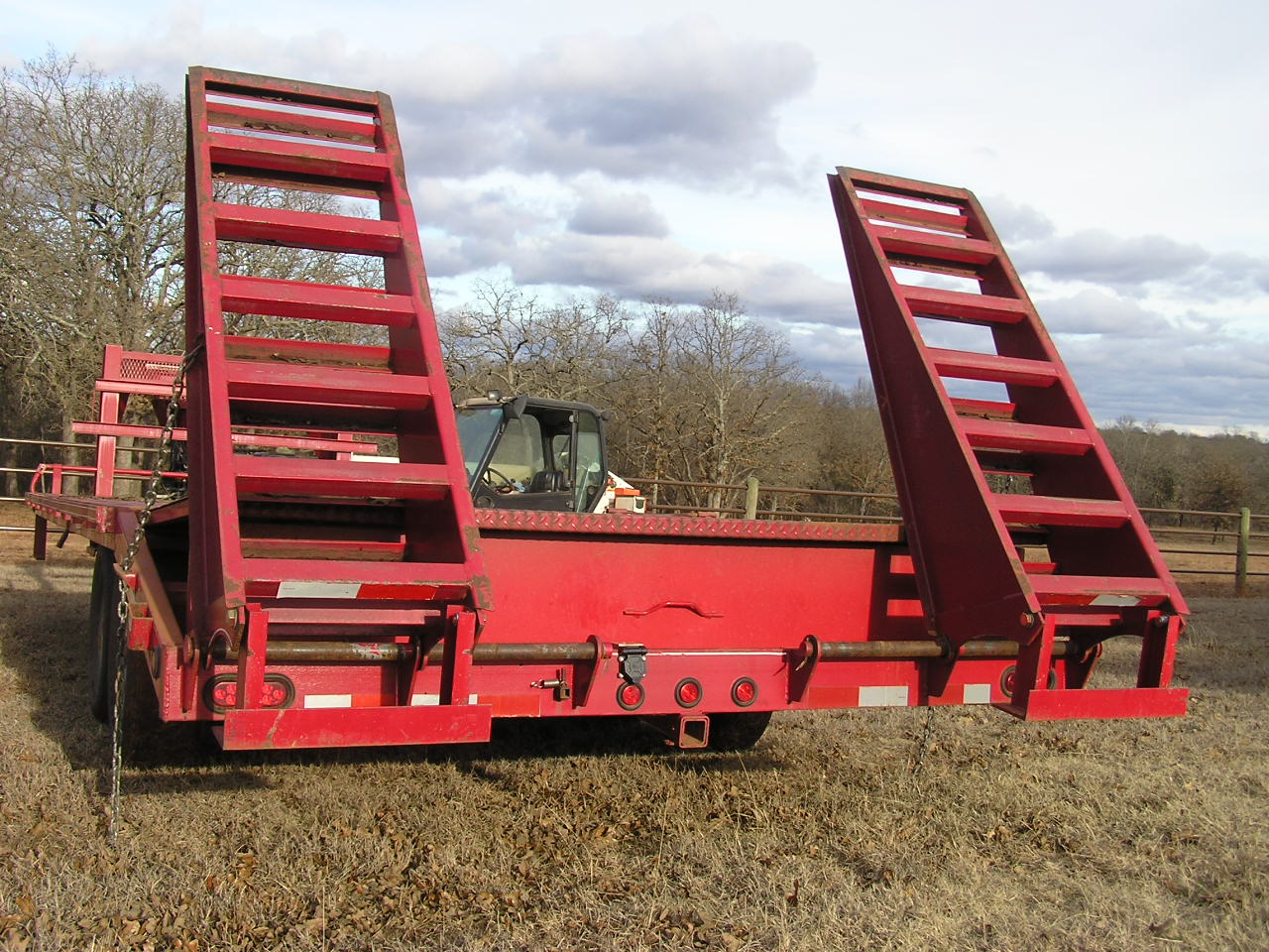

Here is a thread that will answer your next question, ramps? http://www.tractorbynet.com/forums/trailers-transportation/273476-stand-up-slide-ramps.html

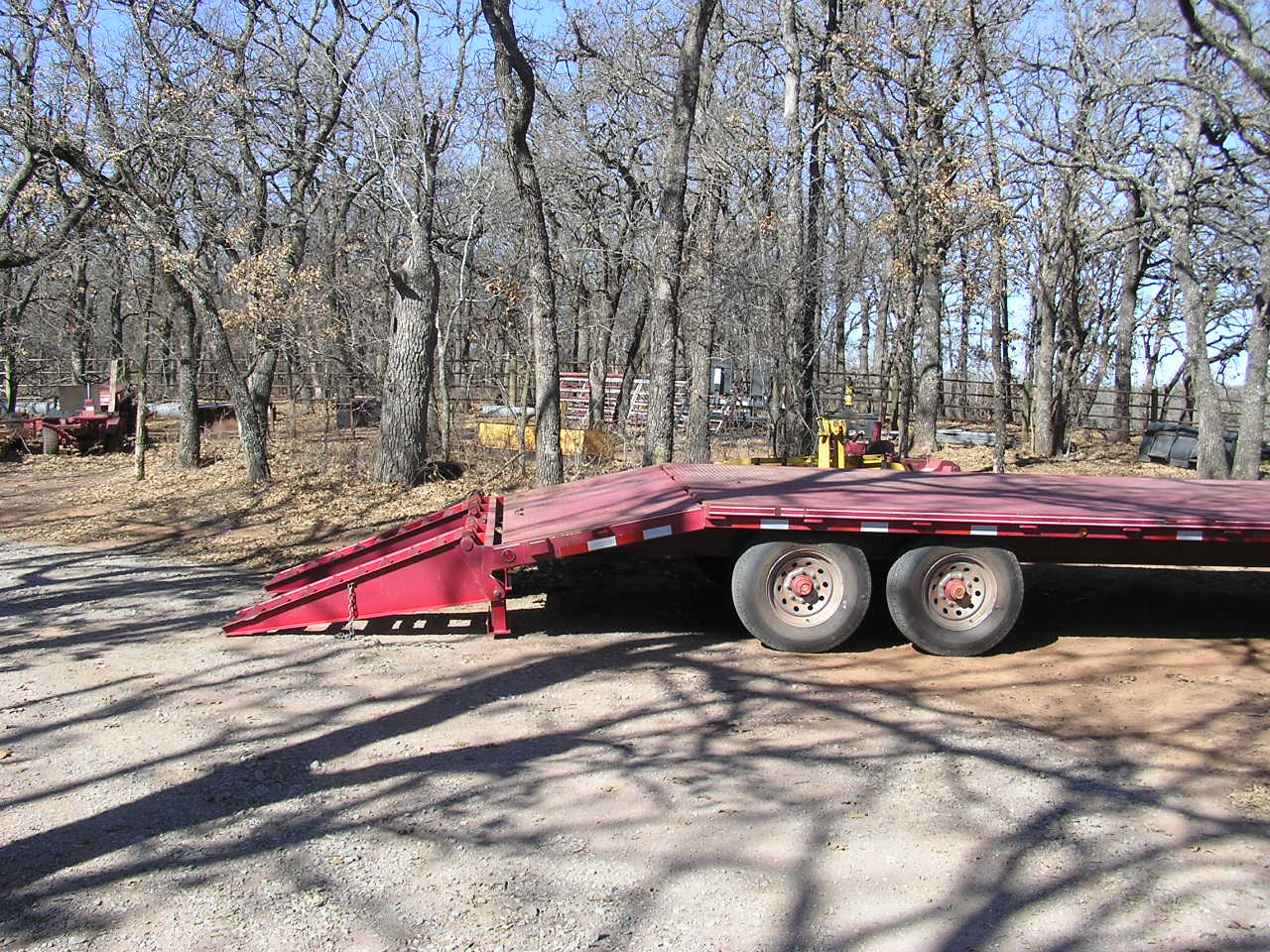

This is my 2006 Delta 14K 18' steel deck with the 4' pop up dovetail. It weighs 5K, 1k on the ball.

You should take advantage of the two offers here to let you test their rigs. Sounds like they both would be willing to load up their tractors and let you take em for a short lap.
