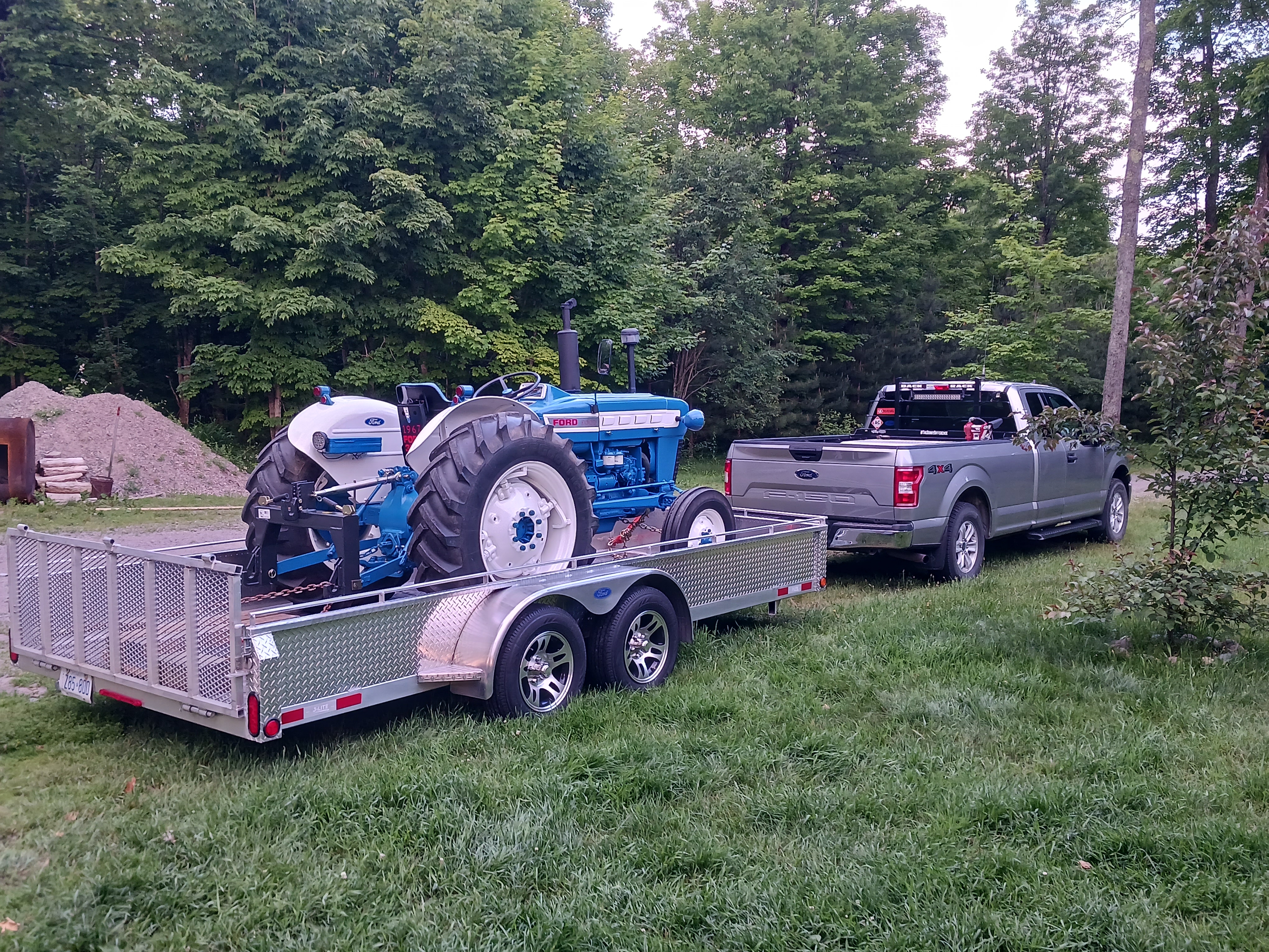

First off, I will say I'm not looking to haul big loads or weight. But curious about this.

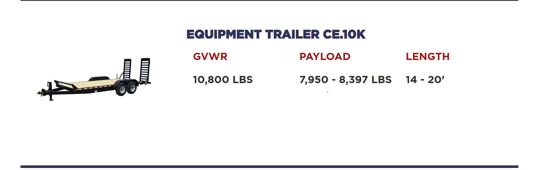

I just sold my aluminum tandem axle trailer because despite even having my welding shop add crossmembers and beef it all up, every single time I towed my 5200 tractor to a show, that trailer would have to go back to the welding shop for cracks. So I ordered a steel 10,800 pound bumper pull beavertail equipment trailer.
But it got me thinking, I've seen some goosenecks that aren't much heavier than the bumper pulls. But my trailer dealer said no way to buying a gooseneck for my F150.
Reason I'm curious about this is a gooseneck is SOOO much safer and better weight distribution than a bumper pull. If you look at what Ford approves my F150 to pull on a receiver hitch....no way I'd want to do that.
Anyone ever pull a gooseneck with a half ton? Like I said, I'm only looking to haul a 5200 pound tractor.

I disagree with this, and here is why.
The O/P says that he has a 5200 pound tractor that he is currently hauling with a bumper pull trailer. If it is safe and legal for him to pull that weight with his current F150, then moving the hitch point from the bumper to above the rear axle will make hauling the load so much safer it isn't even close! By moving it to a gooseneck, you have just moved the weight that was hanging off the back end, causing the front end to be extremely light, (which needs to be heavier in order to have traction for the front tires so they can stop the vehicle) to about an inch in front of the rear axle center which makes the vehicle so much more stable, and puts the weight on the vehicle rather than pushing down behind it.
What most people consider with a gooseneck trailer is that they will pull more weight, because you can put more on the tow vehicle, which requires a bigger truck, so we see them being pulled by bigger trucks.
I say have the O/P go weigh his bumper pull trailer as to how much weight he has on the trailer tires, and then compare that to a gooseneck (adjusting for tare weigh of each vehicle) and my thoughts are, if he puts the tractor weight in the same place (again, allowing for the difference in tare weight), I imagine he will have a much safer combination towed vehicle. Now there are a couple things that might skew this a little, so he will have to actually go weigh both trailers while hooked up to his tow vehicle. Just pull across the scale and leave only the trailer axles on the platform. Do that empty and loaded to determine how much weight you have on the trailer axles themselves. When you calculate how much the tractor is adding to the bumper pull, make sure it is adding the same amount to the gooseneck. What that does is keeps you from putting more weight on the tow vehicle when you change to a gooseneck. What you will end up with is a comparison of apples to apples and not apples to oranges.
i am pretty sure, if you graduate to a gooseneck, and keep the same amount of the tractors weight on the trailer, there won't be a huge difference in what your tow vehicle is doing, but it will handle it so much better because it isn't hanging off the back bumper, and the weight is being split between the drive axle and the steering axle.
