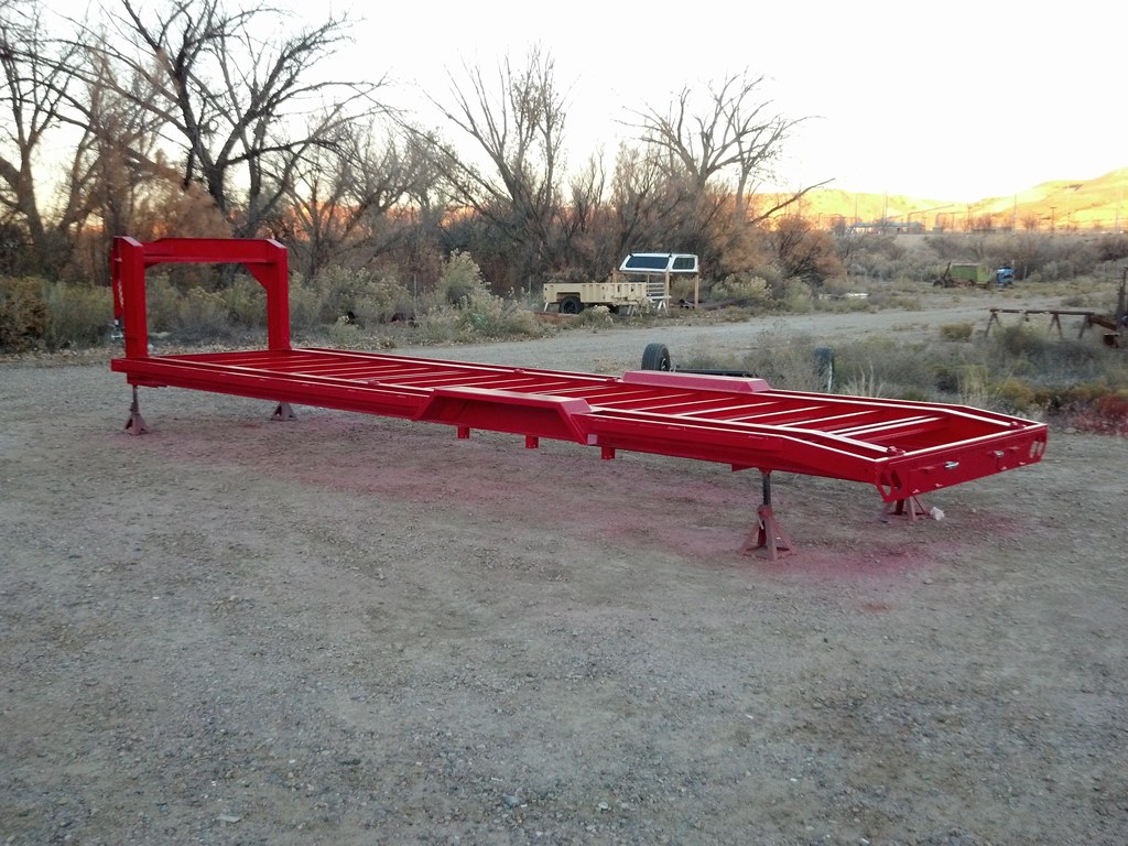

I realize that this is a fairly old thread. I have been lurking on the site for a couple of years but this is my first post. I was wondering if anyone knows what the distance was the builder of this trailer used between the 10 inch I-beams -- or center to center? I really like many of the things he did and I am getting ready to rework my gooseneck and I think my I-beams are too close together -- twin 7K axles, 31 foot long. Mine are at 50" -- I liked the way his looked but I cannot find measurements for reference.
Thank you,
Doug
/ Gooseneck trailer build... #69
I think 50" is about standard from all that I have seen. That way, each beam is supporting 25" of floor on EACH side of it (assuming a 100" wide trailer or there abouts).
Dont want to go too wide without heavier cross members. Some loads put alot of weight right in the center of the trailer. Tricycle-front tractors, Lowering a backhoe or excavator boom down, hauling a scissor lift ( which are usually pretty narrow).
I dont think I would want my beams much wider than the ~50" that they are.
/ Gooseneck trailer build... #70
LD1, thank you for the reply. My concern really is about an article I read about the distance from the spring hanger to the mounting face of the hub/drum/rotor. They were saying (can't quote it or find it right now) but something like not wanting more than 9 inches (???) distance there. I am not sure if that is accurate or why it might be true. If I use the 50 inches (and I agree that is fairly common) then the distance from my spring hanger to the face of the hub could be 22-24 inches. That is my biggest concern -- I might well be worrying about nothing.
Thank you,
Doug
/ Gooseneck trailer build... #71
If you go 50" with beams and from that add 22"-24" to hub face on each side then add the width of the tire the outside of your tires wont be legal to pull on the road. If you divide the 22"-24" by 2 then it sounds more logical.
/ Gooseneck trailer build... #72
If I understand your concern about the wheels being to far out from the spring, you will have to shorten the axle by enough to get the drums withing 9" of the spring. Just cut the axle and sleeve it on the outside to the required length.
/ Gooseneck trailer build... #73
Axle manufacturers allow a certain spring spacing in relation to the axle length. The wheels too far out the springs will cause the axle to bend.
/ Gooseneck trailer build... #74
Deere Dude, Thank you for your response. I think you and Renze understand my problem. The 50 inch outside to outside I beams mean I need 46 inch on center spring perches -- which means that there will be too much distance from the spring perch to the tire with the axles I have -- allowing the axle tubes to flex as well as likely adding too much stress on the wheel bearings. I finally just spoke to someone from Dexter who clearly stated that it would work "to a point" in that it would severely "de-rate" the axle by allowing too much flex that far out. He did say that if I call them with the serial number from the single wheel axle they could tell me how much it would de-rate the axle to change the perches to 46 inches on center from their current 80 inches on center. I suppose the other viable option would be as Deere Dude suggested to shorten and sleeve the axles but I cannot imagine how a single tire trailer would look or handle with the tires up under the trailer a couple of feet (towards the center of the trailer)!
I think I will either find a replacement dually axle or see if someone has found a way to modify their trailer underneath to change over from a 46 inch mounting point to an 80 inch mounting point.
My original question was does anyone know the center to center distance (or outside to outside) for the I beams the builder on this thread used?
Thanks everyone.
Doug
#75
Thanks everyone.
Doug
Sorry I missed this conversation Doug.
My beam spacing is 68-1/2" on center. This matches the spring pad spacing on the axles, which I purchased from Johnson's Surplus in MI. (Here's an ebay link to the exact axles I used, which have 86.5" hub face and 68.5 spring center distances.)
68-1/2" spacing put the trailer I-beams almost directly under the tires of a full size truck, which is the heaviest vehicle I intended it to haul.
You definitely want the springs as close to the axle ends as possible for best strength. I would have no issues welding spring perches farther outboard than the factory has welded them if I needed them wider, but moving them inboard from the factory placement will result in the axle bending easier, or not being able to hold the factory rated load. Going from 80" to 48" would cut the axle rating almost in half.
I would NOT recommend running springs at 48" on center on a trailer wider than about 6'. You need to get the rails spaced apart much farther for stability and for strength. 60" would be a good minimum, but the wider the better. Vehicles are normally the worst case loading, as they have all the weight on four points of contact. Having those points be directly over the beams is the right idea, IMO.
