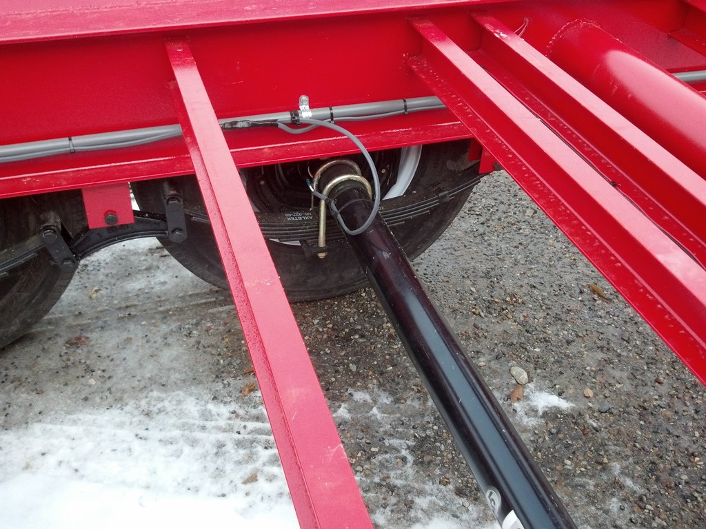

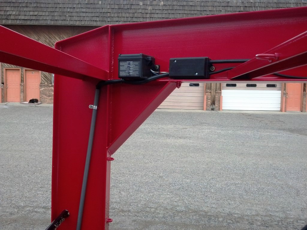

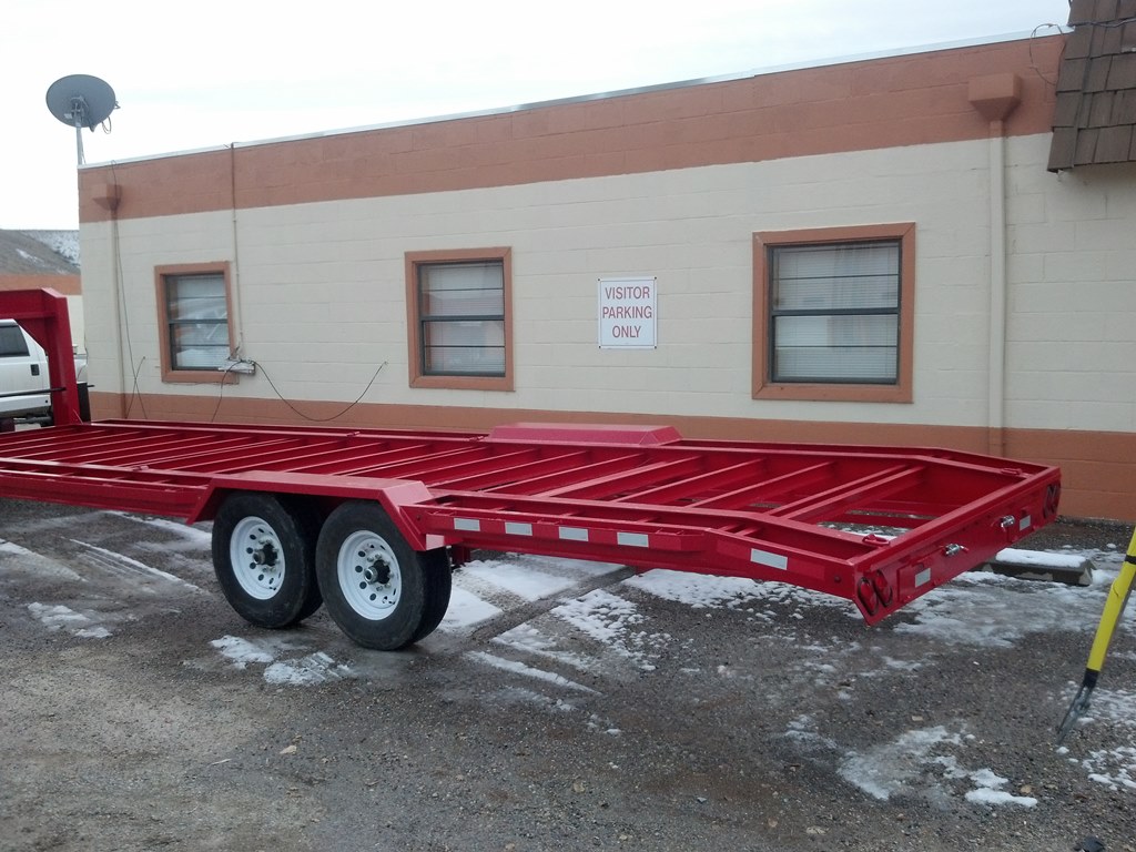

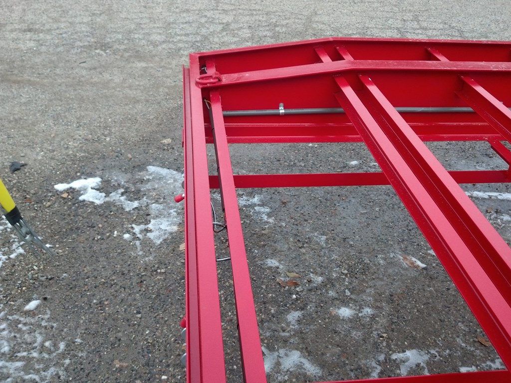

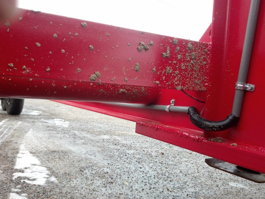

I got the wiring done last weekend. It's all run in PVC electrical conduit, so it can't get snagged and ripped off, hopefully...

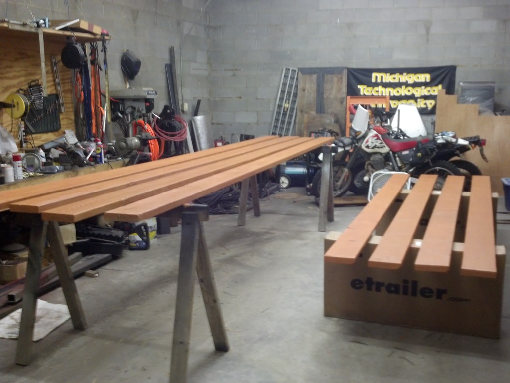

With all lights working, I headed out Wed to the lumber yard and picked up the decking. $260 worth of the crappiest pine (well, Doug Fir, actually) I've ever seen, and that's after we sorted the pile for good boards. Still cheaper than HD or Lowes, and it's just going to get beat up on my trailer, so it'll do. I've been treating it in the shop, eight boards at a time, with Thompson's Water Seal Solid. I wanted Gray, but you have to order and buy 4 gallons at a time. I only need one gallon, so it gets cedar, which is the lightest color I could get locally. :)

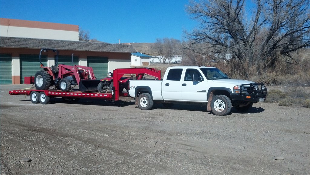

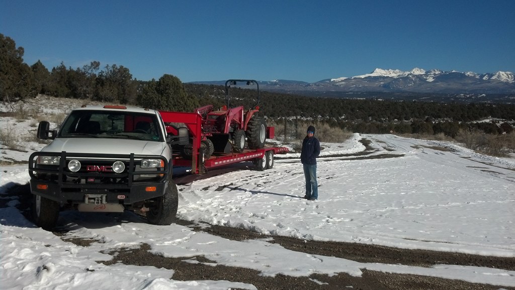

I spent Friday evening and Saturday all day decking the trailer so we could use it today to haul the tractor up to our property in CO and get started on the driveway. Got all but the center and outside boards on, but that was enough to use it today. Here it is this morning, loaded up for the trip. Might not be quite legal yet, but I plan to fix that Monday right after lunch. :)
It towed wonderfully. No shaking or bucking, no trouble at all, really.

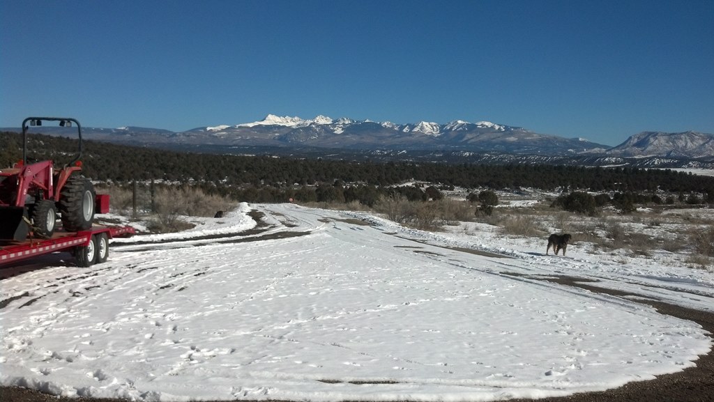

In Colorado
This will hopefully be our view by the end of next summer... Looking East at the La Plata Mtns.
And since this is a tractor forum, I'll add that the MF did great at getting our driveway roughed (really rough!) in. We could get a truck up to the house site now if we wanted. I was worried that the R4's would be horrendous, but it crawled around just fine. :)

I would not be able to get away with the wiring the way you have it on the axles. The gravel roads around here would beat that wire off in no time.What I do is run the wire down the springs and weld a deflector plate on the brake backing plate. I also use -40 degree extension cord for the wiring. At least then if a rock does hit the wire it doesn't shatter in the cold.
