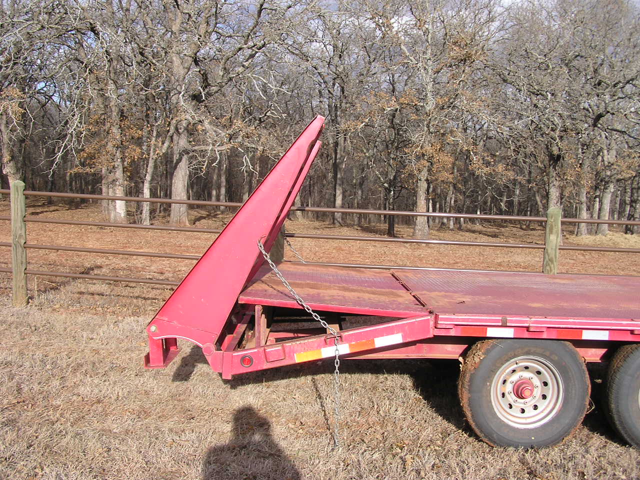

This deckover is a 14K, 22' long including the 4' popup dovetail, I bought it new, ten years ago:
The placement of the axle on the dually seem to be a bit further back than the single wheel unit that I looked at. It might not be reality, as I didn't measure it. My concern is being able to get as most of my weight back over the trailer axle rather than in the bed and the truck axle, as my truck is single rear wheel. The good news from a call I just got off is that it looks like I'll have access to dual axle 28' 20k trailer to try before I buy. Trailer is a bit heavier than I would go, but it will give me a good idea how my truck pulls what a dual.
