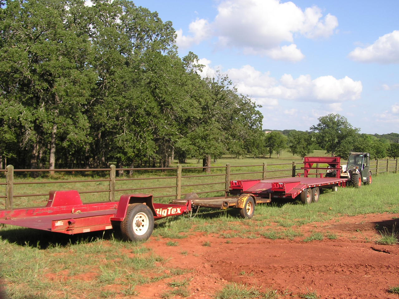

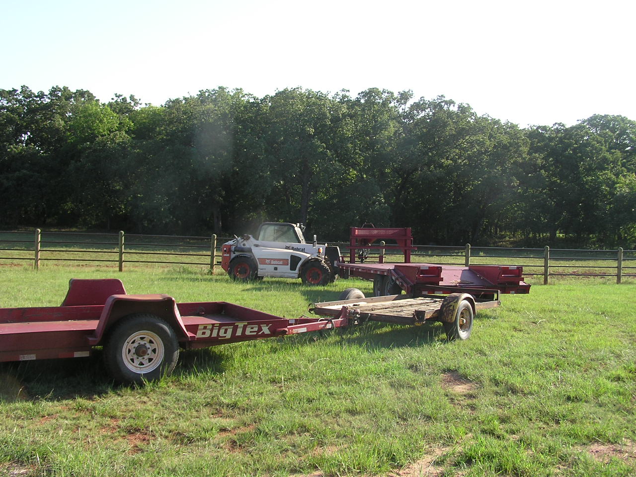

I'll use Xfaxman's tandem trailer pic as an example of GCVWR's importance. He probably met all of the axle rating standards. So he can keep adding trailers as long as he doen't exceed max length regs? :)
   / Gooseneck Trailer for m7040 #93
Yep. :laughing:
