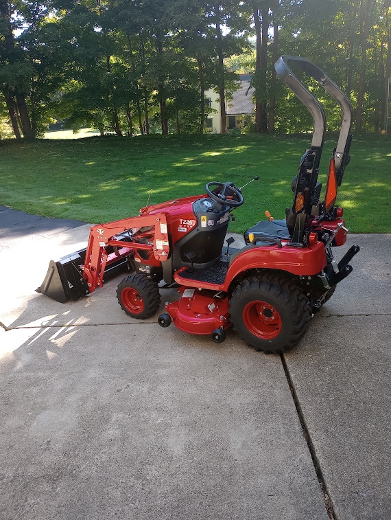

This little fella finally made it. It's awesome..

The only mod I've done so far was to the ROPS. It is so ridiculously high on this little machine that it's an absolute hazard on my property and impossible to get into the garage. The ROPS easily flips flat to the rear, by pulling two pins and removing the yellow triangle. I took a step further and put it in remote storage mode for now. Even the vertical supports with the light pods are well over 5ft high.
The auto throttle is pretty neat. The further you push the go pedals, the higher the engine revs, like a piece of commercial/construction equipment. The last CUT/loader I put any time on was a mid 80's Kubota 4x4 manual transmission. I was a kid working in a horse farm then.

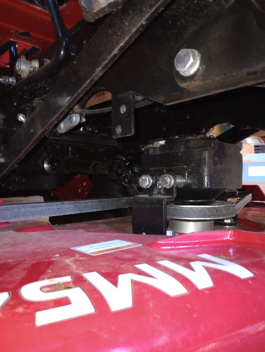

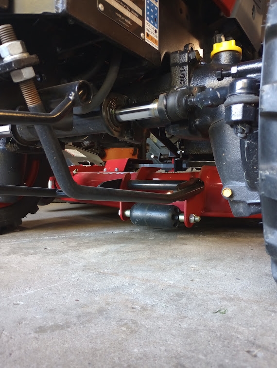

Have you taken the mower off? What's the view under the machine without it - is it the same as a unit that isn't sold with a mower?
I took the mower off today just to see how the process goes. It's not bad. I did it in the garage and simply slid the mower out sideways. It's heavy, but slides and rolls easily on smooth-ish concrete. In pic two a few posts above, you can see the two brackets used to support and suspend the front of the deck. Those brackets pop right off after releasing two spring loaded U-clips that stay on the nose of the tractor frame. For the rear, there's two U-clips that stay on the tractor, that are connected to links that go up/down with the 3-point. I forgot to pull the collar and release the deck driveshaft, so when I slid the deck out, the male splined end came out with the deck and the female end stayed coupled to the mid PTO.
