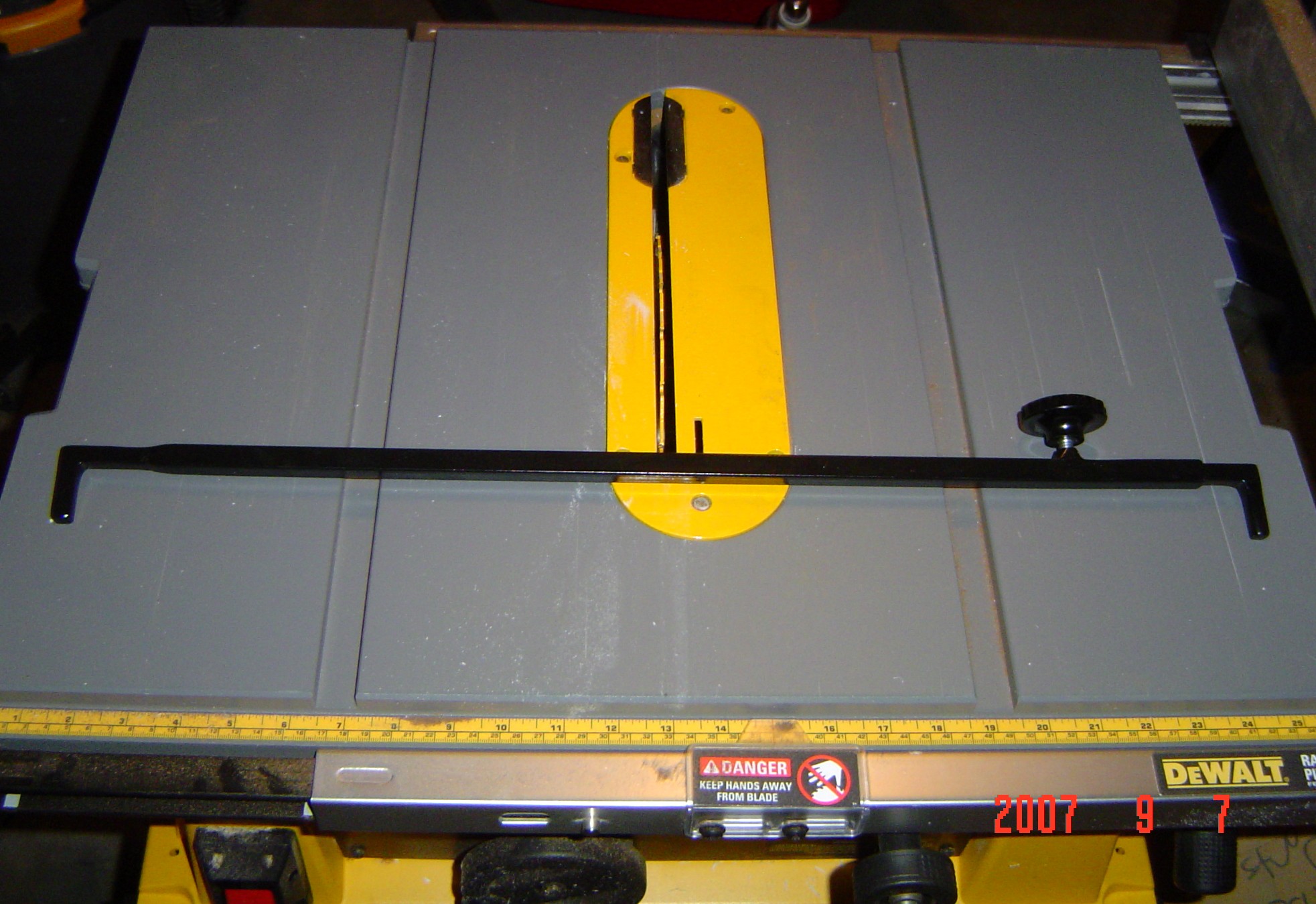

I did not get the spreader bar with my hitch so I made one. However, I have not had to use it yet. When I back up to an implement I can usually move the lift arms to the right distance apart and they will stay there long enough to hook up. If you think you need the spreader bar, go ahead and buy it. It is not cost effective to make a similar one.

I used a 3/8 inch turnbuckle too. Bought a piece of 3/8" threaded stock for the RH side. No matter which you use, Pat's or Home made..... it's pretty handy.

Emmy great job I looked at the pic, and had to go back an be sure , as I thought you said you made. it it looked like a factory production. hmm or even better.
