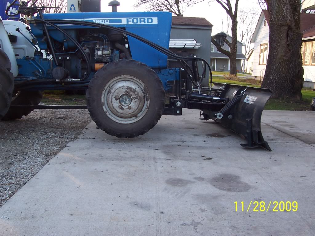

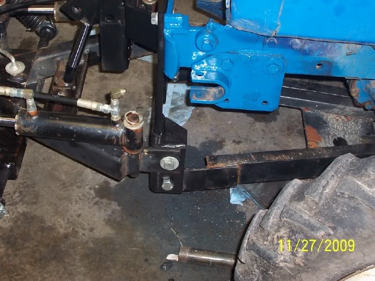

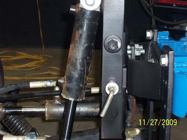

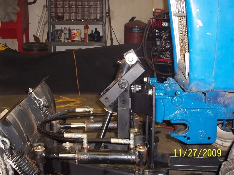

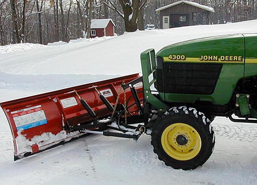

I would like to recommend that you align the angle cylinder elbows with the plow frame so they don't stick out in space. Sometimes ice blocks or "stuff" you find out there, especially when backing up, will accumulate there and yank off a connector. I'd also want to tape the jaw of the lift hook so the chain doesn't slip off. The way my stuff works, a chain on a hook is looking for a way to jump off and will find it unless thwarted by a careful insurance device. This way, you can sat that duct tape is in play here.... These are good plows, I have the same deal on my JD. I do like down pressure when backing up in reverse for scraping ice loose on the cement. I also have my trip springs maxed out because of the things I tend to hit on the fly (like raised cement joint edges, curbs, frozen blocks of snow, dead bodies and frozen dog poop).

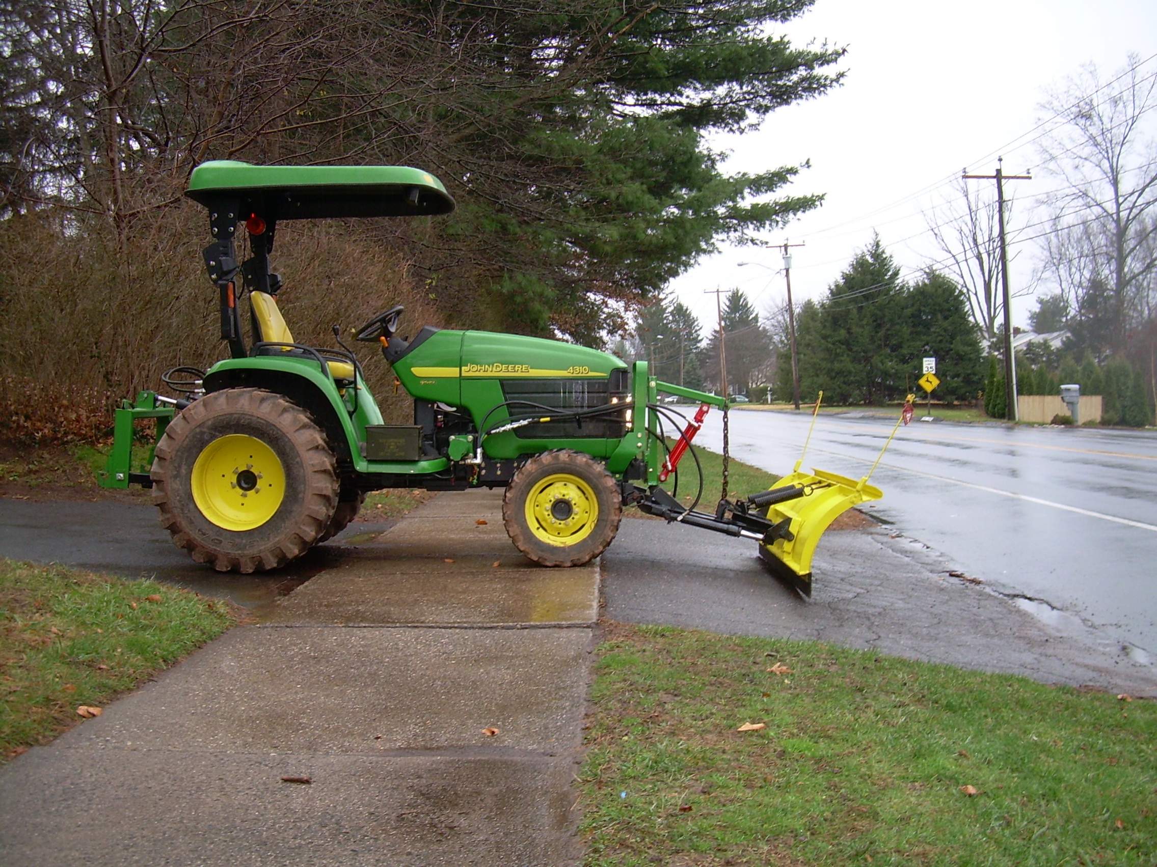

Looks great. Will look forward to pics of plowing. I think you will have a lot of fun with it, and get a lot of plow play done as well.
One thing I added, was a snowmobile helmet to handle the brutal cold blowing snow and wind in my face.
I don't have the rubber belting on the top edge, and may consider adding that as well.

Add a crossover relief valve and maybe some flow restrictors and that plow will be golden.

Trust Me That Rubber Western Deflector, Makes A World Of Difference!!!!
I will keep in mind that duck taping the hook, that cylinder i put on there was off of a newer western plow and I used it for the up and down, so the up is controlled by the tractor, however the down is run by the down pressure of the plow as far as the weight of the plow goes, I just leave my lever in "Float" Position......... Until I need to raise my plow to turn or whatever......
Maybe after this winter, I will change it over to a actual 2 fitting cylinder!!!!
We'll see how this season goes with what I got.....

Looks good, I know you were stressing out there for awhile trying to find a plow and figure out how to mount it, but in the end it all came together nicely, and just in time for the snow!
Those lines coming off the angle cylinders do look a little vulnerable, if your plow rides up high on a bank they could come in contact with some chunky junk.
Stacking stops were recommended to me for my frame mounted plow, to prevent the plow from rising to high on a bank and possibly hitting the cylinder. On mine it was needed, on yours it looks like it could raise up pretty high before it hit anything, so maybe not necessary.
The snow foil, I don't know if that's gonna make a difference on a slow moving tractor unless you get real deep powder snow falls, I've plowed for many years with trucks and rarely did I wish I had one.
I haven't got a chance to use my new plow yet so if I find I need to stop snow from coming over the top of the blade, I do have some thick rubber that I could install just like on yours.
About float, IMO you need that all the time, either by having enough slack in the chain or thru your valve. What you can do is drive around the areas you'll be plowing and drop the blade in any holes, ramps, aprons, etc to check if you have enough slack in your chain. I have a driveway apron that comes up from the street levels over a sidewalk and continues up the drive, I need a good 8 inches of float thru there to keep the plow on the ground.
