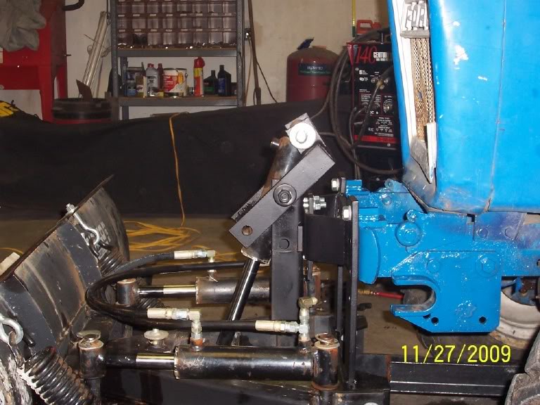

thanks a bunch everybody for your support, diamondpilot you were right, Well I did it!!!
Now I just need to test it out...... Come On Snow!!!!!!!
4310 I'M going to do what you said, drive to some of the places that I will be plowing...... to check for clearances.
thanks everybody!!!!!
I Love it so far!!!!!!!
I'm going to watch out for my hoses also!!!!!
   / Got Snow Plow Done For 3320 JD #22
This is what I was talking about, this area uses up all the available slack in the chain. with the way I have it set up, so it still has as much lift as possible.

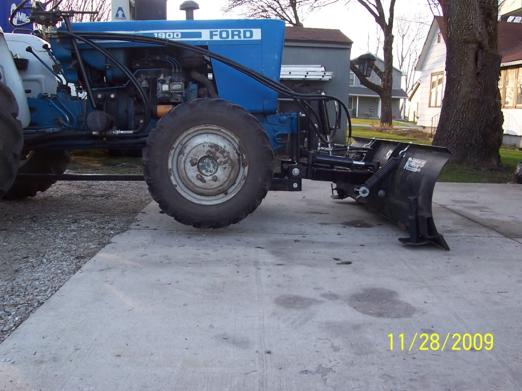

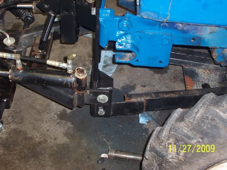

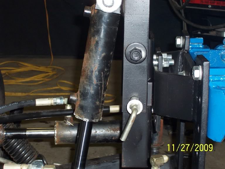

Brandon, I just put a frame mounted Kasco plow on the front of my tractor. It has a piece of 3"C channel 1/4 thick that goes from the bottom of the front mount to the drawbar mount and bolts there.This realy stiffens the bottom of the mount. The last to pics is how they mountd the cyl. With the pin removed the blade floats and with the pin in you have down pressure. This will give you some ideas if you put a double acting cyl. on.
