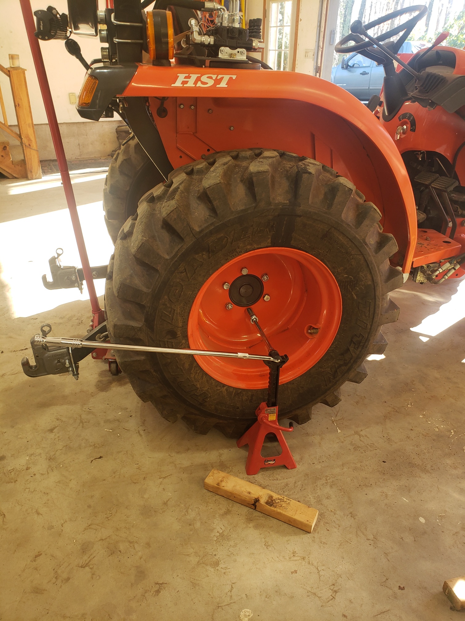

I like to use a jack stand or even a floor jack directly under the handle to hold the extension level and straight with the nut.
Put the handle a little above level on the side where it needs to go down.
Using the handle off my hi lift jack as an extension (36” ish long pipe)
I step up on the pipe and use the tractor to hold my balance and gently “bounce” the extension with my weight. A slow easy bounce rather than Hail Mary jump on it or you get to see broken tools laying on the floor along with your butt while you’re wondering what just happened!
Always works for me to break it free. If it didn’t, my next step involves heat.
That's a great idea Lennyzx11 !!! I was trying to keep it level with one hand while rotating my 30" extension with my other hand - not easy!

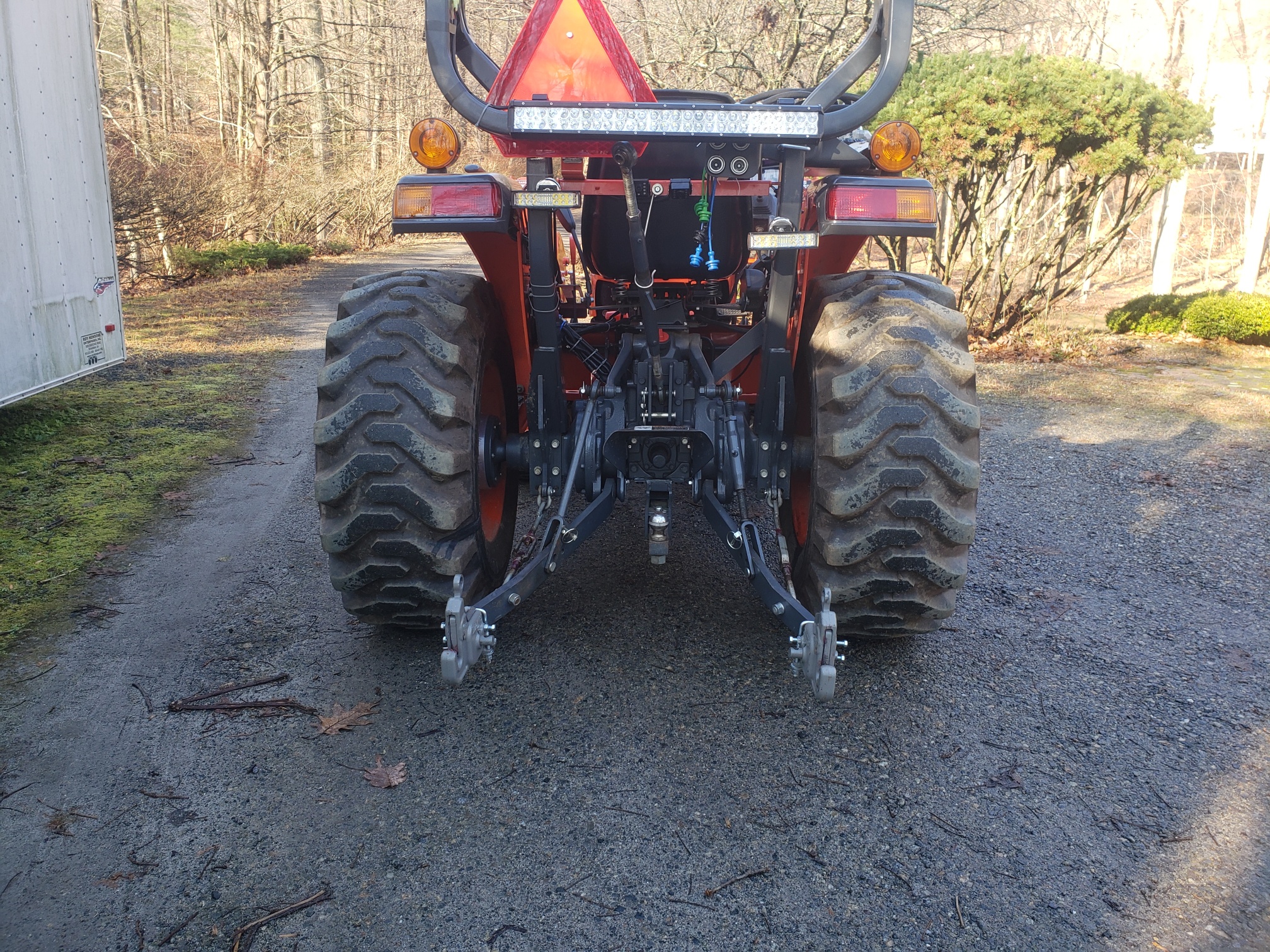

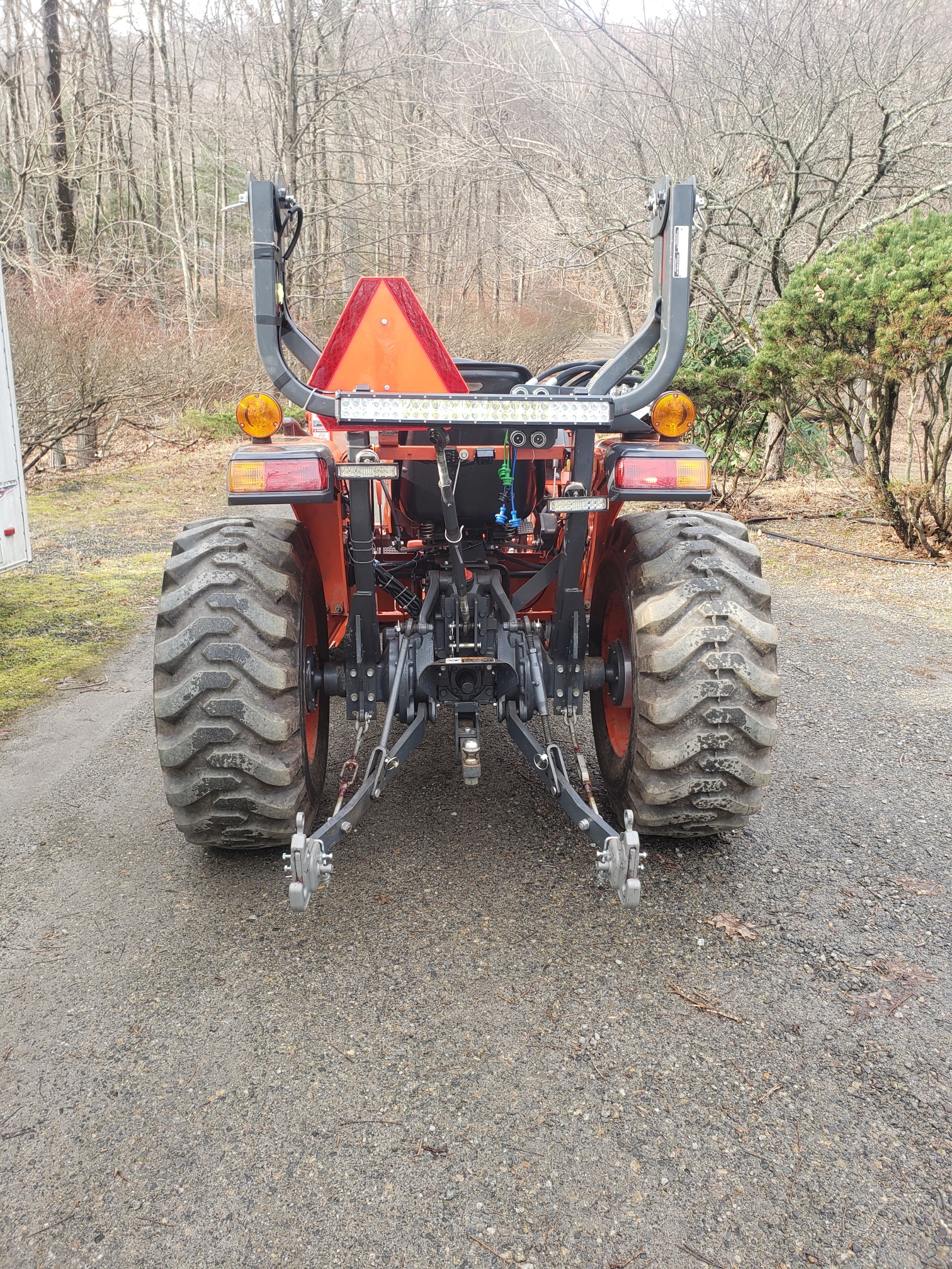

1st thanks again to Lennyzx11, the jack support under the wrench made is easy peasy both getting them off and torqueing them back on:
It took me 1/2 the time this AM, just an hour, compared to 2 hours yesterday for the 1st one.
Here is a pic before I put the second one on:
and with both on:

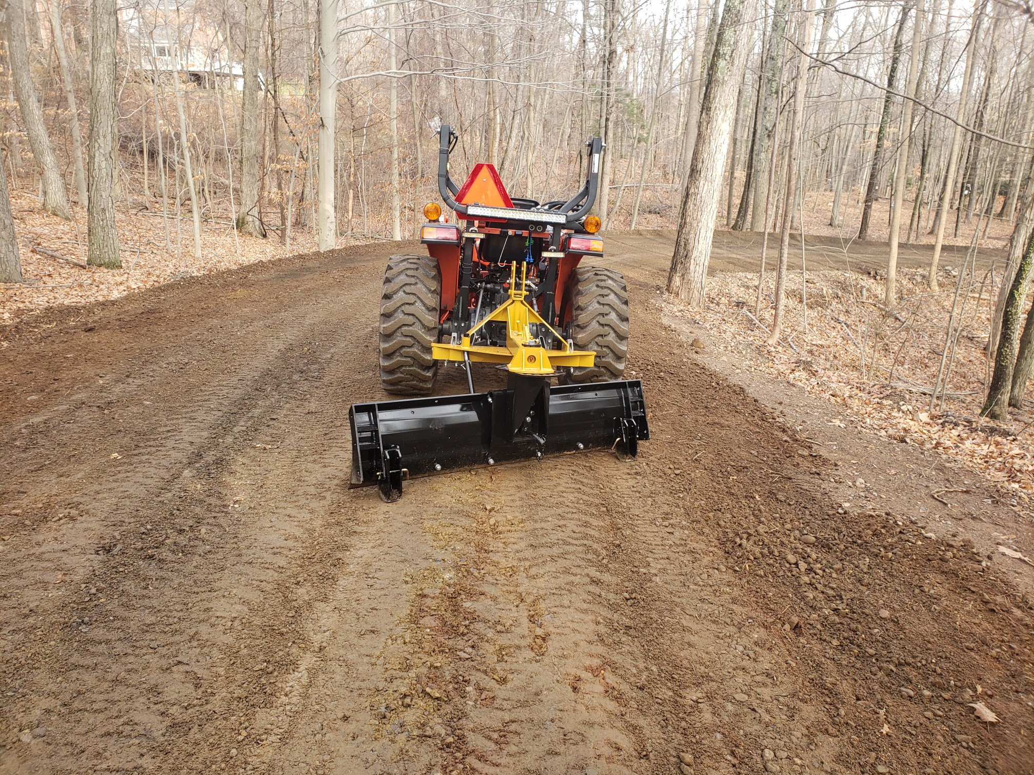

and then I couldn't resist doing some finish grading of the driveway. I just put on the shoes for the back blade and its been raining the last couple of days so the driveway is thawed.
I haven't tried it on any real grades - the grass is still too wet - but it feels different (could be a mind thing)
