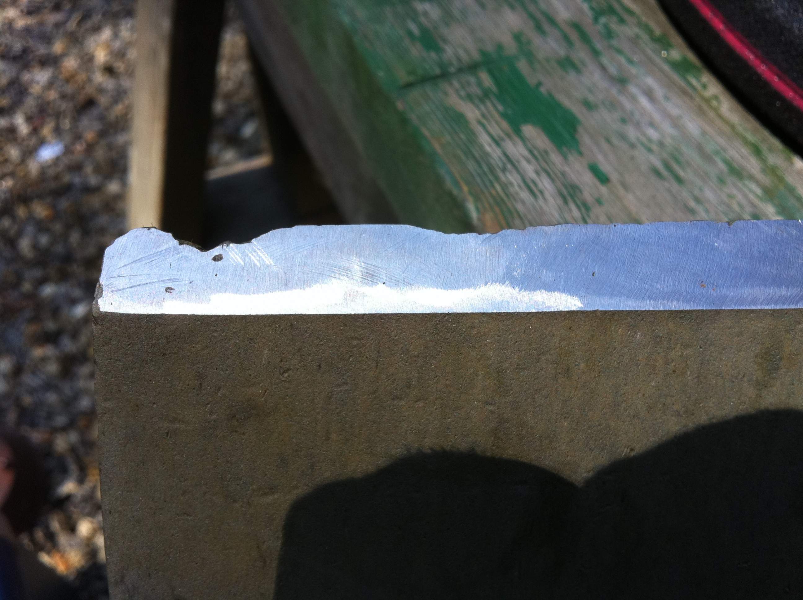

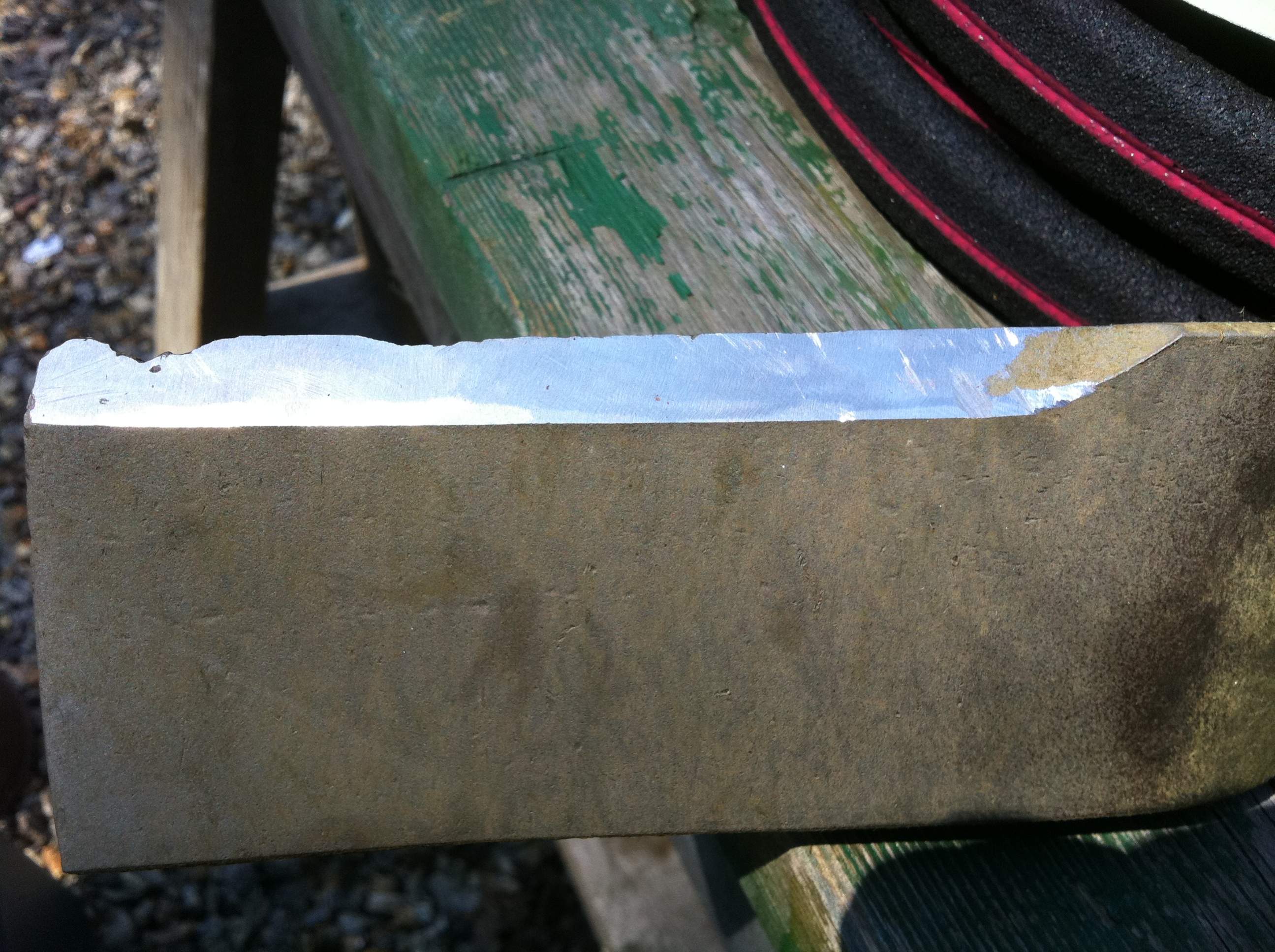

Struck a rock while mowing with my JD 2305 and 62C mower deck. Can I grind this out or should I replace it? I realize I'll have to even out the other side if I do grind it. Just seems like I have to take quite a bit off.
Sharpening blades is new to me but it seems easy enough for the other two blades on my deck that were not damaged.
I have an 4.5" angle grinder, a low speed bench grinder and some nice files so I have the tools. Just not sure if too much would have to come off.

i would just sharpen the gouge, it will cut.

Good grief, some of you would shutter to see my blades. Mine look worse than that after the first trip down my driveway. Sharpen it and forget it, it’ll cut just fine.

Do compare it to the "good" blades though to be sure you havn't bent the blade
otherwise sharpen it and go. you'll find as time goes on, mower blades end up with alot of dings like that, that can be sharpened out enough to do a decent job of mowing
Thanks, I did just that and its fine and not bent.

The blade only has to be reasonably sharp. Straight is a bonus, but sharpen the gouge and have at it.
They come from the factory straight because it is easier to make them straight than any other shape.

I wouldn't bother trying to grind away the blade until the
gouge is gone. Just sharpen around it, leave the ding, make
sure the blade is reasonably well balanced, and mow away.:thumbsup:

When wood chipper blades are taken in the sharpening place does not grind out all of the imperfections. You'd lose too much material.
Here is a suggestion that should get the safety police howling: I fill in the gap with weld and grind it back to the original. The tips get a bit of "soft" hard facing that can be worked (ground). It helps keep the shape longer.
We have very rocky soil here and the cost of replacement blades is prohibitive.

I would just run over it with a file and go.
I get my blades for a whopping $13 a piece. So, I replace my blades about June 1st every year and go. File down as needed.
Dull blades will turn green grass brown, especially if your grass is turf tough and thick.
