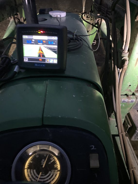

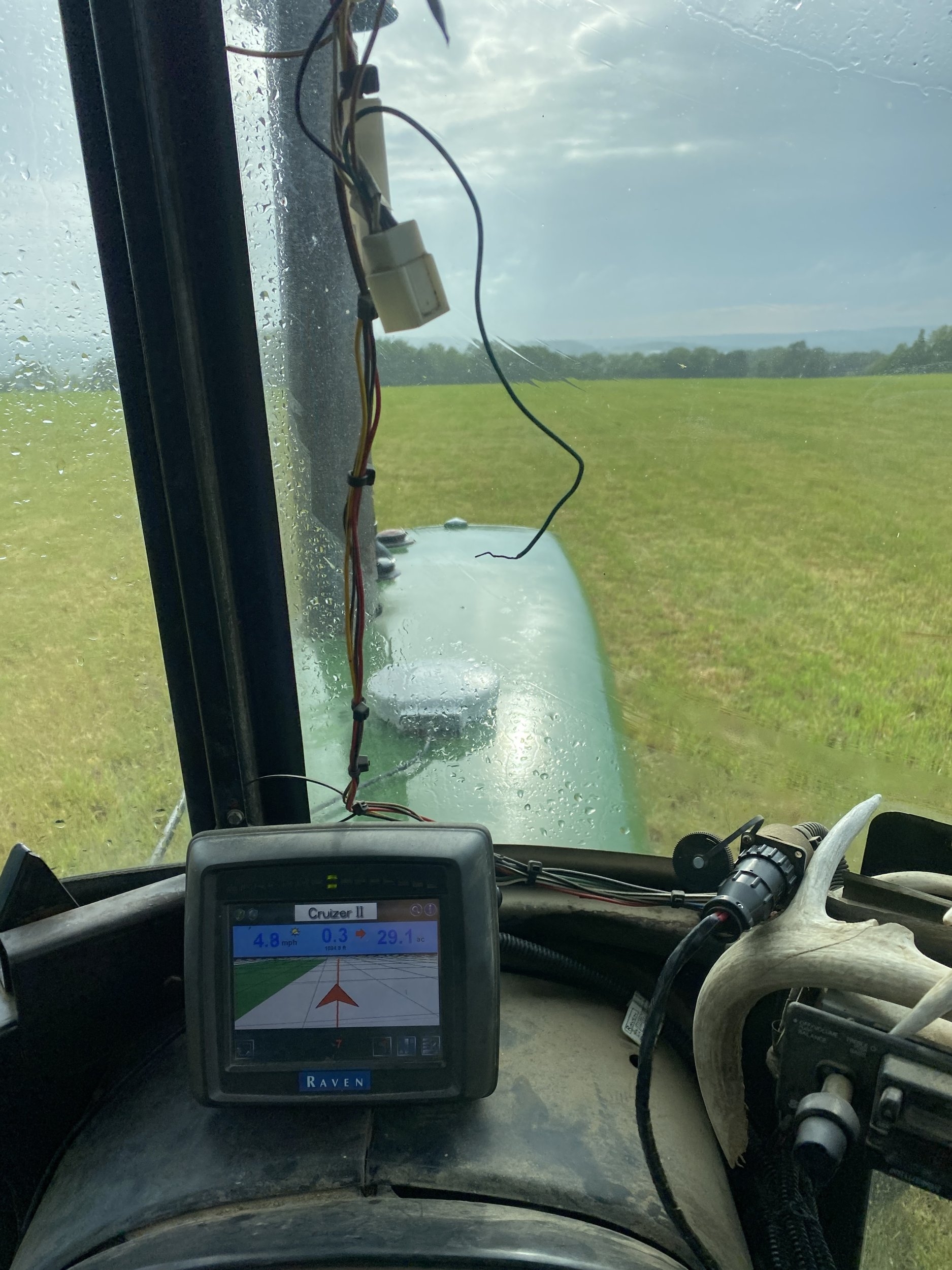

I use GPS. No subscription. 100% more accurate than not using it. Use it for spraying fertilizing some planting and for running cultimulchers on no till ground because you can’t see where you been. View attachment 871751
I will add that it does not compensate for side hills and even going over woodchuck holes makes it think your off. Go under trees and it loses signal then your lines are off. If using for planting I have to plan for that. Leaving the field to refill and come back 30 minutes later the lines have moved and need recalibrated. Those are some of the issues that buying the high tech systems take care of. What I can do now is relax while spreading or spraying. No more looking for wheel tracks questimating if I'm close. Spreader is a 40' spread width and sprayer is 30'. Sit back finger on steering wheel and just drive. Turn at the end and know you are right where you need to be. Also extends my day by working after dark.

Yep, I call it painting lines, and while it has many more features, painting lines is mostly what I use mine for.
