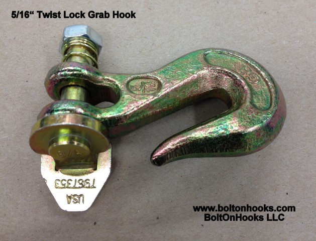

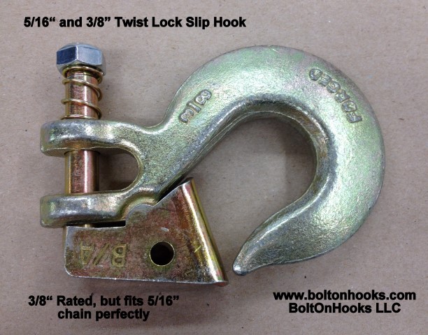

As already stated, Hook to Chain always with "grab" style hooks, with slip hooks you can get away with Hook to Hook.
Also, you might want to check out the new style "Twist-Lock" grab hooks we sell, guaranteed not to come apart!
Ken's Bolt on Grab Hooks <<Accessories>>
View attachment 394816 View attachment 394817
I saw these on the web and I like them. It's just that Ihave all my chains "hooked up". It seems the pin/spring/securing-device would be able to be added to old hooks, just replacing the pin.
