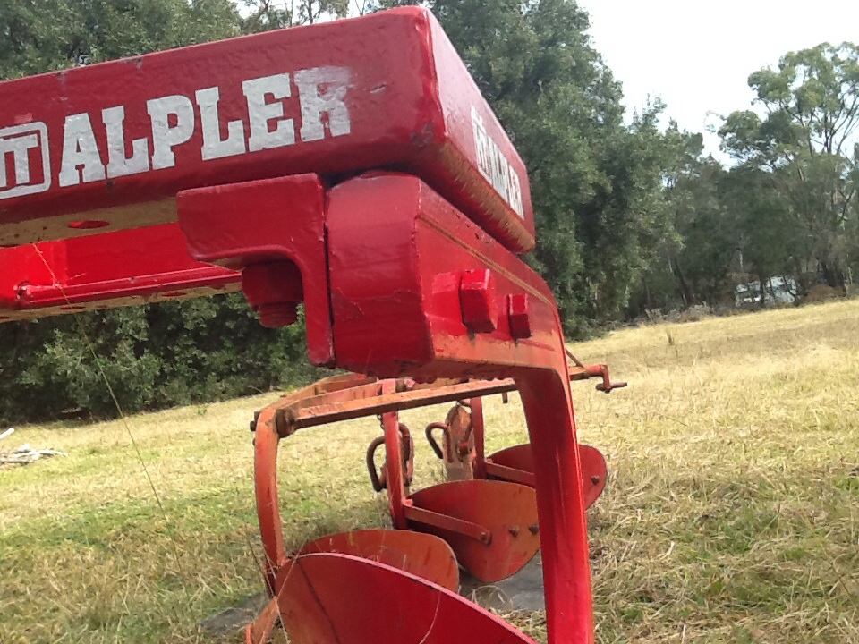

Yes overlapping below; using existing holes is better.
   / Grade of steel used for implements? #22
Yes, I am pretty happy with the robust construction. The limitation is that there are no shear bolts, which may be fine for frequently cultivated soil but a bit of risk for my use. My thinking, and the only option I can spot is to replace these two horizontal bolts with shear bolts.
Thanks, Gus
Shear bolts in those areas may case some frame twisting when one bolt breaks.
I'd suggest a layout where The plow arms are completely on the side with no framework above them.
I'd go with a welded on box tubing extension with fillets in the corners. Also add fillets to the three point arm extensions.
