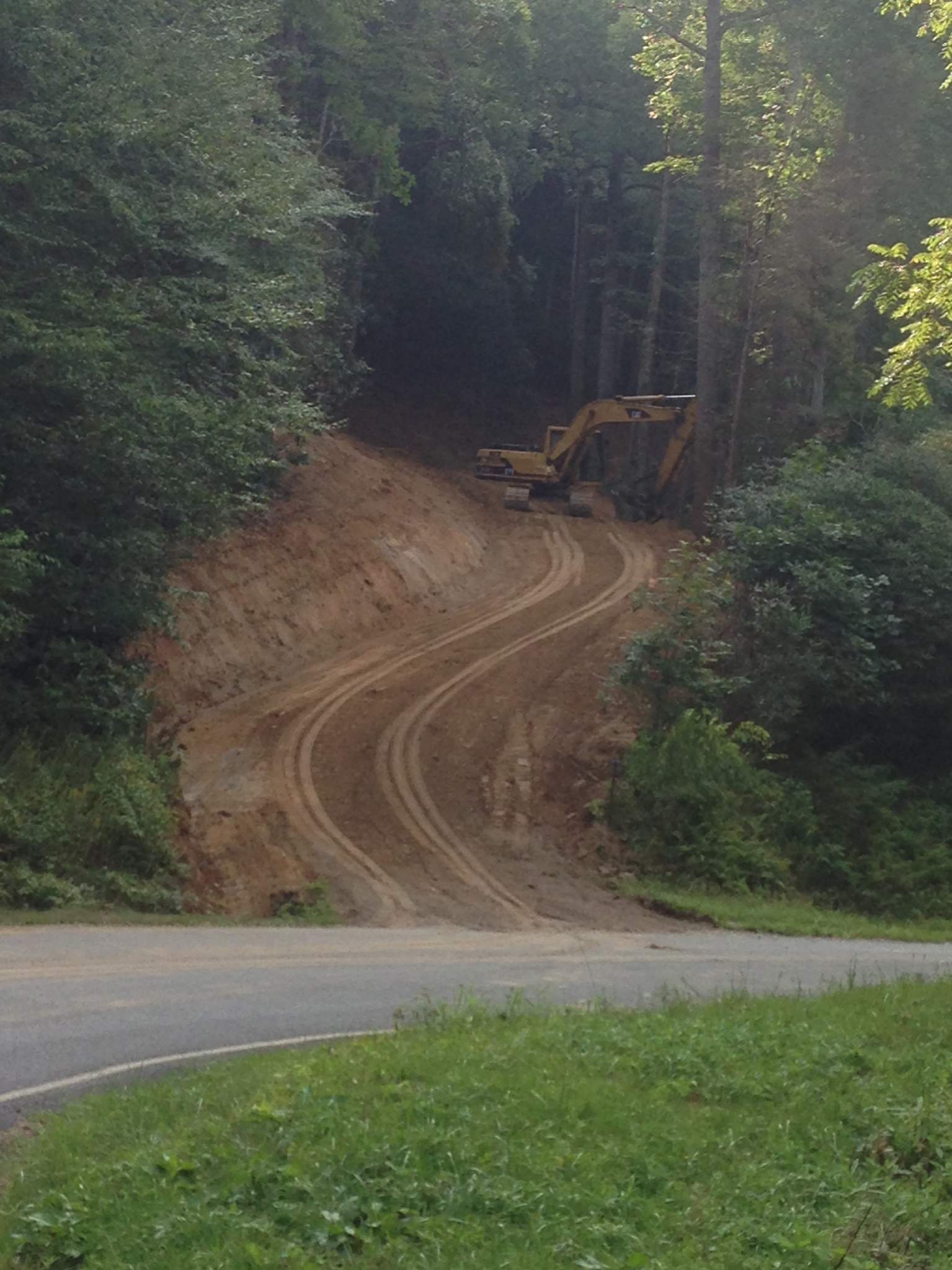

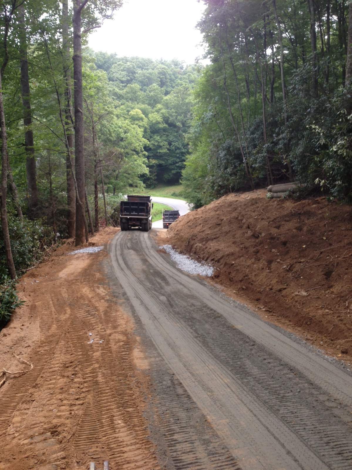

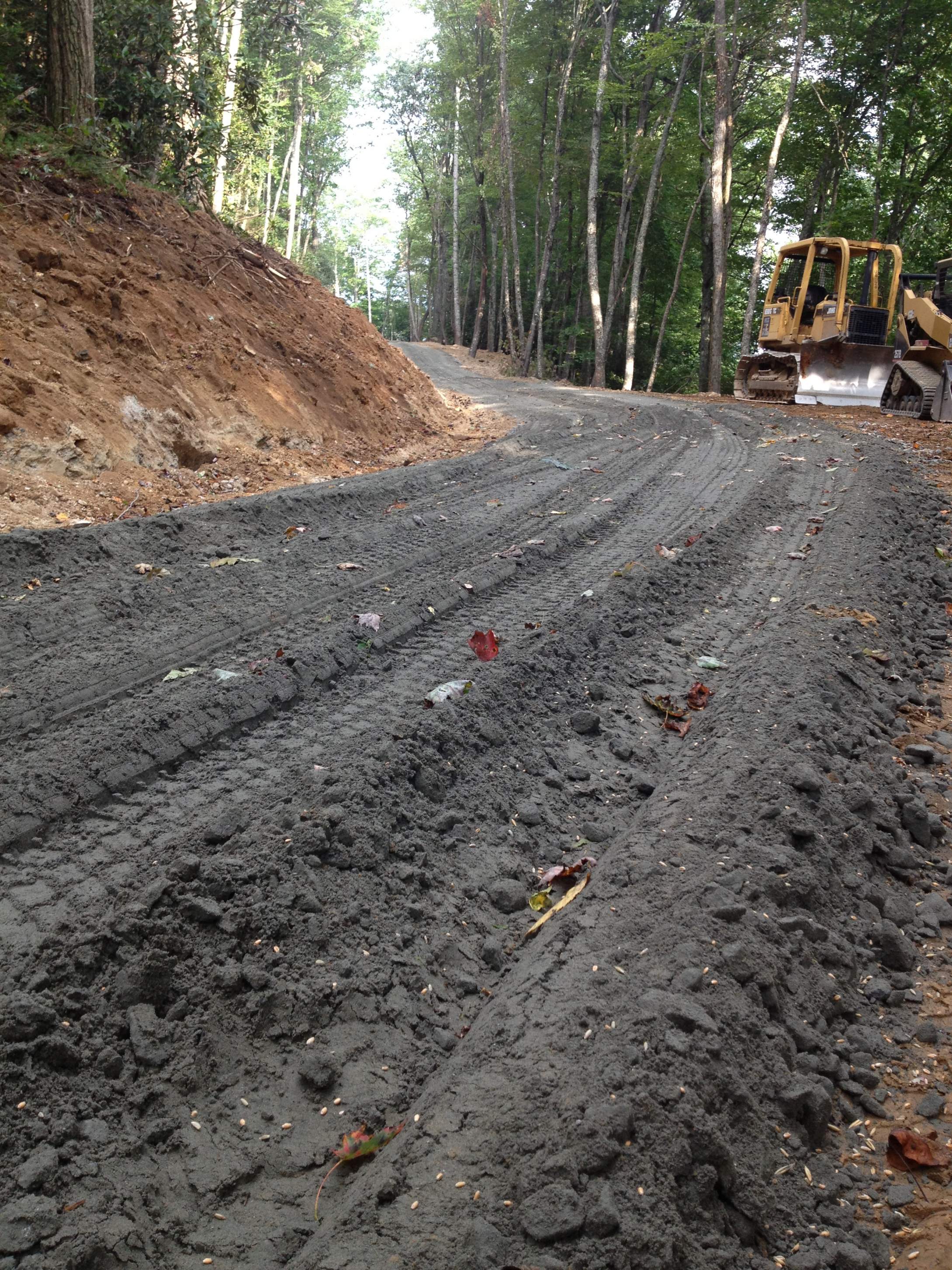

I am currently in the process of having some road work done to improve the 'pig trails' on our property. The roads are on property we have up in the mountains and due to the slope we are using a crown and water bars which are angled to the run of the road, to move the water off of the road. I'm looking for advise on the best implement to use to maintain these roads. The roads will be several miles long once we are finished.
I currently have a Bush Hog 70-06 rear blade. I have read most of the grader threads, box blade threads, etc. but I'm not sure I'll be able to get by with just a rear blade, but am concerned the graders will take too much off of the water bars. I would appreciate any and all thoughts and comments on the best attachment(s) to handle this job, as I don't really want to spend more time than I have to maintaining the roads.
Thanks in Advance!

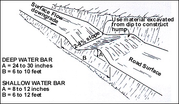

Pretty simple... if you've ever seen a long, graded gravel road... water tends to create rivers which continue to run down (gaining velocity to a certain point), causing ruts, washing sediment down, etc. Even my driveway with minimal slope (3' in 400') does this.
A water bar is a ridge of gravel on an angle to the drive, that when water hits it, it's forced off the driveway instead of continuing to run down it.
/ Grading A Road With Water Bars #11
Start at the top of the hill and work down, building as you go. A box blade works pretty good for making them. Open top culverts work better and are easier to maintain but are much more labor intensive to build.

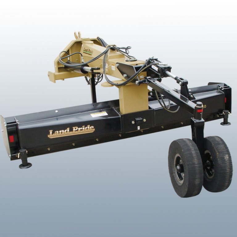

Thanks for all the great replies! That video contains some good info too! I do have mostly rolling dips, but had to use water bars in some of the steeper areas where we didn't have enough room to put in the dips. I have a feeling at a minimum, a TNT and grader is going to be on my priority list, although it sure would be nice to have one of those road graders :) Anyone using one of the Roadrunner Graders? They are about twice as heavy as the LP GS2584, and about 10% more expensive.

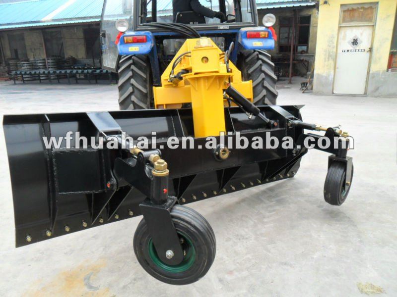

My first thought is for a rear blade with gauge wheel(s), and easy it over the bars without cutting. Never used one, though.
Center wheel(s) on frame:
or two wheels on the blade:
The Bush Hog blade parts manual shows several "tailwheels" that could be copied or bought.

Yes they are heavier than the Land Pride units. But if you look at a few others you will find several heavy units that are available.
GradeMaster Grader Blades
Home | Road Boss Grader I know that these typically run about 200lbs per foot width.
