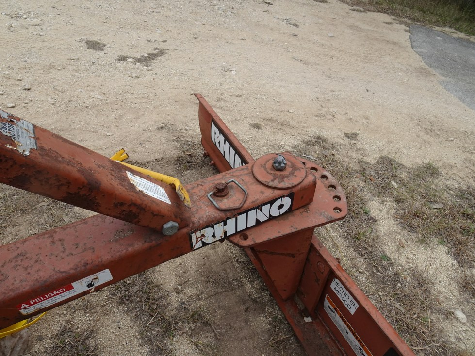

My blade is actually a Rhino, I was mixing up the box blade brand. It's a Rhino300 see pic, only 5 ft, I really should have gotten a 6 ft but this one was a good deal that included a landscape rake so I compromised. I have the manual for it and it has a landscape rake option but the one I bought isn't that, it's a full implement. The manual has no weights but their current 5ft low end blade is only 280lb and it looks pretty similar. I've only got about 200 ft of drive to deal with and the ground is hard enough that it doesn't get too bad too quickly.

that the same type of blade I was using ... and I used the 3 point arm level adjustment to make the crown grade and also help to scape off material ... if you could think of something to drag in order to makes yourself some loose or like many mentioned just adding some weight on it and eventually you will get some loose...
