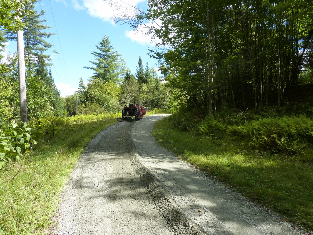

Grading--what am I doing to cause this?

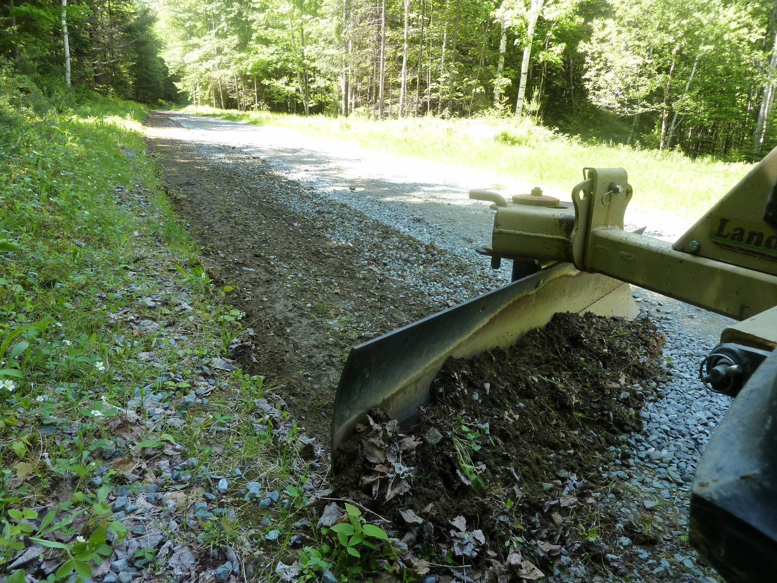

You can also utilize the float feature on your bucket to smooth after you have graded. Pretty sure your tractor has this feature and you use the tilt on your bucket to drag the heal a little or tip it down to cut flat.
The above suggestions are all valid, go slow, add some weight, be sure to crown, don't be afraid to adjust your angles, both on the blade and the 3 point and top link. Adjusting the top link longer will give more cut, shorter will be more plow or bulldozer type, so depending on how much you need to dig will determine what is needed.
Just from the small picture, I would guess not much is needed, like deep potholes, so the top link should be shorter so you don't get as much dig, and when crowning, be sure not to lower your blade all the way. That will bring more of the side media towards the center of the road, and will reduce that lump between runs

Slower, also adjust top link (longer) to change the angle of attack....which you will need to adjust the tilt of the blade as well after the top is moved.

My opinion: slow down, put weight on your blade (several cement blocks, wired on), angle >30 degrees. As mentioned in several posts, the rocks are making the ripples occur. The other thing you mentioned was digging in. That might be that your tractor is "falling" into a slight dip that you cannot so easily see, and then the blade is inherently lowered. Hope this helps

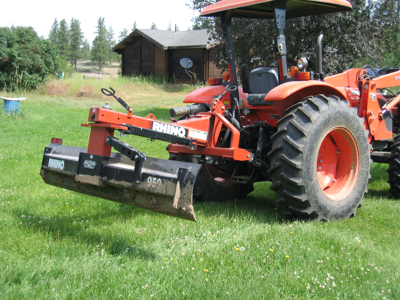

Yee Gods - and I thought my "mixer" was unique. LD1 is correct. The horseshoe thing - it's a stand-off to hold hydraulic hoses. If I would have opted for the hydraulic version. My Rhino is 100% manual. There is another one - at the front end.
You can see them both in this shot. View attachment 725320
It's always important to try to see things from different pespectives. I'm sticking with levitating horseshoe, it's a lot more interesting.

It's a typical owners manual tube.
LOTS of newer equipment (pretty much anything in the last 20 years) has or had one
Most of my stuff is used so I guess it's very used. Not really though, 20 years isn't all that long for solid well-built stuff.

In my experience I've learned to use the front of the blade to cut and pull towards the center for a crown then for a finish grade turn the blade around backwards for a final smoother Floating grade. All grading is at a 30-45% angle. I do cut the washboards out then spread the dirt back out. Weight is key, my rhino weighs in at almost 1000#. Cutting is done slow, 5-8 mph while finish floating can be faster. I do not use a box blade. If you have rear remotes a hydraulic top link helps a lot. Practice makes perfect.
I've never tried the blade backwards, others have mentioned it and it's a simple obvious thing I should have thought of. Turning the blade around I have done but for going backwards. 'Floating', does that mean you have a hydraulic top link in float?

Try a land plane. Two blades are better than one! Notice they are angled for a reason. Angling the box blade will help if a land plane is not an option.

For a proper solution rip/scarify the entire surface of the road to break up the hard pan. Then angle the back blade. Have it tilted slightly backward and up at the trailing edge and then roll a windrow of material back and forth across the road till it’s smooth And the windrow gets spread out. Then pack it if possible. Gage wheels allow you to do this.

I agree with the weight aspect, add some boards on top & stack blocks, rocks, steel, etc. The other thing I haven't seen yet (maybe I missed it), is dropping the back of the box grader (Use the top adjuster on your 3ph) so you are Not digging in but just "smashing"/finishing the ground with the rear blade (assuming you have a double blade in the back - one for cutting forward and one for cutting in reverse). I'm sure I'm not using the correct terminology, but hopefully you can figure it out - been a really long night 😅🤣😂.
   / Grading--what am I doing to cause this? #72
A three point hitch on most tractors does not typically have power down. You can lift the hitch arms with one hand when they are in any lower position. Thus, anytime they hit an imbedded rock, or even a hard root, the blade pops up over it.
The only way that grading a HARD surface with rocks gives you a smooth surface free of these ripples is if you have really heavy blade (like on a grader) that will either shear rocks or pull them out. This leaves a very smooth appearing surface with small pits where the rocks came out.
But that's impractical for most of us with tractor blades of whatever kind. So, our key to smooth roads is loose material spread evenly. You do this, as indicated above by adding weight... lots of it, and by pulling material to the center then coming back and respreading. This will maintain your crown and give you loose material which will grade evenly without the skipping. You need to both tilt and slope your blade... have it 1" lower on the outside for every 8' of blade (not sure how wide your blade is and 1" might be too tilted for a 5' blade) and tilted back to the inside. And add as much weight as you can. After you have loose material windrowed in the center, go back and spread it with a straight blade. The slope you created earlier should now remain the same as you spread the loose material with a straight blade.

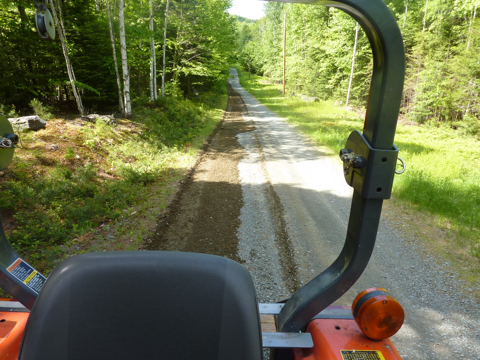

I don't have a lot of experience doing this basic task. See the photo, I've used both a blade and box blade and keep getting these ripples and have no clue why. I've tried it with the lift arm float mechanism in and out and the slow-return lift adjustment loose and nearly off and nothing gets rid of the ripple. The tractor is a Branson 3520 and it doesn't have draft control, not sure if that would help. I'm in cenral Texas hill country, v hard ground, very rocky, I usually try to do any grading when the road is just a bit wet. Anyone have any ideas? Is it something obvious and I'm just too much a noob? Thanks for any suggestions.
You need a grader, not a box blade. Also in Tx Hill Country. Box blades make hills/valleys worse. They dig as you climb and dump at the top of the hill. The more you use it, the worse it gets.
The ripples are explained by the other posts.
Yep, been mentioned and theyu're the first two things I'm going to try when the conditions are right. I realy like the box blade angling thing, I can see how that would do really well. I have these short very large Ibeams that weigh over 200 lbs that would be fairly easy to throw on the box blade, a little trickier on the blade but I think I'm gonna try that for initial attempt. I often use 50 gal barrels filled wiith water for weight but that needs a good place for them and not so likely a bumpy ride.
Yeah, that's a positive feedback kind of thing it's hard to get around. I don't have but wouldn't draft control help with that?

Angle the blade harder by bringing the left side farther forward. Then play with the top link angle to get it to cut like you want, and the side elevation to get your crown.
Even a road grader will cause ripples if you repeatedly run the same angle over a road, or at least they did when I ran them. I will guarantee that there is more down pressure than you will get out of a cinder block. You will never get compaction using a lawn roller that amounts to anything. You are better off getting into the argument with the wife about getting off the throttle in the driveway for a couple weeks and use the tractor as a rubber tire roller.
You dont have to go crazy if you are just taking out the crown and/or pulling the edges in. I do it every year pre snow season to get something more level to work with. I only do it when it rains because if you do it dry, the fines in the stone will fall out. If it is wet, they will stick to the heavies better. Cut the crown, roll the outsides to the middle, then roll them back out leaving winrows on the sides, then back blade the winrows on the sides towards the middle.
AHA! That's what it has to be, kinda obvious, but I just didn't see it. I wasn't ready to throw Euclid under the bus, that seldom works out well.

This is why I don't like box blades, although considering where you are that actually doesn't look too bad. If you really want to get that road smooth maybe see if you can borrow a neighbors land plane. That'll do a far better job.
Yes the land plane. Built to groom driveways and dirt arenas. So easy to use and great results. I sold mine when I didn't have road to maintain any longer. Will get another if my situation changes.
