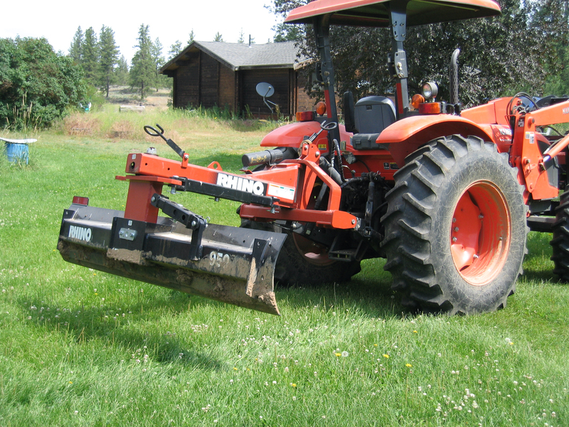

Exactly - bcp. This is the way my M6040 is set up. Grapple on the FEL, RimGuard in the rear tires, Rhino 950 on the 3-point. Total weight - 10,100#.

Very nice. Pardon my ignorance but on your blade, what is the thermos looking thing and what looks like a horse shoe on a cylinder having a gravity anomaly?

I think that is oosik's cocktail mixer. You put some ice and your favorite libation in there. By the time you get done smoothing out your road, voila, refreshing cold cocktails!

It's a typical owners manual tube.
LOTS of newer equipment (pretty much anything in the last 20 years) has or had one

Yee Gods - and I thought my "mixer" was unique. LD1 is correct. The horseshoe thing - it's a stand-off to hold hydraulic hoses. If I would have opted for the hydraulic version. My Rhino is 100% manual. There is another one - at the front end.
You can see them both in this shot.
