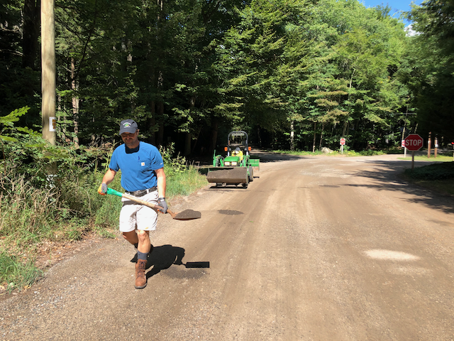

I don't have a lot of experience doing this basic task. See the photo, I've used both a blade and box blade and keep getting these ripples and have no clue why. I've tried it with the lift arm float mechanism in and out and the slow-return lift adjustment loose and nearly off and nothing gets rid of the ripple. The tractor is a Branson 3520 and it doesn't have draft control, not sure if that would help. I'm in cenral Texas hill country, v hard ground, very rocky, I usually try to do any grading when the road is just a bit wet. Anyone have any ideas? Is it something obvious and I'm just too much a noob? Thanks for any suggestions.
You need a grader, not a box blade. Also in Tx Hill Country. Box blades make hills/valleys worse. They dig as you climb and dump at the top of the hill. The more you use it, the worse it gets.
The ripples are explained by the other posts.

I agree with the weight aspect, add some boards on top & stack blocks, rocks, steel, etc. The other thing I haven't seen yet (maybe I missed it), is dropping the back of the box grader (Use the top adjuster on your 3ph) so you are Not digging in but just "smashing"/finishing the ground with the rear blade (assuming you have a double blade in the back - one for cutting forward and one for cutting in reverse). I'm sure I'm not using the correct terminology, but hopefully you can figure it out - been a really long night 😅🤣😂.
Yep, been mentioned and theyu're the first two things I'm going to try when the conditions are right. I realy like the box blade angling thing, I can see how that would do really well. I have these short very large Ibeams that weigh over 200 lbs that would be fairly easy to throw on the box blade, a little trickier on the blade but I think I'm gonna try that for initial attempt. I often use 50 gal barrels filled wiith water for weight but that needs a good place for them and not so likely a bumpy ride.

Angle the blade harder by bringing the left side farther forward. Then play with the top link angle to get it to cut like you want, and the side elevation to get your crown.
Even a road grader will cause ripples if you repeatedly run the same angle over a road, or at least they did when I ran them. I will guarantee that there is more down pressure than you will get out of a cinder block. You will never get compaction using a lawn roller that amounts to anything. You are better off getting into the argument with the wife about getting off the throttle in the driveway for a couple weeks and use the tractor as a rubber tire roller.
You dont have to go crazy if you are just taking out the crown and/or pulling the edges in. I do it every year pre snow season to get something more level to work with. I only do it when it rains because if you do it dry, the fines in the stone will fall out. If it is wet, they will stick to the heavies better. Cut the crown, roll the outsides to the middle, then roll them back out leaving winrows on the sides, then back blade the winrows on the sides towards the middle.
