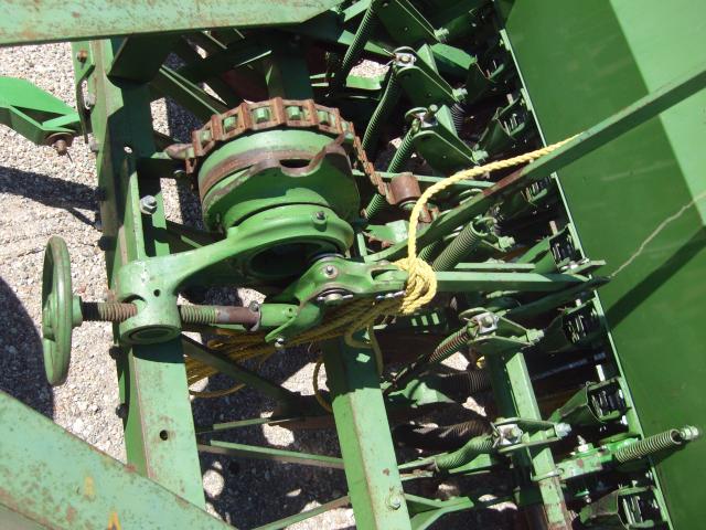

Well - I bought it. Everything works exceptionally well. I ordered an Operators Manual and Parts List for it from the John Deere website. I can't wait to use it. But first, I'm gonna oil and gease everything.
Only issue is I can't turn the wheel (see picture) that changes the cutting depth. It's stuck good. I'm gonna try heating it and using penetrating oil to lossen the threads. I don't think it's a big problem.
Thanks for all the help.

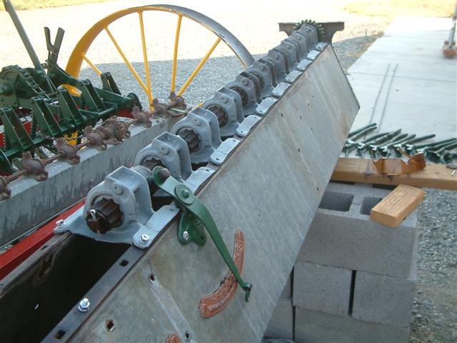

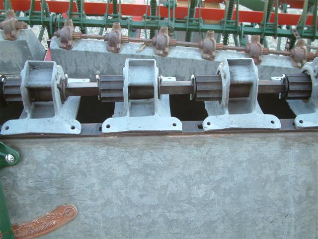

Here are a few photos of that Minneapolis Moline P3-6 drill I restored several years ago (10-ft wide, 20 hoes, single disc openers, grass seed boxes included).
I used cold galvanize spray paint on the fertilizer box to prevent rust.
Used the cold galvanize paint on the seed cups and used Gempler's rust converter on the flute feeds.
Have fun with your new drill.
If it was me, I'd spray it down, try to turn it, spray, try, etc. Might not operate unless the boots are down, IDK. Don't get in a hurry with the hot wrench. All of the drills I've worked on, needed TLC in the depth adjustment department. Patience and PB Blaster won out. Mark
I sprayed it down with Liquid Wrench and let it soak overnight. Turned easily the next morning.
I greased every zert fitting I could find and was amazed that grease was observed at every fitting immediately indicating it had been very well maintained.
