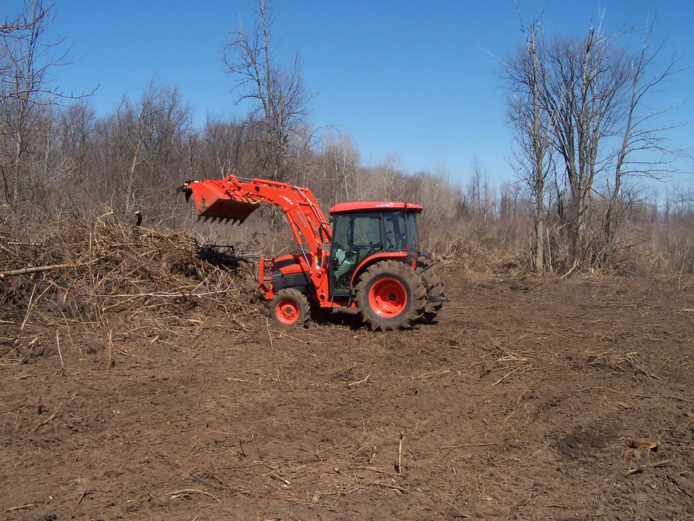

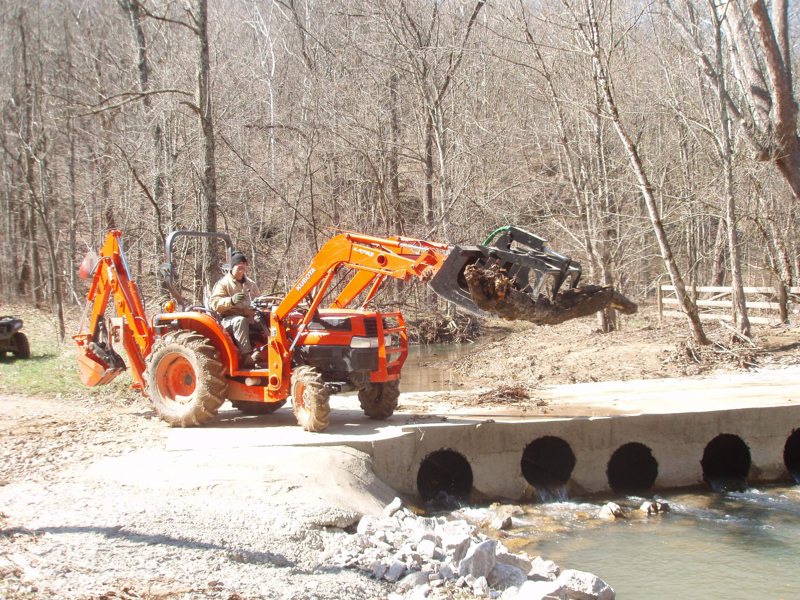

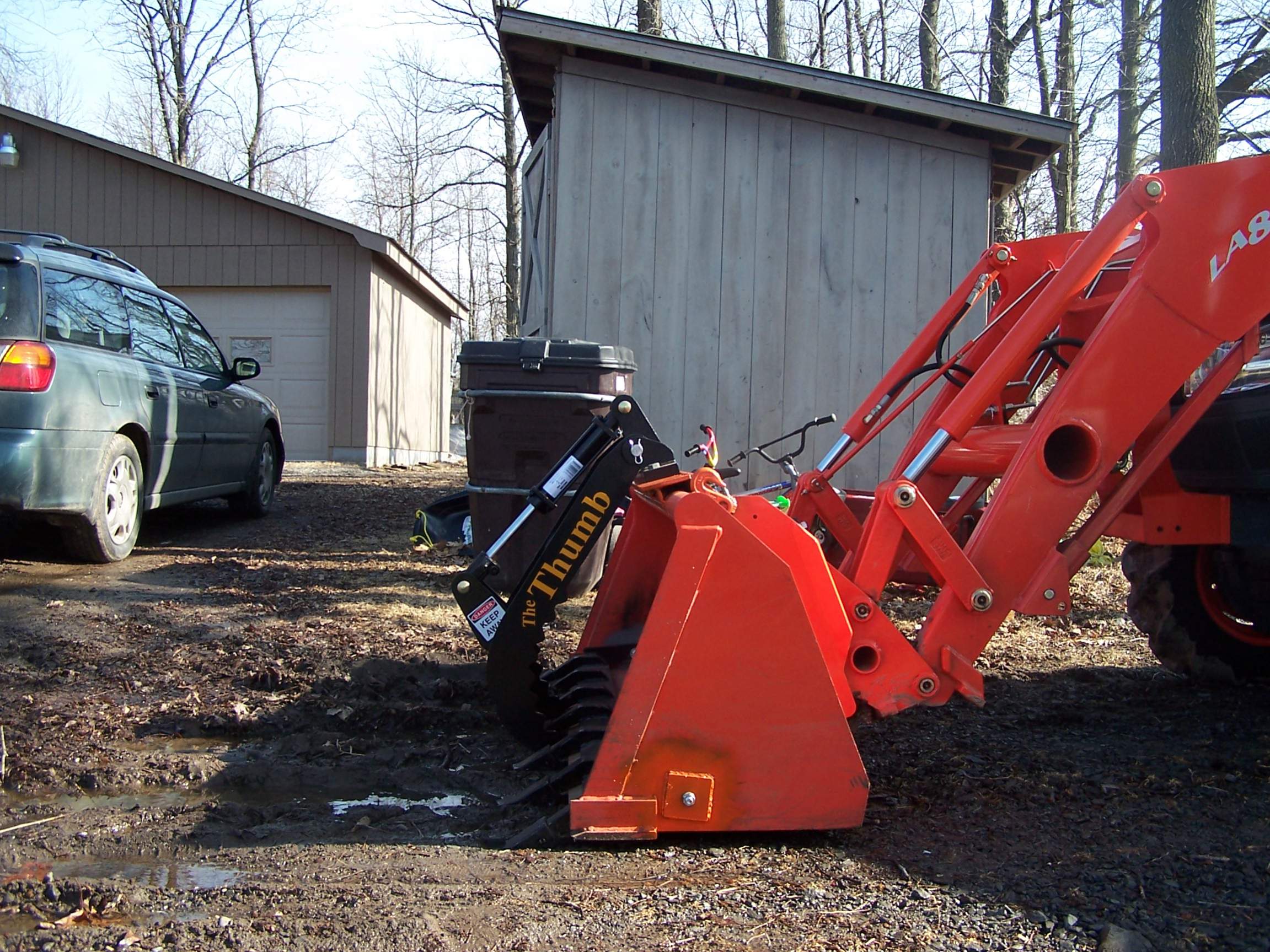

Great pics! How much does your grapple weigh? I don't think I would ever need to lift anything more than what you are lifting in that picture :thumbsup:
I stuck with a 66" grapple to save weight, and I believe that it is around 680#. So far I haven't latched on to anything I couldn't move. I too have my rears ballast with Rimguard. That helps a ton. Well actually 1298# not a ton. :laughing:
